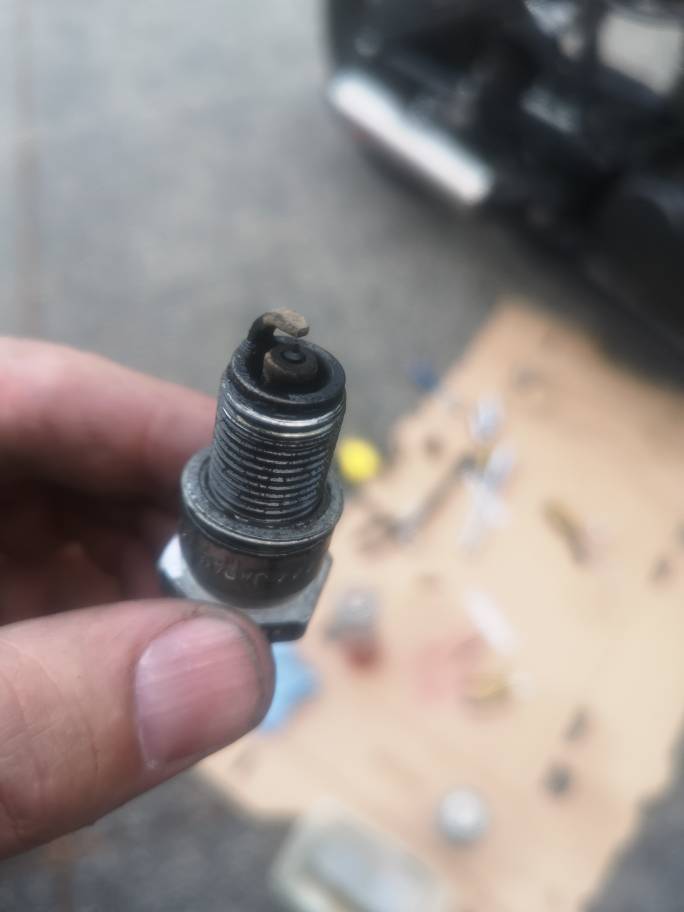

Here is my current jetting, both FCR's came of an 06 RMZ450 may still be slightly rich, but runs pretty damn good.
main-148
pilot-40
leak jet -70
needle-EMF (clip #3 position)
mixture screw-2 turns
