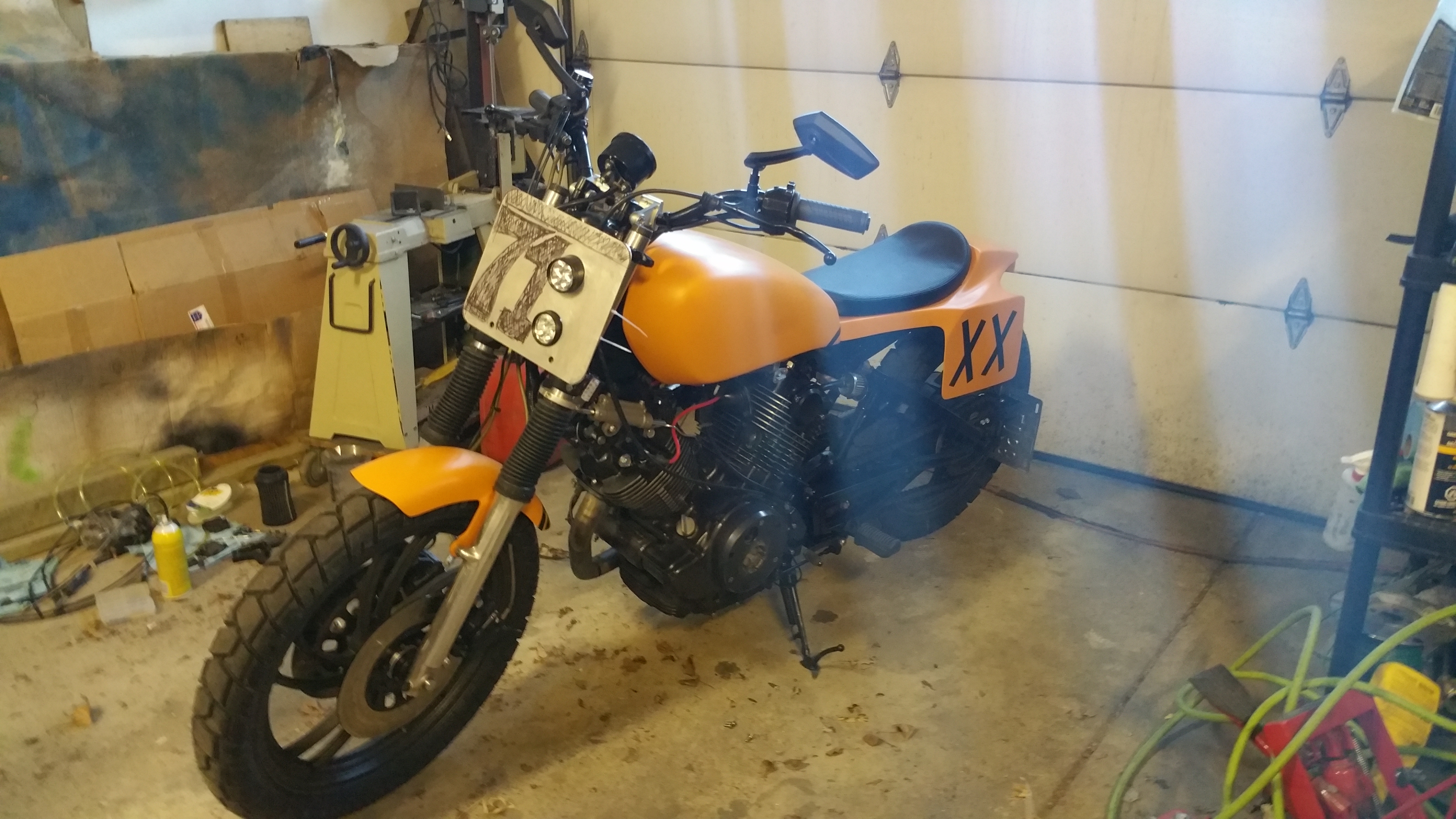

Order graphics and number plates decal, and redoing the front number plate. I think I got the dimensions wrong when I made it originally as it never sat well with me. It will be wider and shorter slightly.

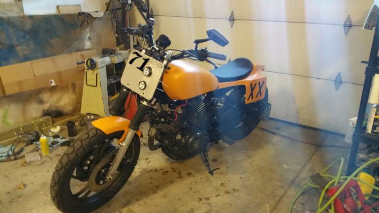

Well I tried various templates for the front number plate part deux and settled on this. It's more pleasing.

In the mean time I FINALLY settled on how to make the front number plate look right.
Just not sure what to do with the front number plate graphics. If I squish the numbers then there is a gap on the right side of the lights that looks weird to me. The other option is to make the second number cut into the headlights themselves. Any ideas are appreciated.

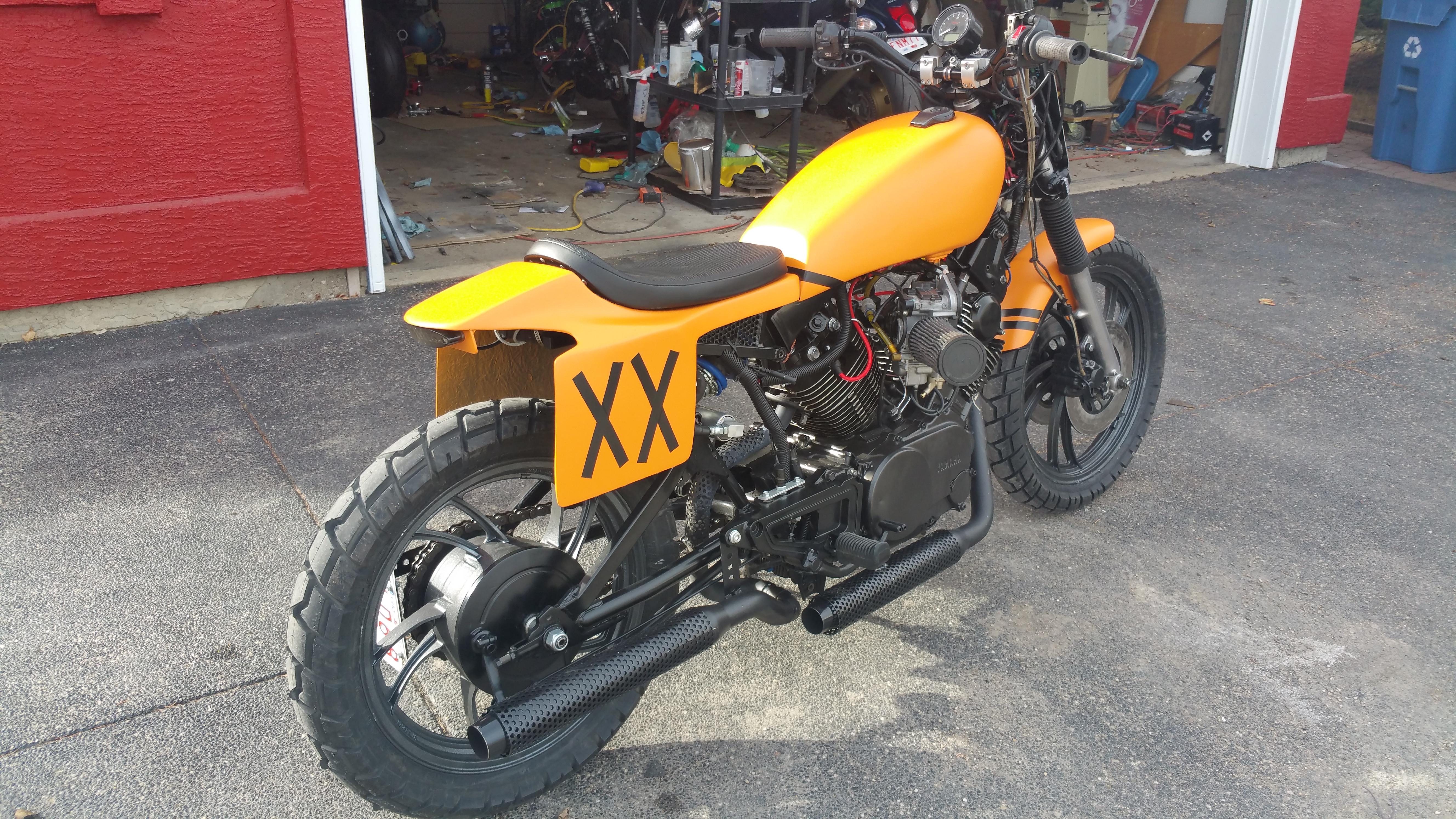

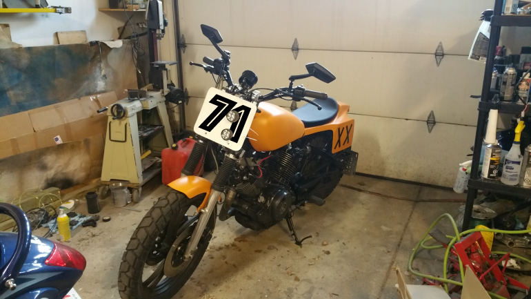

Also I have the new tank and tail graphics! :)

What about one of these options?
Oh I like the first one. Tell you what I will make a white plate tonight and post it so it's easier to photoshop. The number doesn't have to be 71. I thought the 1 might be the best digit that's identifiable through the lights but after seeing your rendering I think it's worth testing others.
