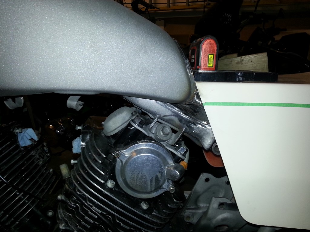

Everything is level! 8)

Cleaned up the tank which will also double as a mount.

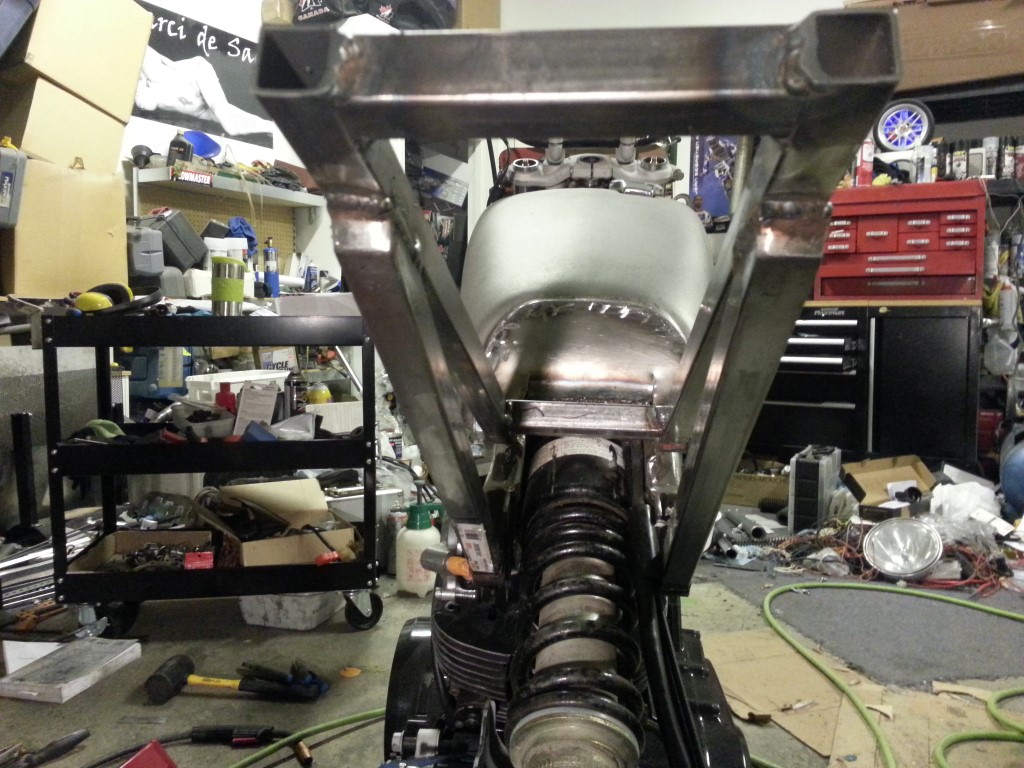

The hardest part of the subframe done. Getting the first frame tabs welded for the two poles and being true and level. This is why the measuring is so important. So the last pic the level is nice and green and the front of the seat is nice and flush t the tank. :-)

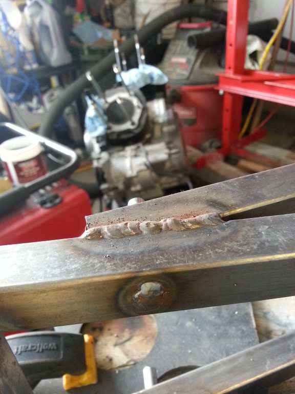

Frame welds all reinforced and now blended. I also reinforced the shock mount in the frame. Between the two bikes. 6 hours of weld blending.
Cree headlights finally arrived. Sub frame all square an stage one built. In my first attempt at the sub frame i was 2mm off so I cut and redid the welding to make it 100% square.

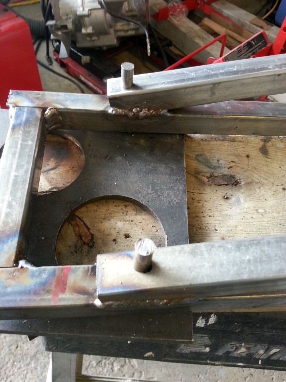

Ok so this sub frame is a little different than my last so I had to re-enforce it differently. Plus the lower beam angle is less steep so another reason to re-enforce it.
I drilled a whole through both beams. slid solid rod through it. Welded the tops and bottoms, then hid the welds. I also from the back opening I also welded the rod to all the walls inside, then proceeded to fill the holes with solid welds. Then I I again hid the welds and made a nice transition.
