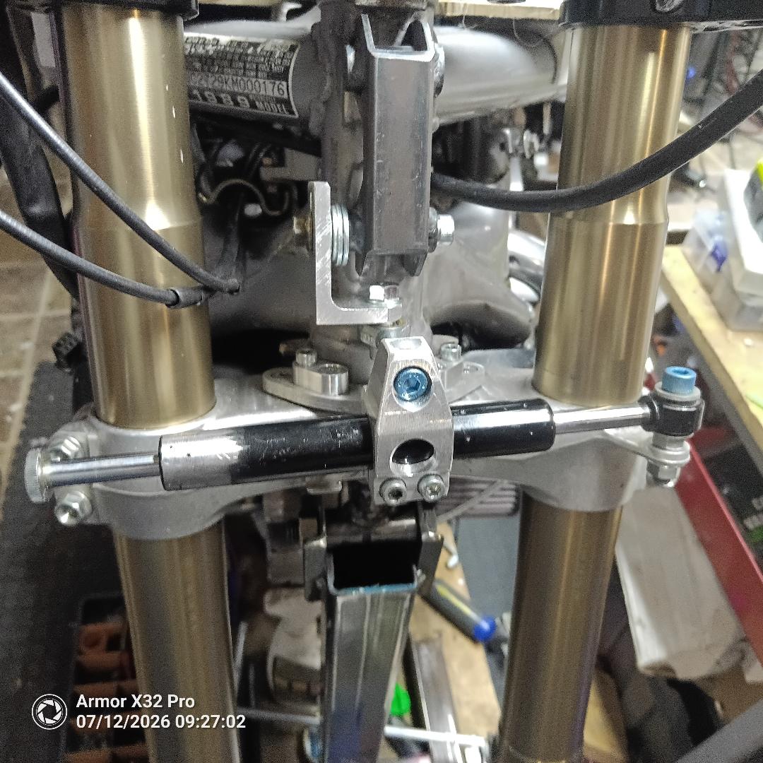

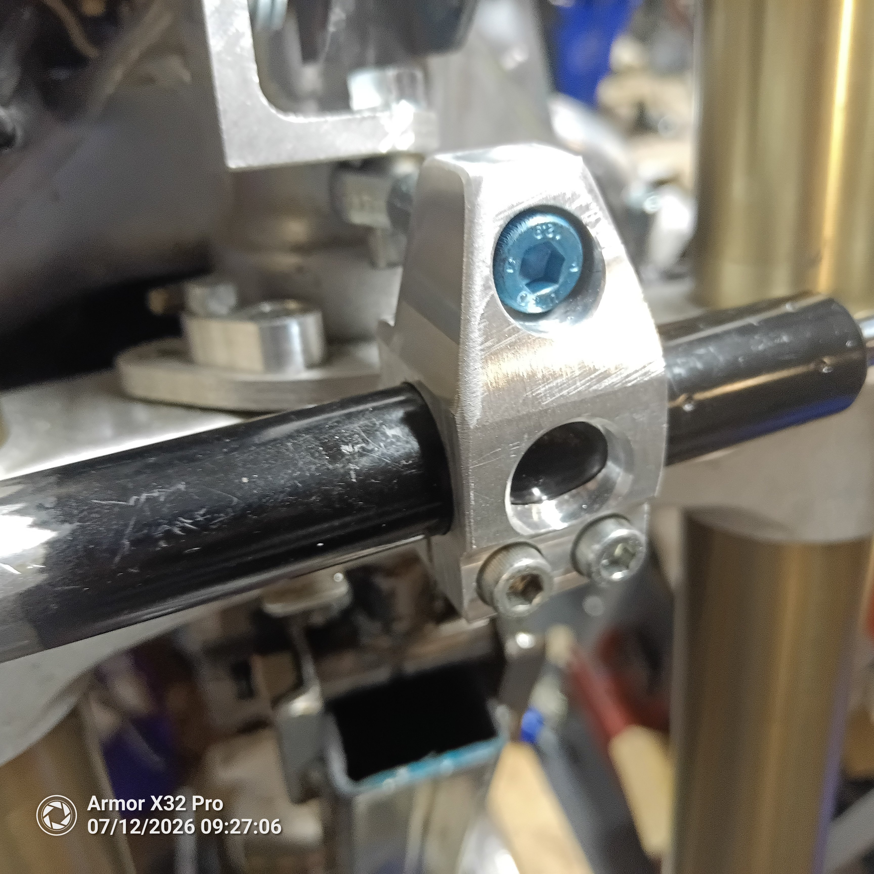

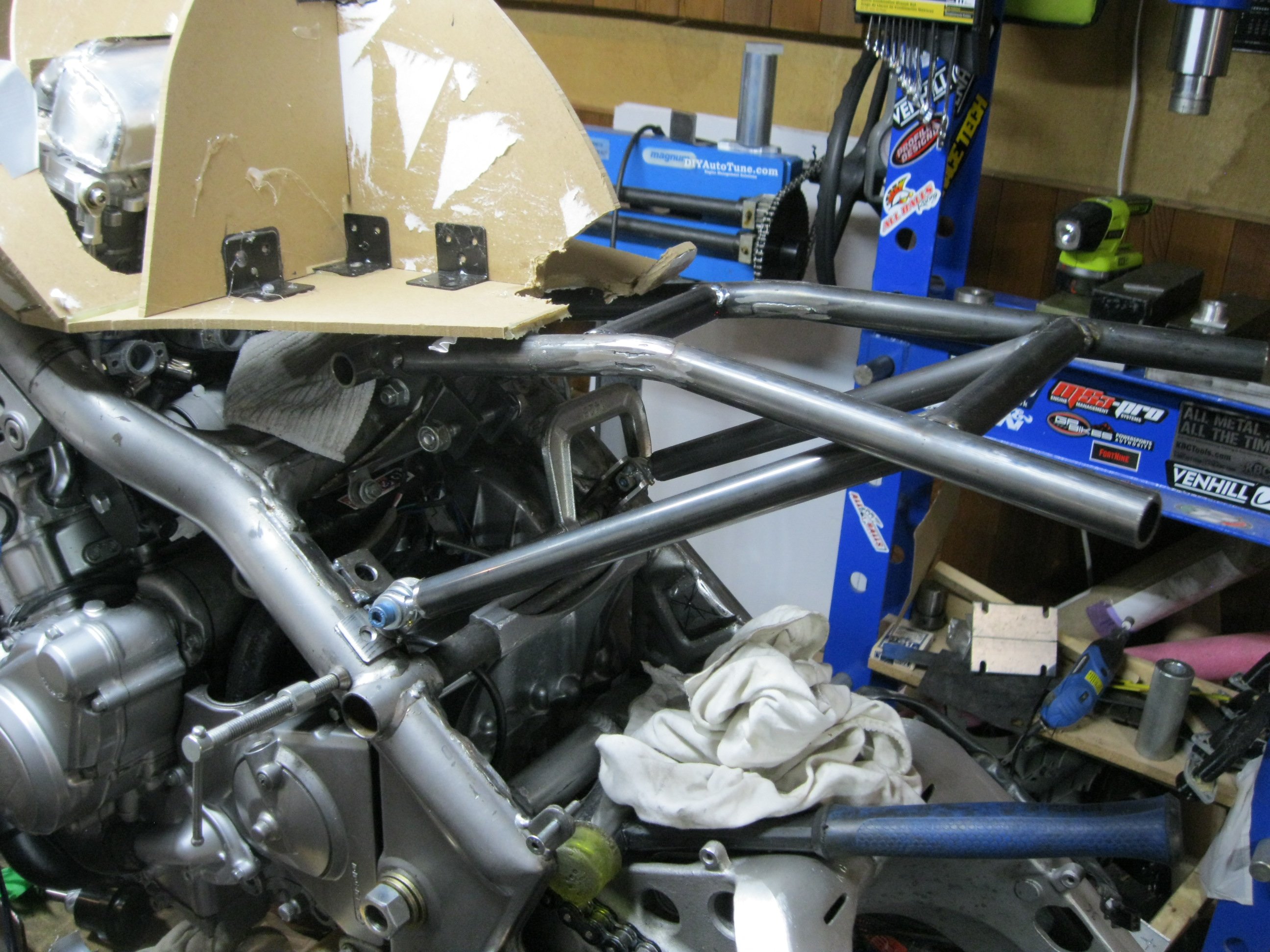

I was searching for some parts for another project and came across a Kawasaki steering damper that I bought way back in the 80's. I know I had it but hadn't seen it in years. I used the stock mounting point on the GSXR lower clamp, machined off the kawasaki body mount and made a new floating bracket. The frame mounting bracket is just a piece of angle right now but I will incorporate the damper mount and the fairing mount later on.
