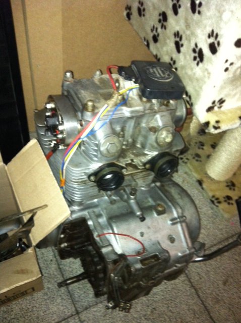

after the mockup I completely took the bike apart and sorted the parts. Tomorrow I'm gonna start with polishing the aluminium parts. I'm gonna go for a clean look, but not bling bling chrome style.
Next week the frame and small parts are gonna get powdercoated in high gloss black.

While the parts are getting powder coated I'm gonna entertain myself with cleaning every little part. I completely have the look for the bike in my mind, so from this point on it's gonna be pretty straight forward!
This week the most important job is to take the wheels apart, so they also can get the powdercoat treatment.
I just ordered new chrome spokes, so the wheels are gonna get finished in black with chrome spokes, drum brakes polished and some fat 4" tires on them.
The photos so far are a little bit boring, but when the frame is back the enjoyable photos will follow!
I'm gonna clean the carbs with the lemon juice and hot water trick and some parts of the engine are gonna get the black wrinkle paint treatment. I also plan on running pod filters, does anybody have a baseline how much bigger the jets need to be? ???
