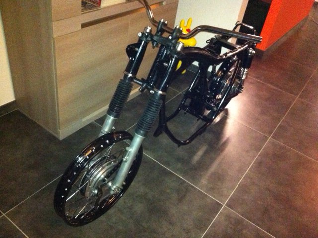

Finally got my parts back from the powder coater yesterday and I found some time today to start building.
I laced the wheels first, then I mounted the forks, swingarm and I did a little mockup, this is the result:
I'm really satisfied with the glossy black finish, it's perfect. It works very well with the parts that are painted with the wrinkle paint.

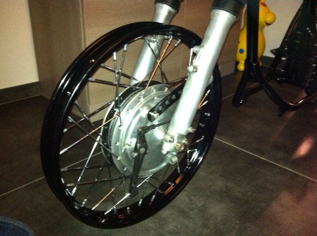

some more details, the inner part of the hub is painted with the wrinkle paint and after that I polished the lines in it, hope you understand me.

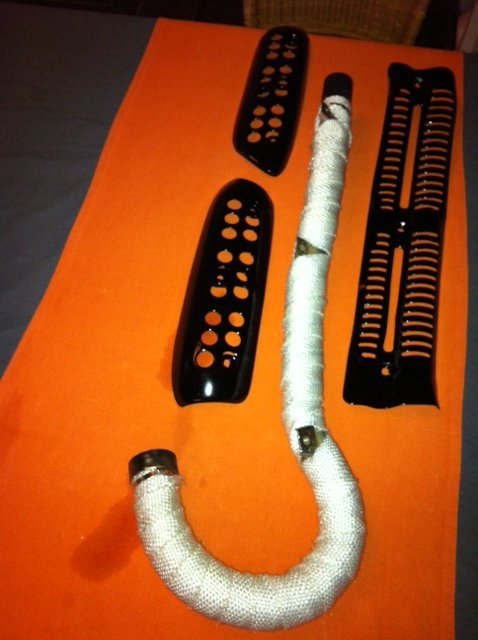

and the last one for today, I already started to "pimp" the exhaust. Tubes will be wrapped with white heat wrap, the heat shields are powdercoated black and the mufflers will get the wrinkle paint finish.
A preview:
