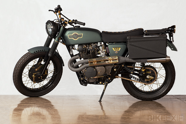

Don't know what your final hope looks wise is for the bike, but you've got one with plenty of potential. Personally I think Lossa Engineerings CL450 revamp was rad and still very much rideable (unlike many of the other bikes on the interwebs..) might give you a few ideas.

I've been lusting after the lossa engineering bike for a while now. That guys is sick. I can only hope. I do have other bikes that I can ride so there isn't pressure to rush through this and cut corners. Also with these 450s becoming more and more rare I really want to attempt to do it justice. Here is what I saw on eBay but haven't had time to research http://pages.ebay.com/link/?nav=item.view&alt=web&id=231394795275
