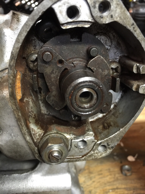

Can anyone tell me how to get this off. I am wondering if the shaft is supposed to spin or something that will allow it to come apart. The whole thing spins with the cam but I can't get it to rotate allowing those two "wings" to pull off of the "pins" what am I missing?

Does the whole unit not slide off the end of the cam? That's how the advancer is on my 125, just slides off the cam (once the points plate and bolt on the end of the cam are off obviously)
Re: Honda CL450 "Black and Tan"
I bet you are right. I have a jaw puller but that doesn't seem to fit. Hmmm any special tool anyone has created or used to get these off
It's bloody well crud welded on Governor... Heat and PB repeat. Put the bolt back in [EDIT] (and back off 1/4 turn), put the socket on the bolt and give it a light tap with a brass hammer or be careful not to smudge the socket, the outer "tapered" boss will come off, then you can pull the advancer. That looks seized but not to bad to free up with heat and PB.

that wont do anything there is no taperes involved all you are doing is banging on the cam end
you can pull the points cam off rotate it fully advanced and it will come off, so that you can get a little heat on the part that is seized to the actual cam itself DO NOT use a puller the unit it too frajill DO not get heat on the part that has the pins and springs attached to it porotect it from any flame it is hardened steel,very thin and you will ruin its strength only use a few licks of the flame on the part that sticks out and goes over the cam maybe almost smoking hot no hotter

Nice save XB... I had pulse generator on the brain.

Man thanks guys. This all helps a lot. So the cam for the points will twist off separately????
also if the unit is rusty you need to kill the rust and inspect it carefully with a glass for cracks they will 'splode eventually if cracked, i know first hand got stranded thataway one time

I got it pulled off but it was no joke. That sicker was on there. I might have to replace the cam. I heated blasted pulled etc for hours. Finally went to a puller. Created a custom puller. ....nothing. Last resort I cut down the sides with a Dremmel hopefully not scoring the cam. Even then it wouldnt come off until I used the puller that I created. After all that I got it off and have one small score in the cam. But it is clearly rusted.
