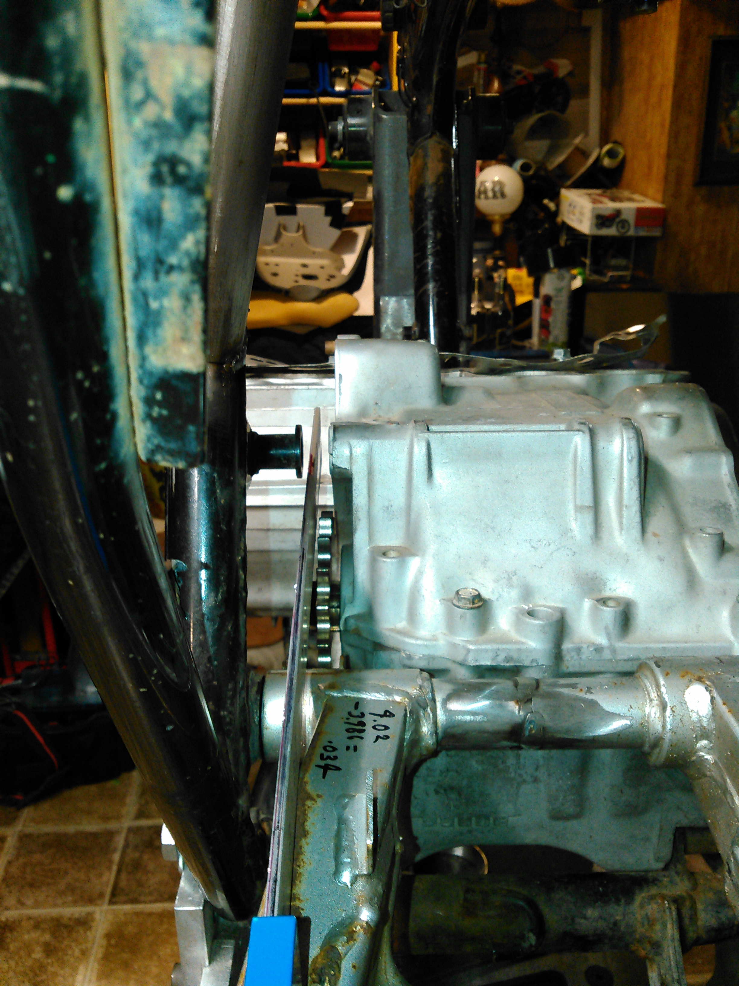

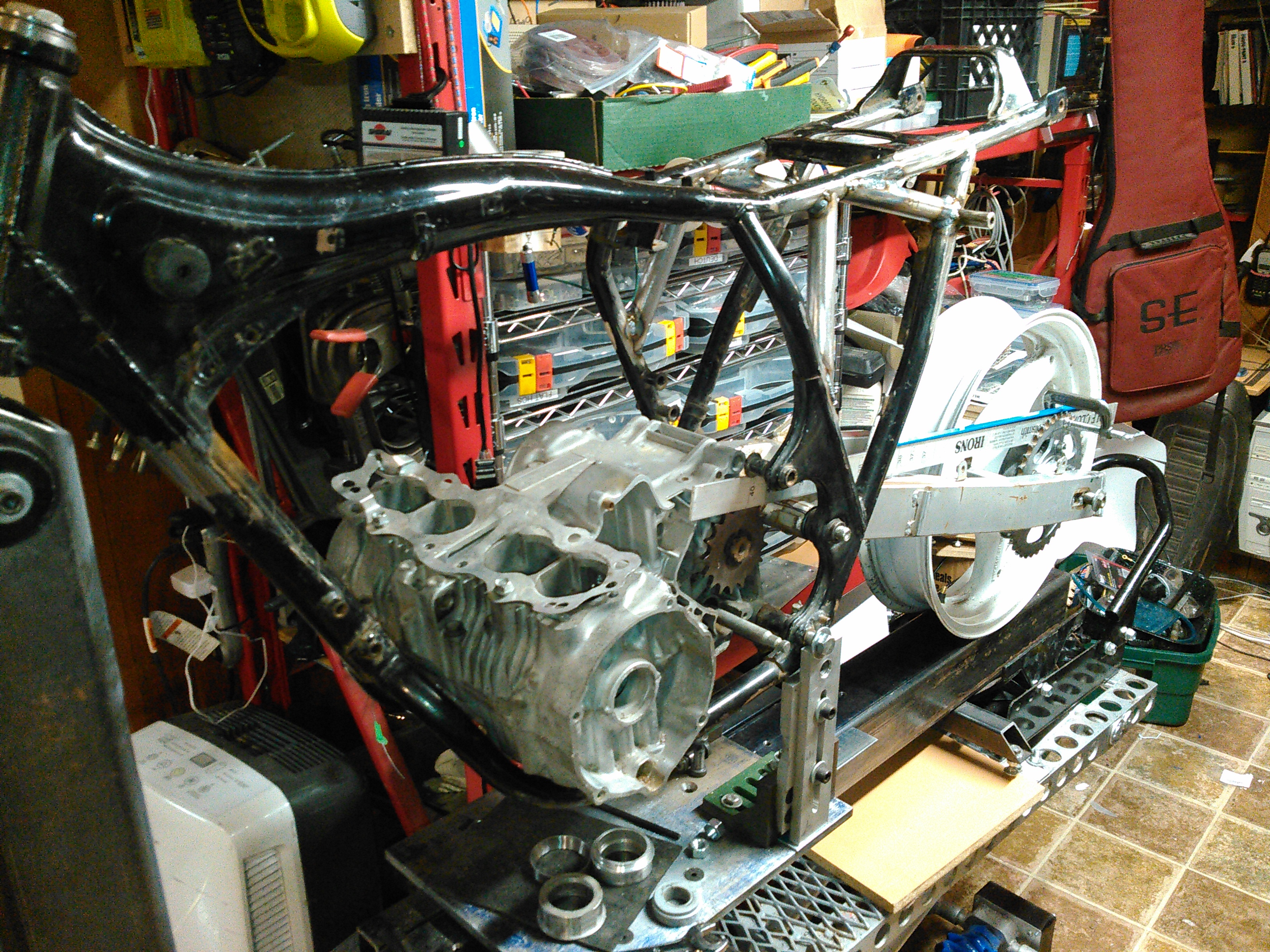

I threw the frame up on the frame jig to get the rear wheel aligned. I checked the rear wheel position and compared it to my CAD models and they are within 1mm, so that's good.
The sprockets are about .25" out of line. I can get an offset front sprocket, or machine .25" off the sprocket carrier. I think I'll wait until the tires show up to decide. Offset front sprockets are $80 USD, and I can machine the carrier for nothing, so as long as I have clearance from the chain to tire, I'll likely lean towards machining the carrier.

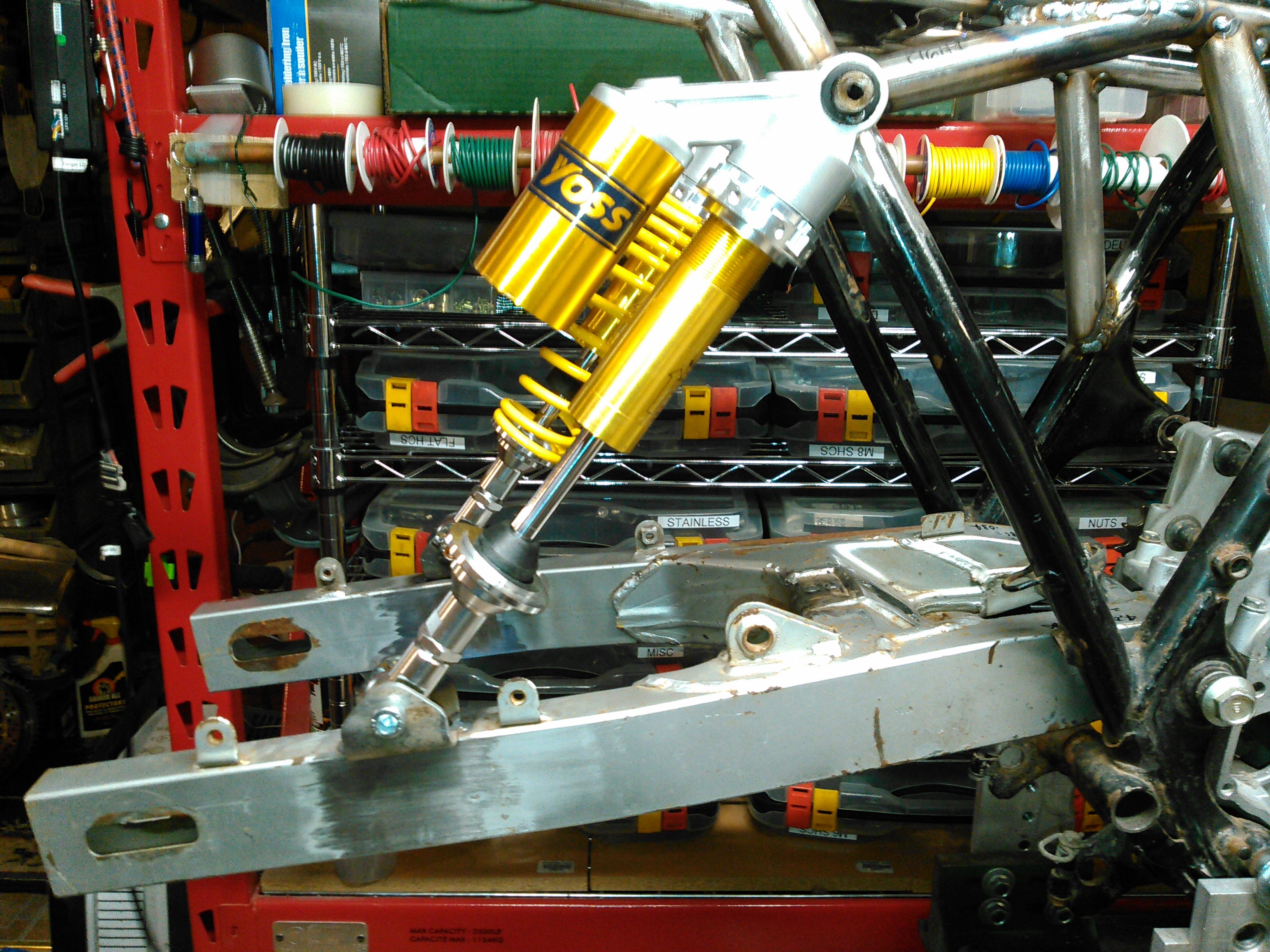

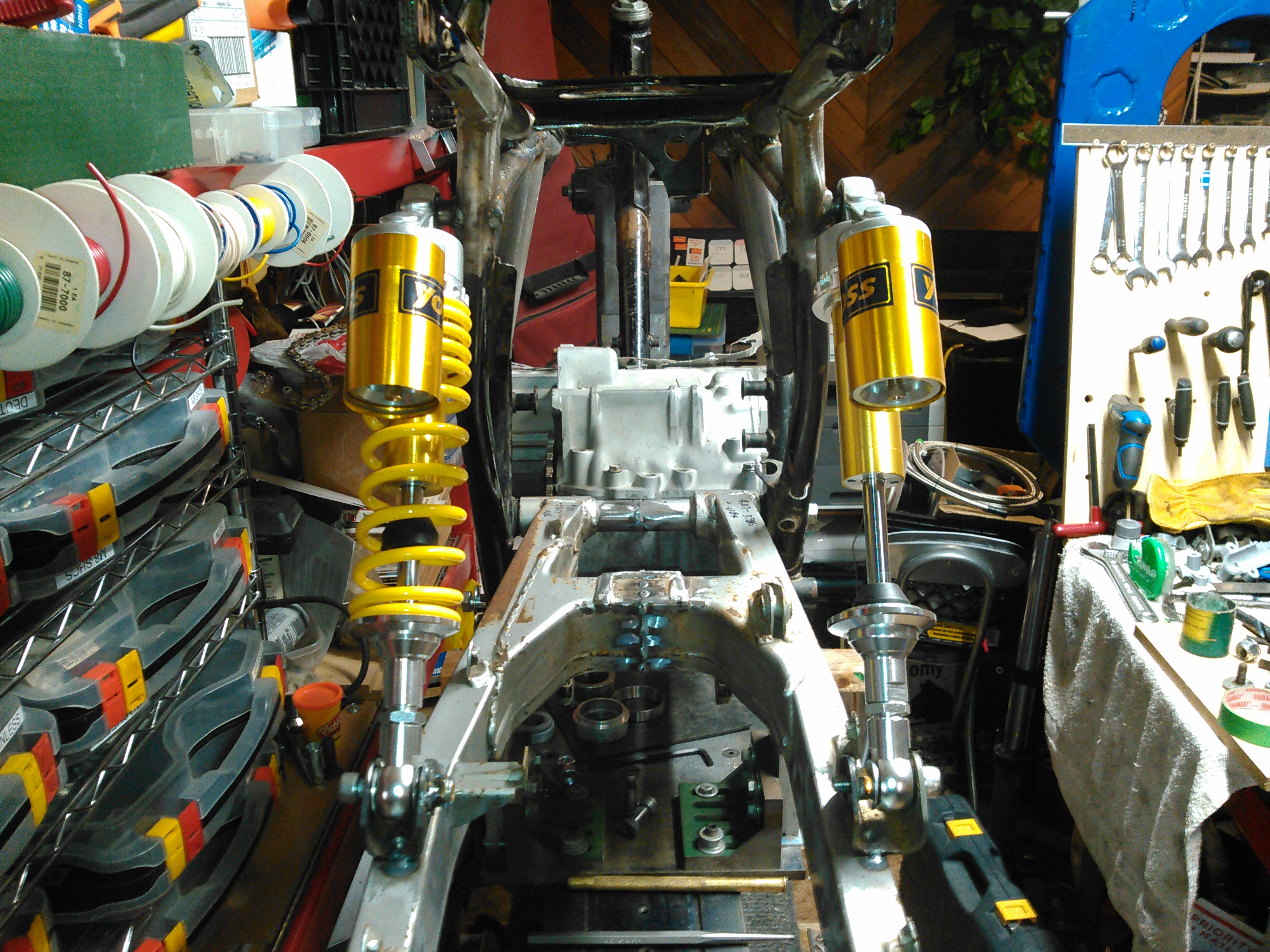

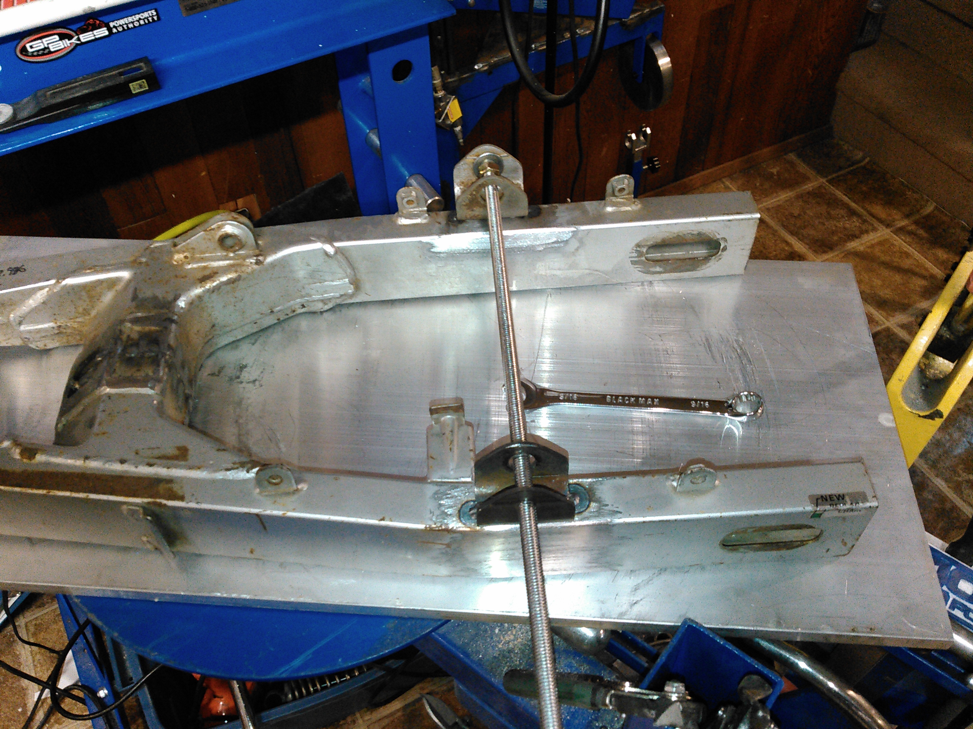

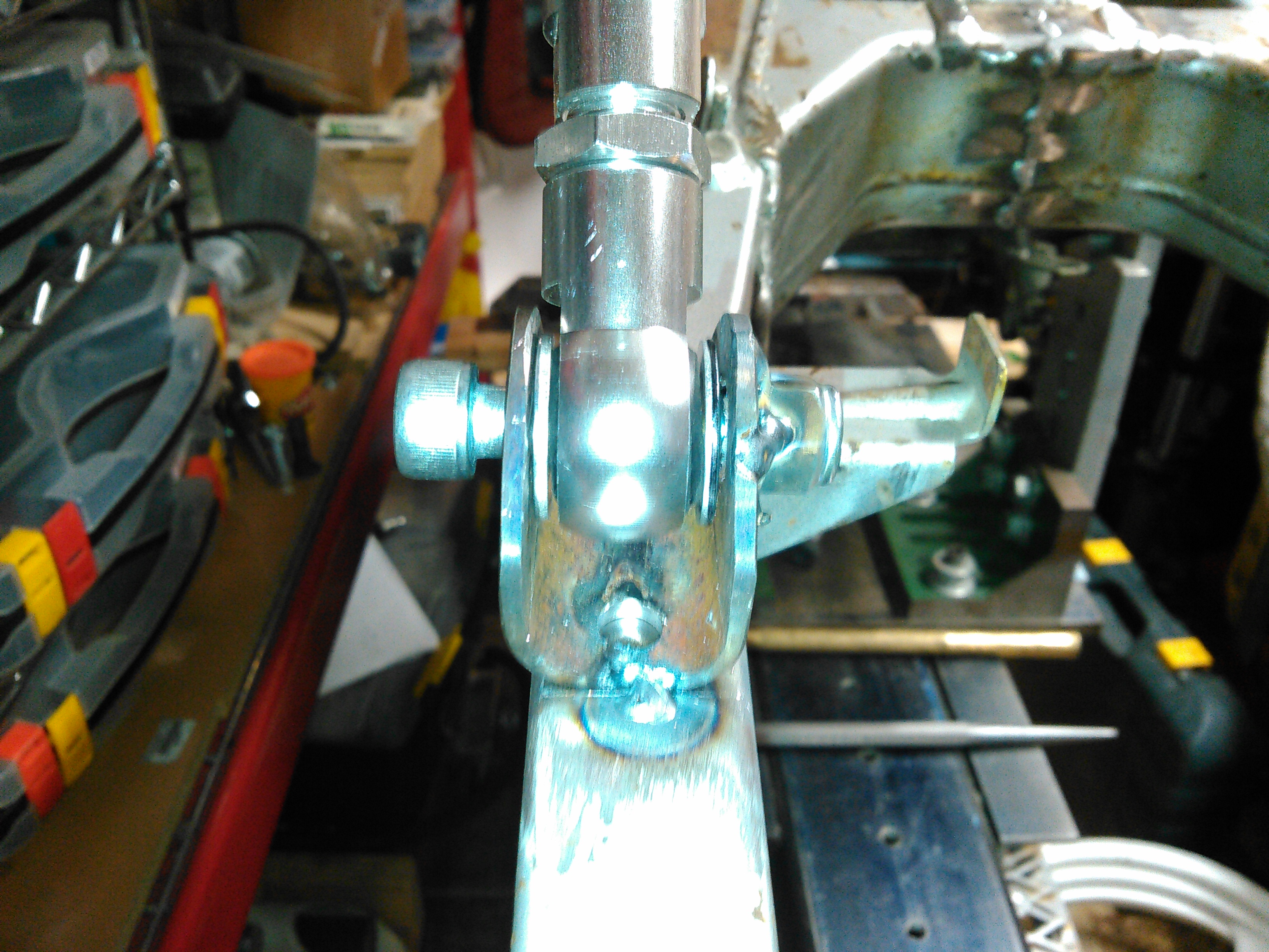

I marked out the shock mount locations, clamped them in place, checked alignment with a thru rod, and tacked the mounts in place. I have a gusset made for the right hand mount, but I'll wait until I get the rear wheel positioned and spacers made before I commit to fully welding the shock mounts. I made the mounts a bit wider than the shock mount to allow for some adjustment. When the time comes I'll machine some spacers to take up the gaps.

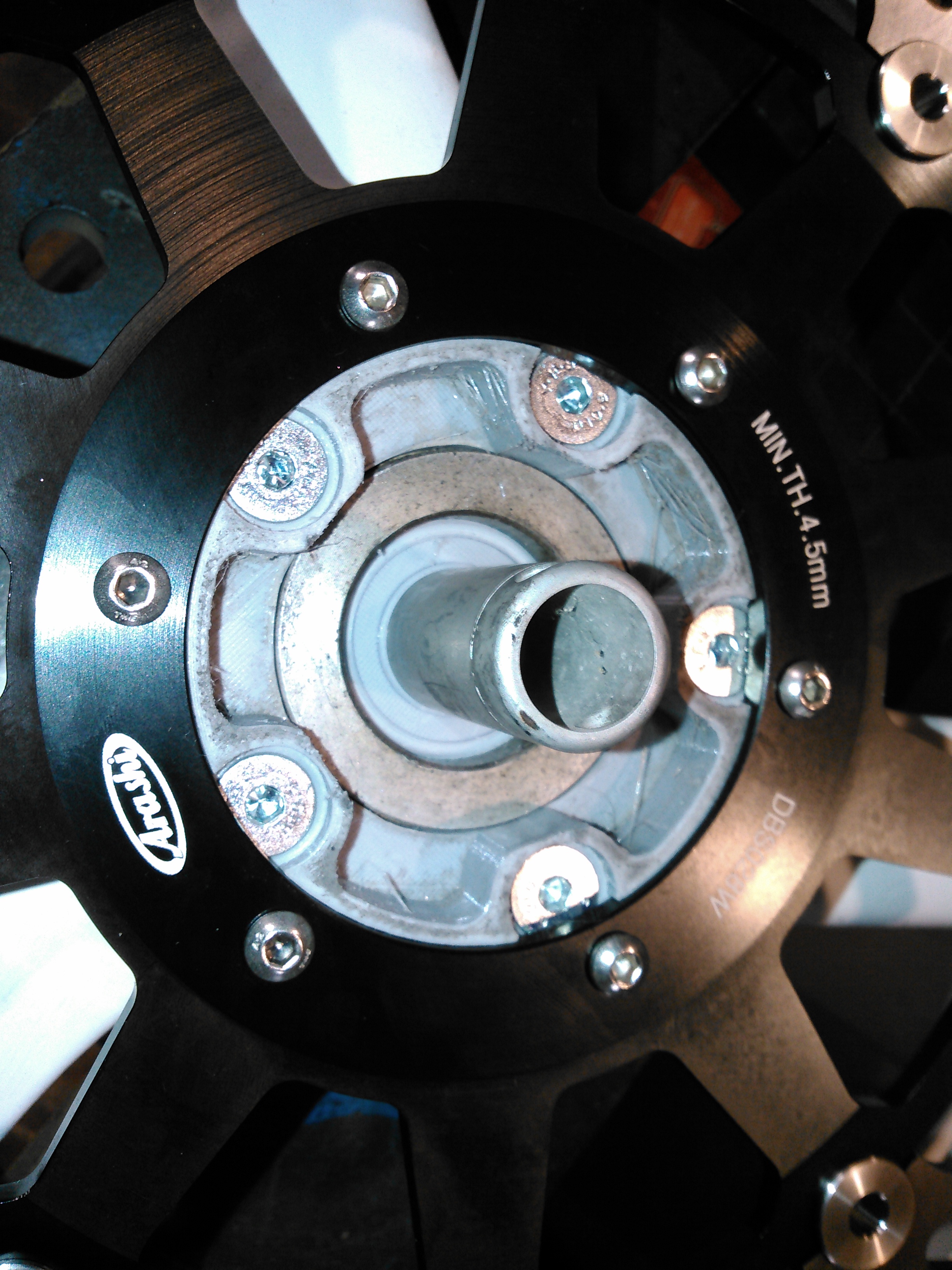

Mail today! (actually DHL). I did some research for these Arashi disks, and people seemed to be happy. The price was right compared to new, and at least you aren't getting worn out or bent used samples on Ebay.
I laid out the stock GS disk and a CBR954RR disk in CAD and the CBR disk was going to make the caliper mounting easier to the CBR600F4 forks that I'm using. I need an adaptor to go from the 5 hole GS disk to the 6 hole CBR disk. I 3D printed an adaptor that seems to work well. Once I have everything nailed down I'll machine this out of aluminum.

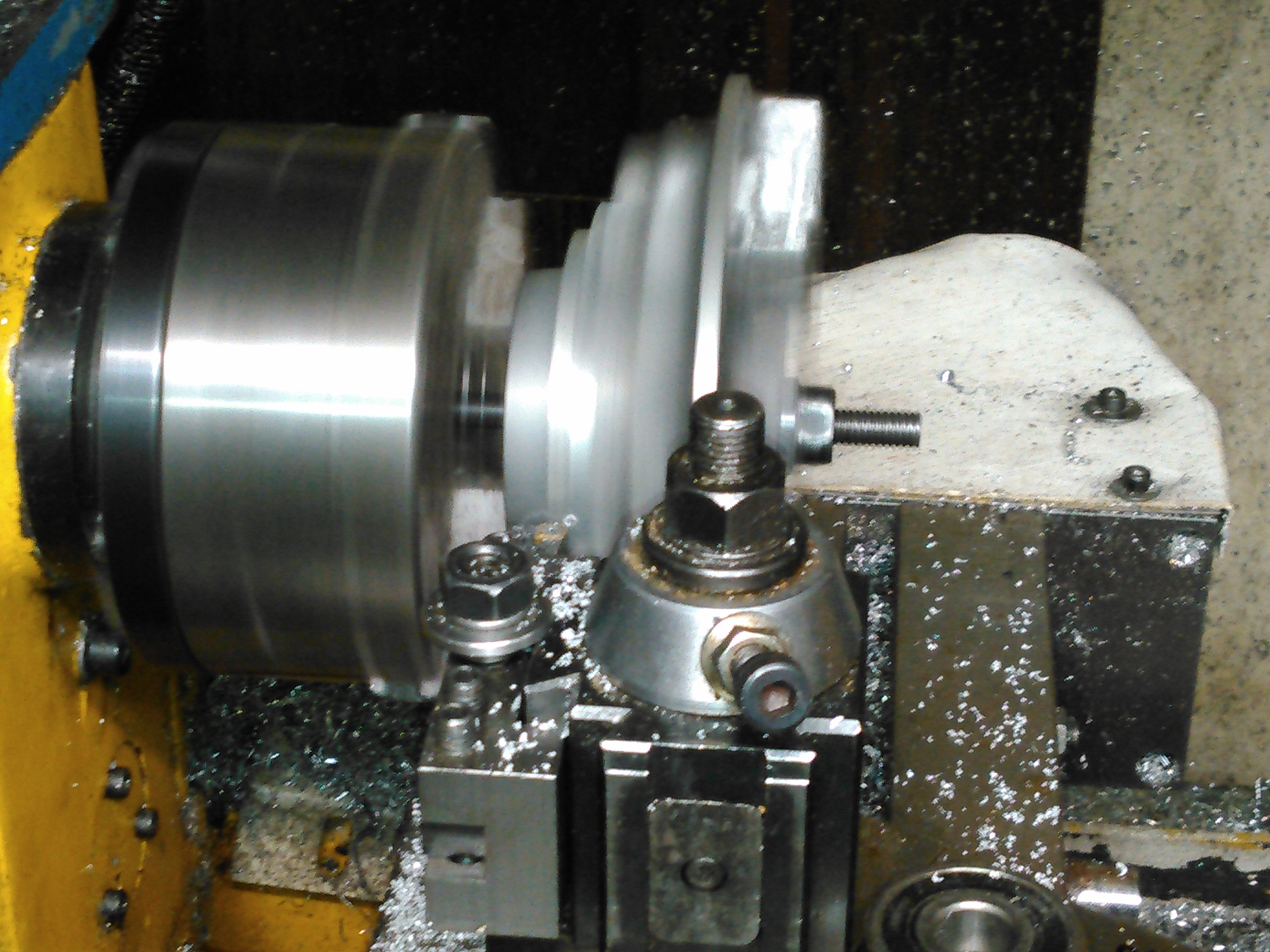

Taking .25" off the cush drive was easier said than done. The back of the carrier has 5 drive spokes, so it wouldn't fit in a 3 jaw chuck, or a 4 jaw chuck.
I ended up holding the front of the carrier in a 3 jaw, and machining "backwards". I used a long drawbar thru the spindle to secure the carrier against the cutting force.

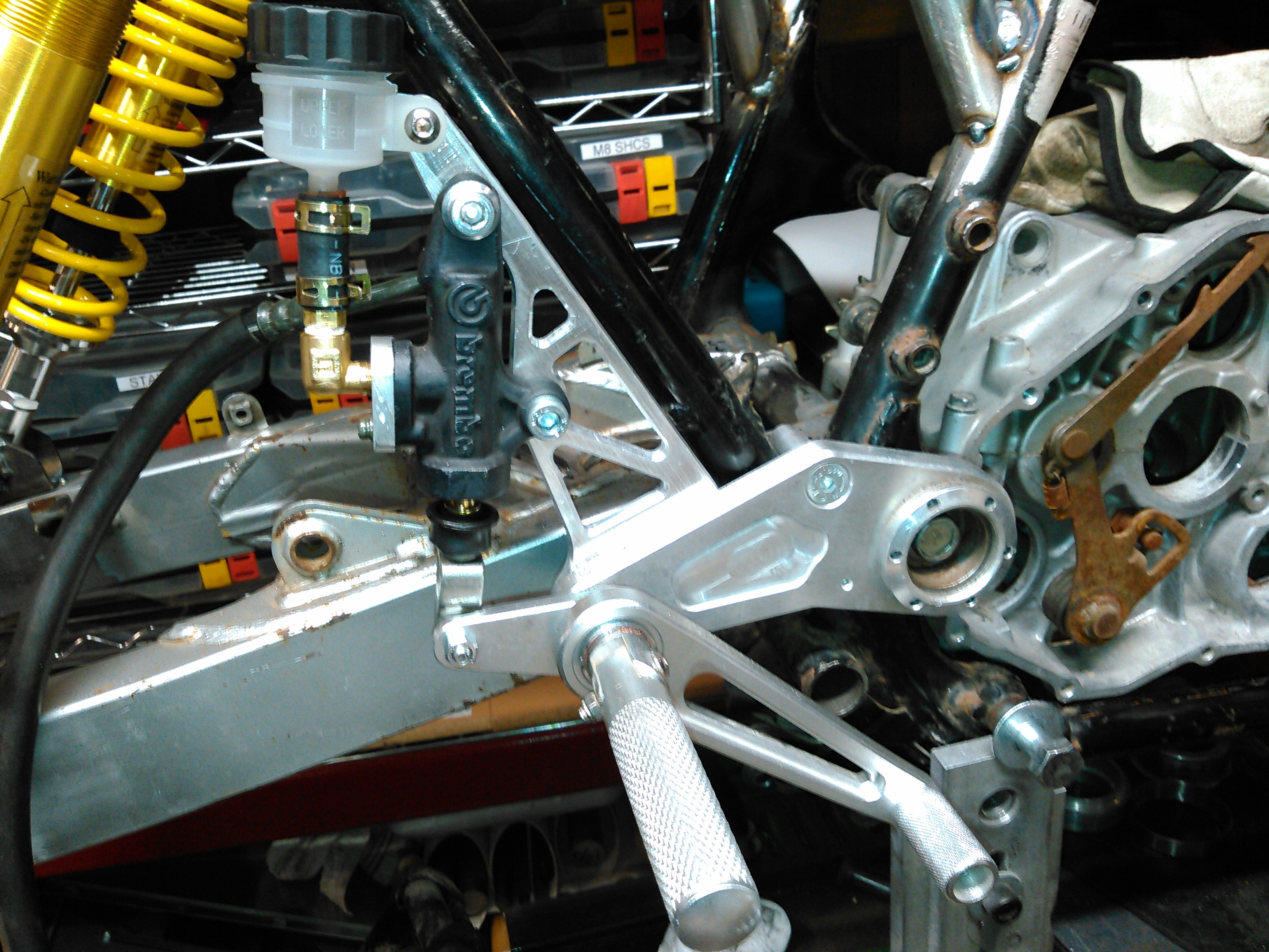

Right side rearset and brake finished. The rearset is a prototype that I did a few years ago and never put into production, the pegs/levers are Tec-Bike that I had bought just to check out the quality, (not bad, but not to Tarozzi standards) and the master cylinder is a Yamaha/Brembo from a 1999 R1 that was lying around in the parts bin.
Say what you will about Amazon, but I ordered the remote reservoir on Thursday and it was delivered on Sunday. USA guys are used to quick/cheap shipping, but us in the Great White North are not. Before Amazon, everything took 2-4 weeks to arrive.

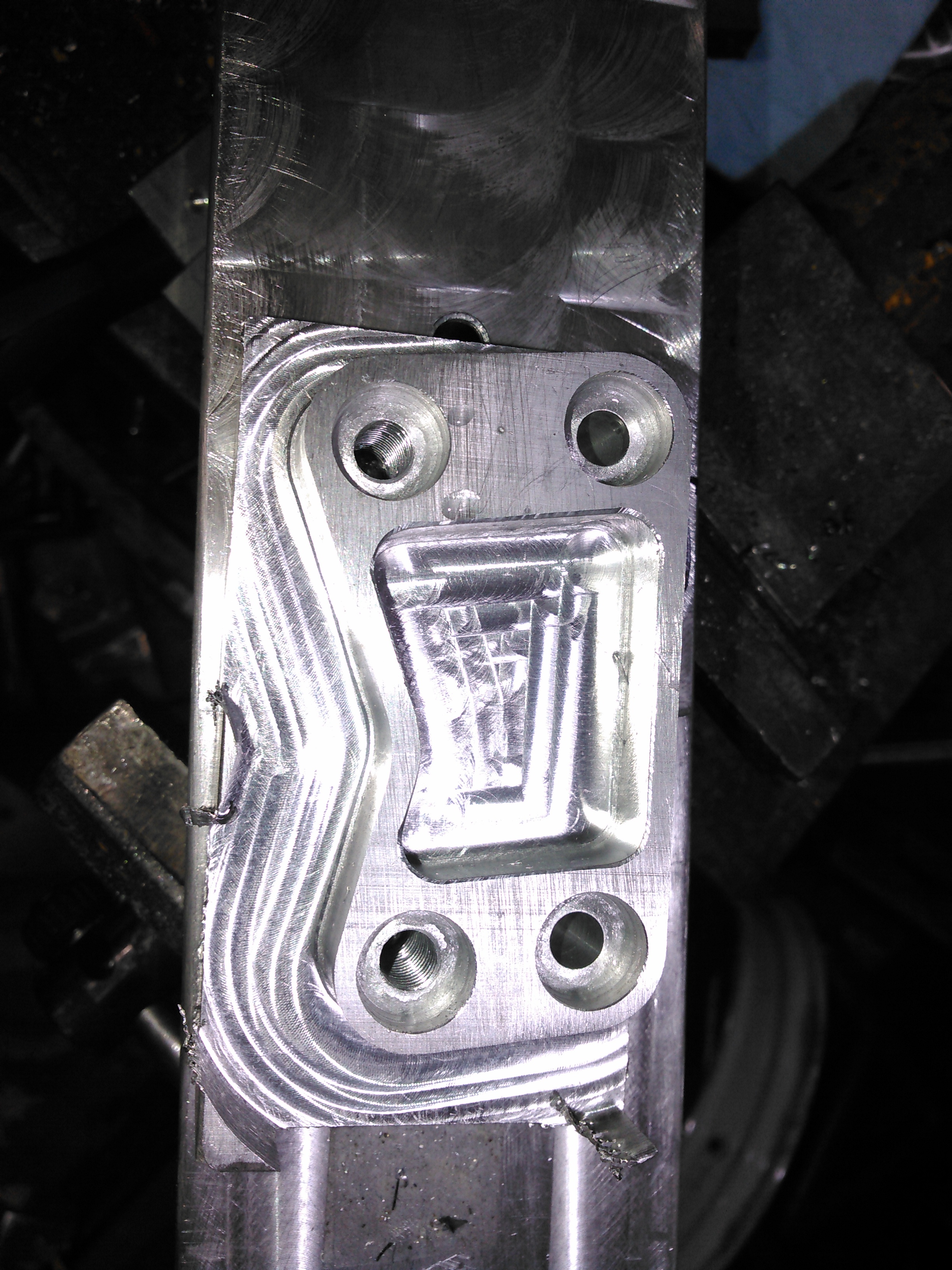

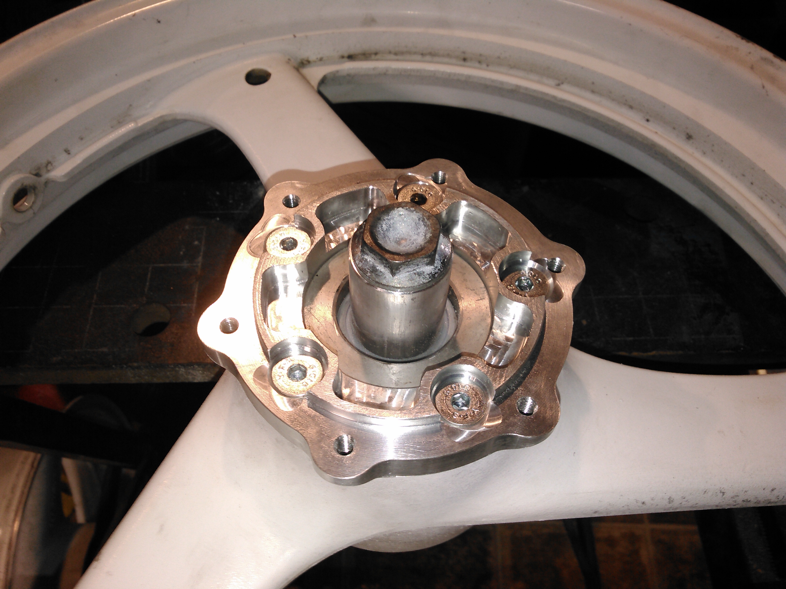

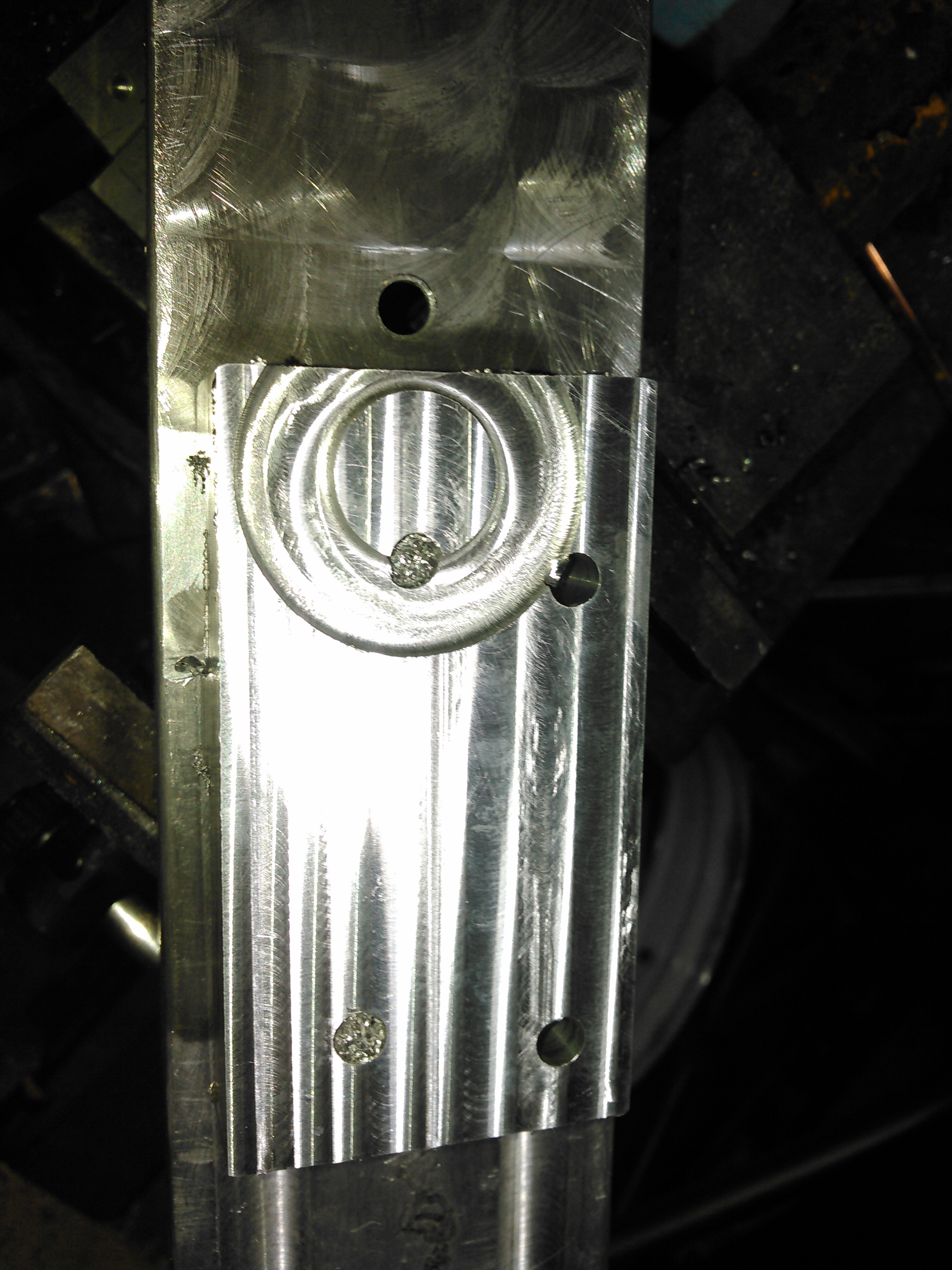

I did manage to get the front wheel/disk adaptor from a 3d printed part to a machined aluminum part.
Well, it happens to the best of us. A wasted afternoon of machining. The front side went OK, when I flipped it over to do the backside I got my datums confused when programming, so the the very first cut you see should have been centered around the drilled hole. DOH!
Sometimes when you screw up you get lucky and catch it before it ruins the part, not this time. The center of the raised area needs to be concentric with the hole. Try again tomorrow.
F**k-up salvaged. I thought about it overnight, and decided I could salvage the part. I re-zeroed the part correctly and finished the machining. I then skimmed another 0.20" off the screwed up tower, machined a 0.25" spacer, and welded it on to the tower. Re-mounted the part in the holding jig, zeroed the cutter at the height of the good tower, and took the approx. 0.05" off the spacer.
All good.

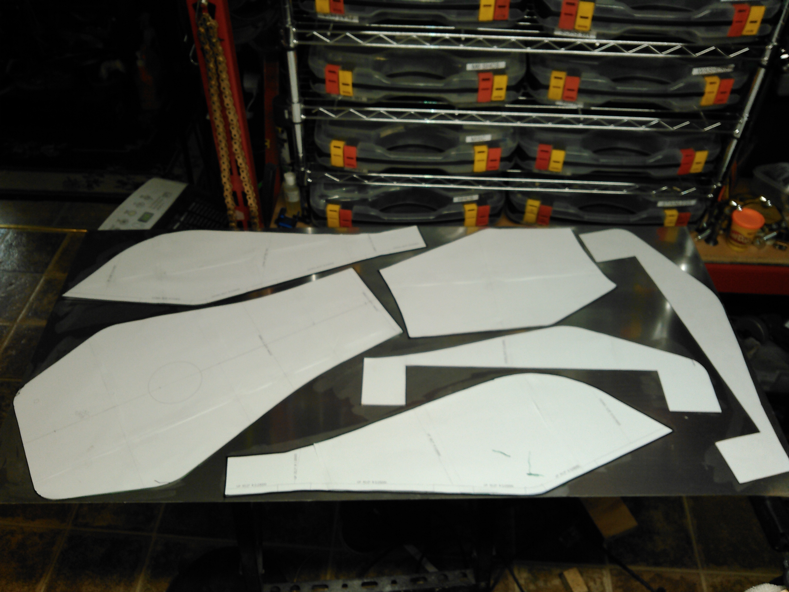

Some still shots of the buck, and the patterns laid out on the sheet. 2' x 4' x .080 thick 3003-H14.
Total time into the buck so far is about 10 hours. I got sick of tripping over the tail section buck this week so I sacrificed it to the Gods of Garbage to clean up the shop a bit.
