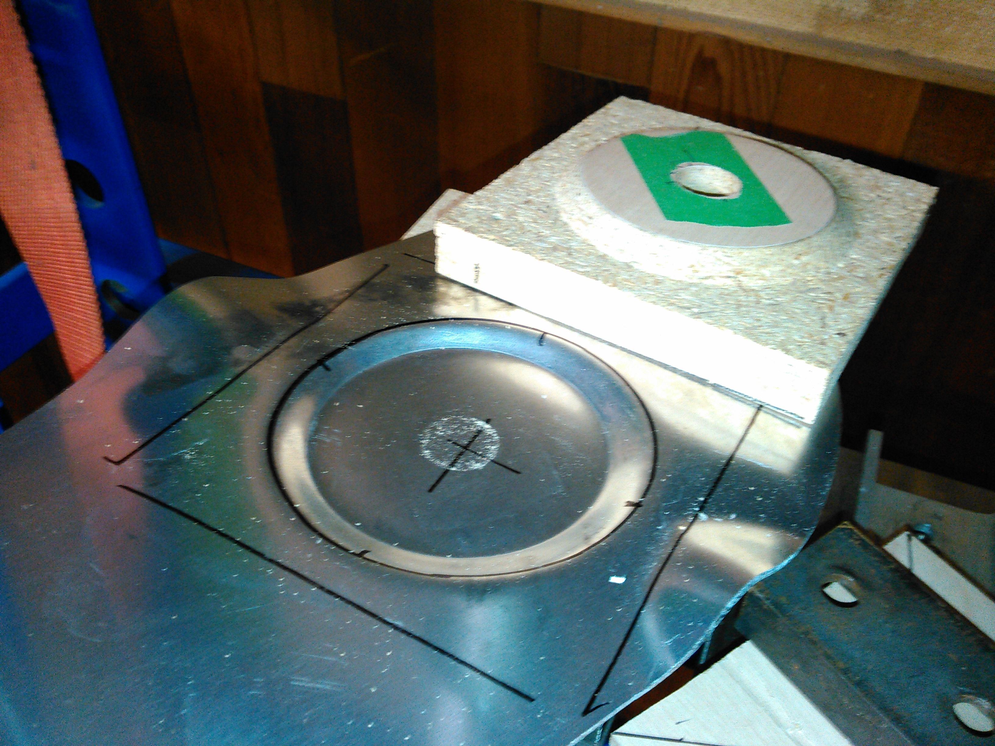

And, I wanted the indentation on the side of thank for the quick fill, even though I wasn't going to use it. I make up a set of dies from some particle board that I had lying around, and stuck it all in the press.
I had to flatten out (stretch) the material around the perimeter of the panel after dimpling, but all in all it went pretty well. Dies like this are not very strong (I had to anneal the area of the panel that got dimpled) but they only took an hour to make, and you could probably use them a few more times before they gave up the ghost.

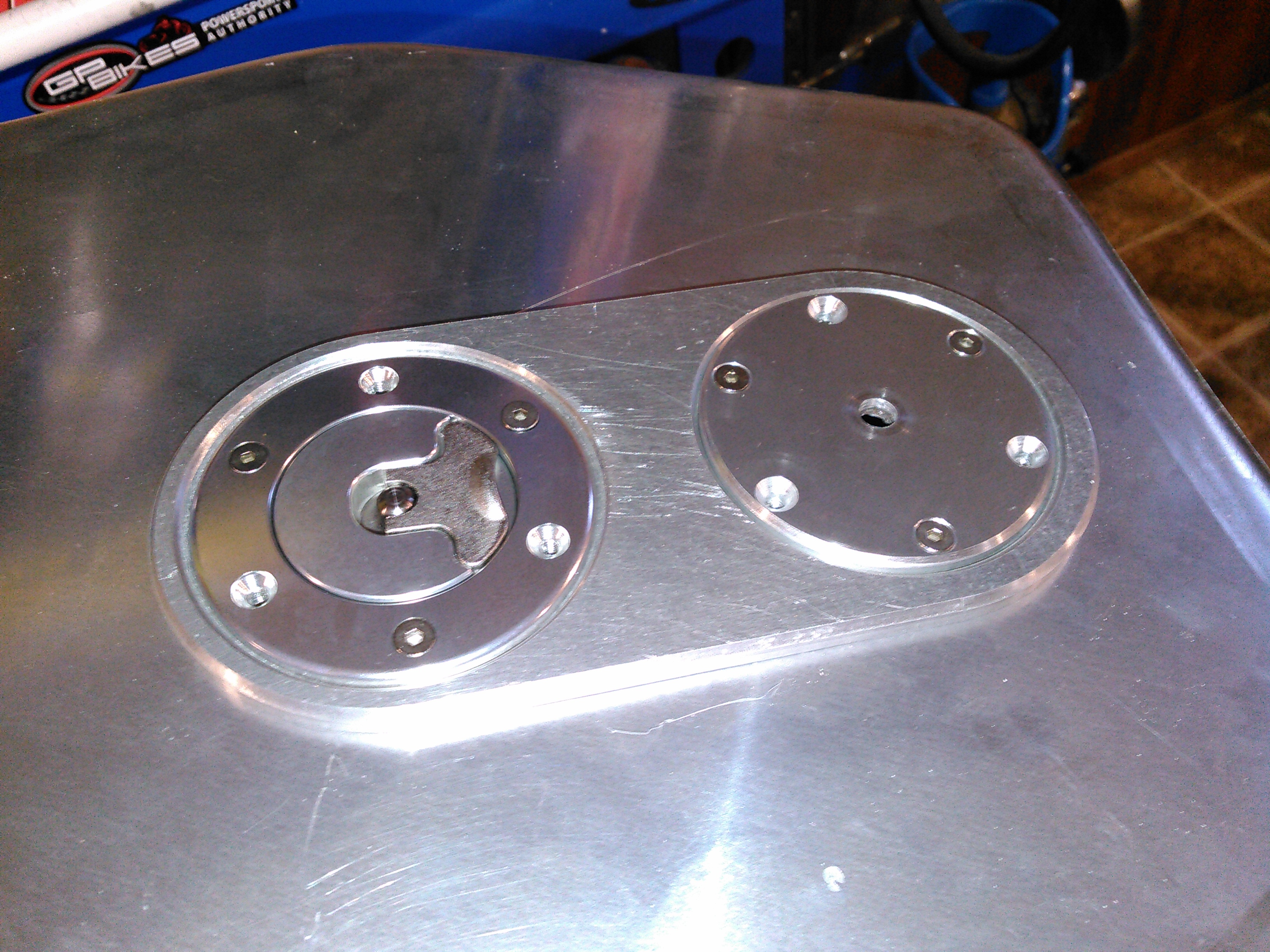

Finally got some time to work on this project again. I got the tank pieces fitted and ready to be tacked together. (hopefully this week). And, my fuel filler arrived! I had a choice if this 80mm one or a larger 105mm one. I picked the small one, but now I wish I had picked the larger one. Oh well.
This is what a days work will get you. I started this morning digging up material, did all the programming, and milling, lathe work, tapping holes, and was done by about 3pm.
The front will get one of those one way vent valve thingies.

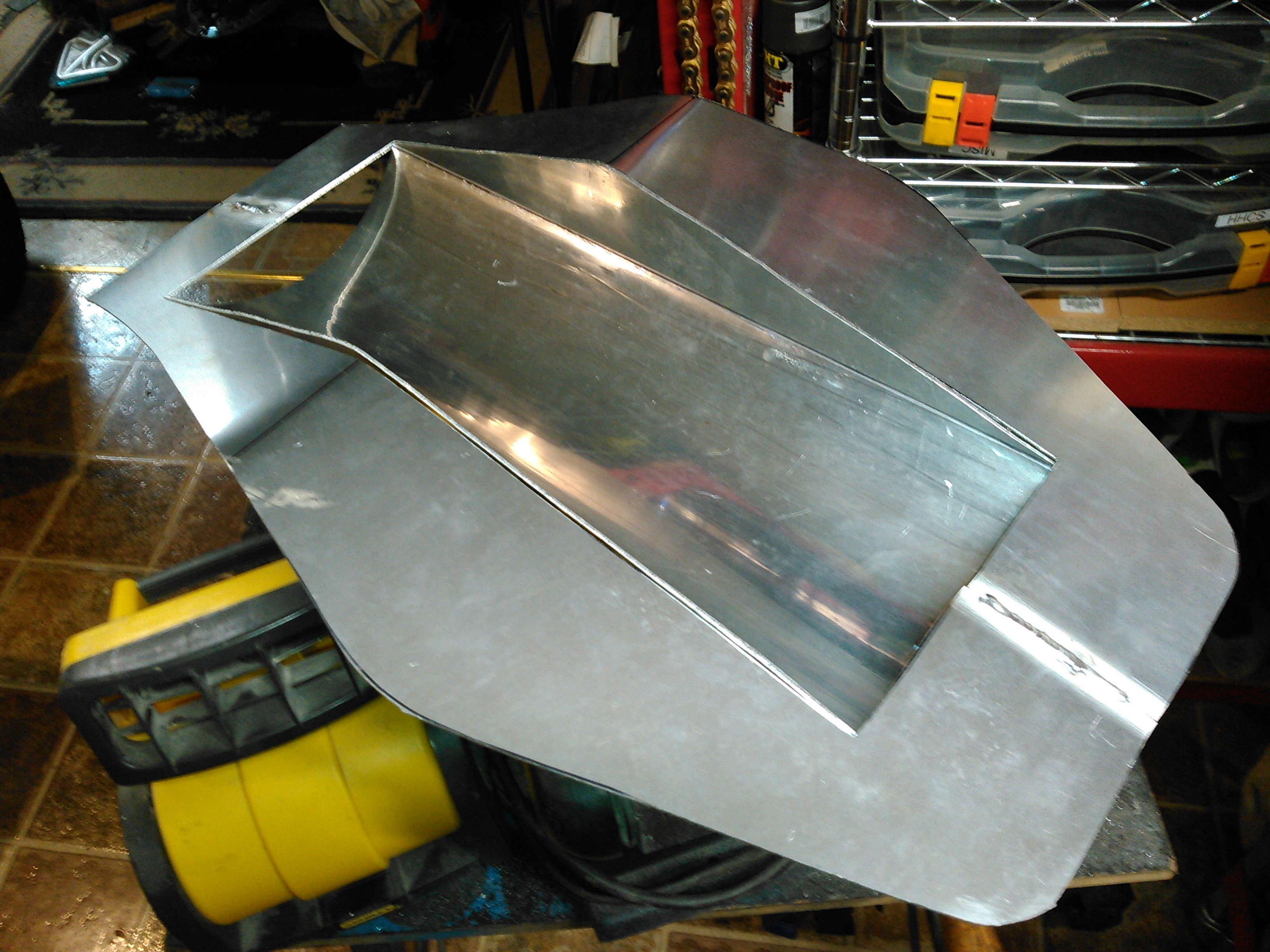

I thought I'd take a shot of the tank template that I made before I threw it out. If you can make it out of cardboard, it will be easier to make in aluminum. If you can't make it in cardboard without creasing or tearing the cardboard, then that means you are going to have to stretch/shrink the aluminum in those areas.

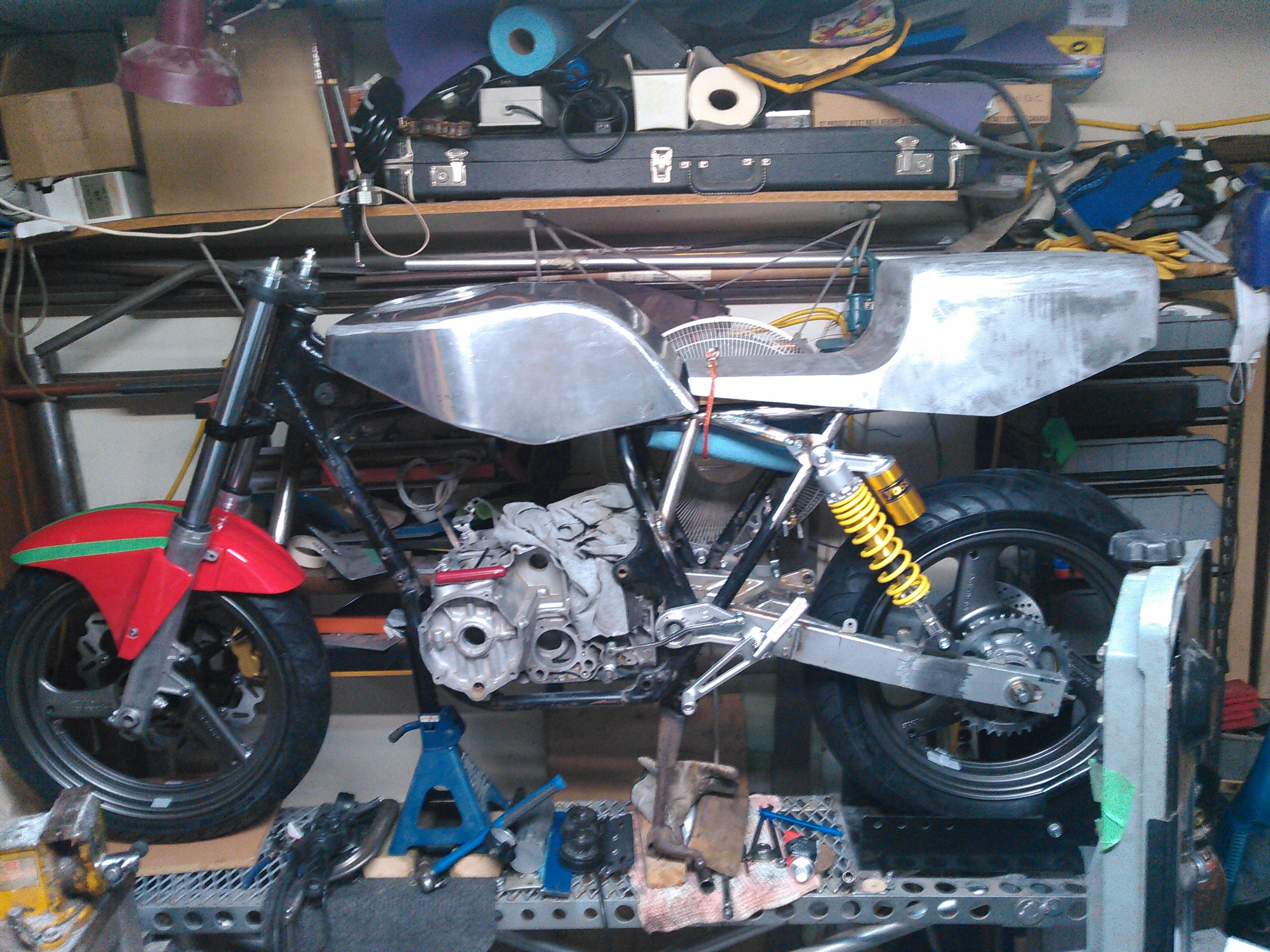

Overall view of the bike so far. I don't like the look of the CBR600F4 fender, so I think I'll have to make one to fit.

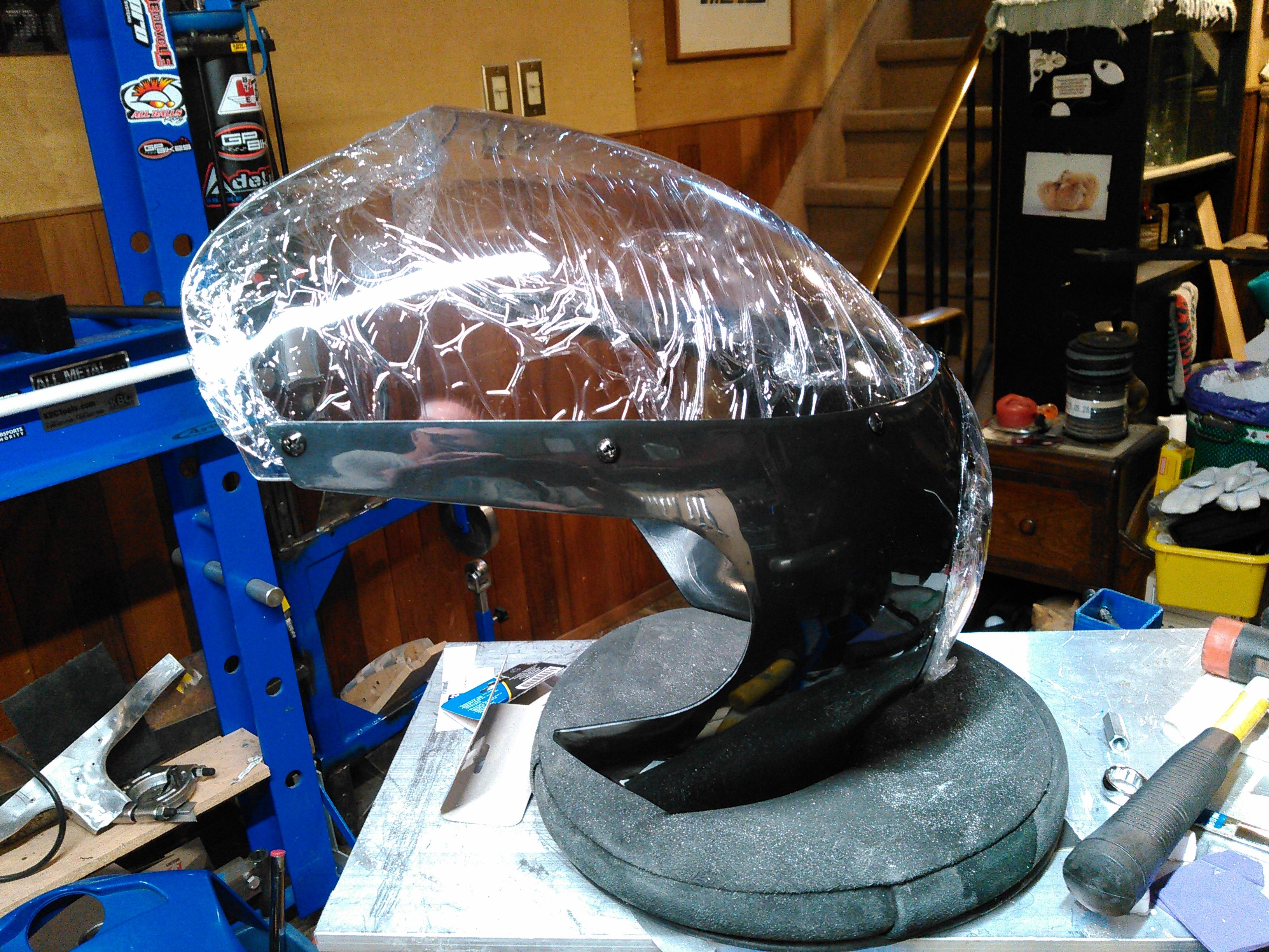

I am going to try to make RCB half fairing from aluminum. I needed a windshield to start from so I didn't have to try to make something fit afterwards. I was going to use one from an NS400 since I have an NS windshield and fairing mounted on another bike, and I was going to use that as a starting point. Until I priced out an NS400 windshield. $190USD from Gastaffson windscreens. With shipping thats around $275 CDN. Too much for this cheap ass Scottsman.
I had seen these little quarter fairings all over the internet, especially on Alliexpress for $35-$40USD, and there was one available on Amazon.ca for $60 CDN with shipping. I figured for that much I'd order one and if I didn't use the windshield for this project, I'd use the whole fairing on some other project.
I was pretty happy with the quality for $60. The main body as ABS or polycarbonate, and it is smooth and well finished. The windshield looks like an injected molded acrylic or something. I think I can use it as the basis for my half fairing.
