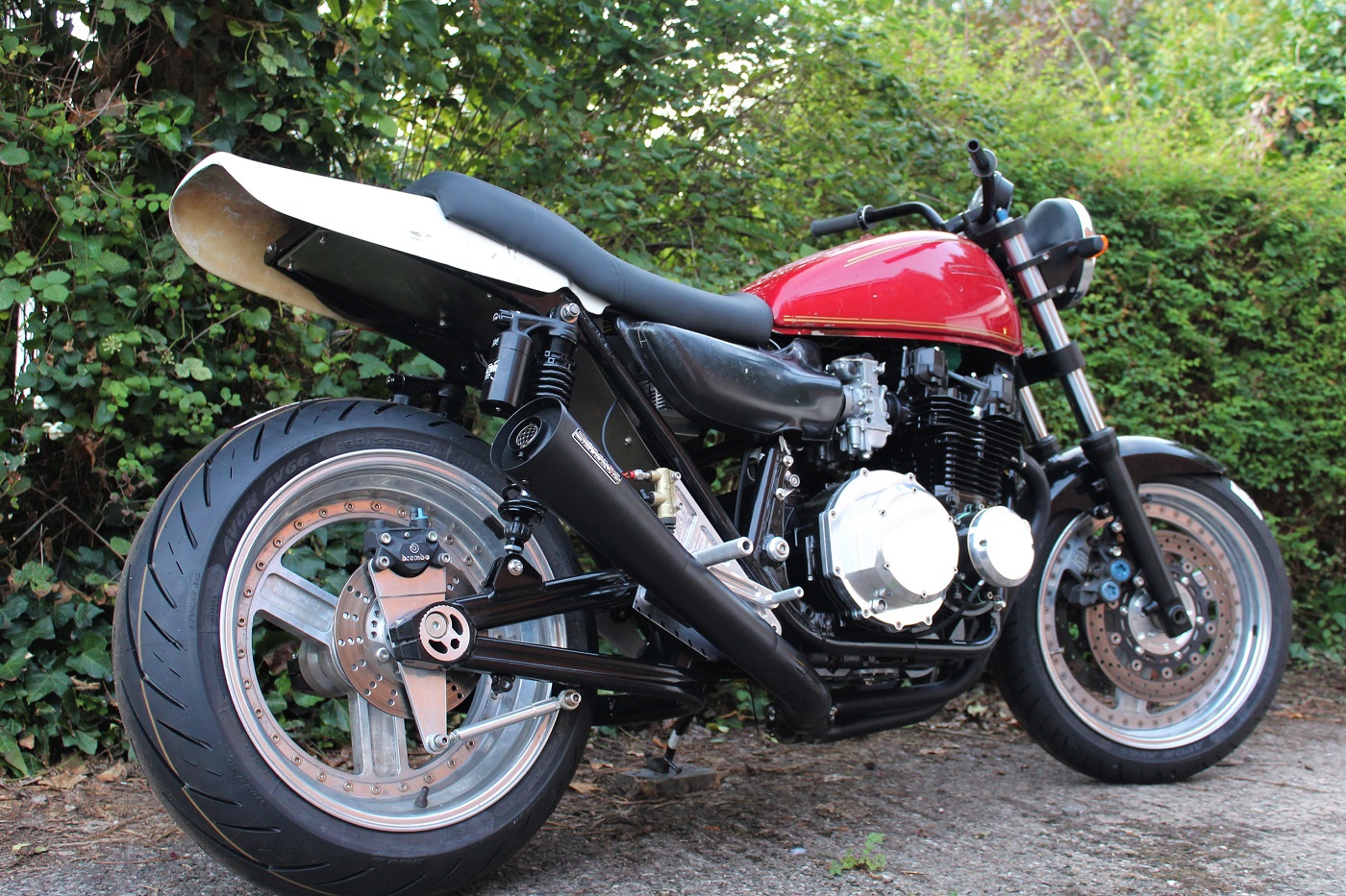

Spent a frustrating hour or two making the exhaust hanger from 3mm stainless plate.. took ages. Still needs more work to shape it, then it can be powder coated black later.
Got the exhaust how I want it now, still need to trim and shape the hanger. Also sprayed the welded bit of the 4-1 collector with HT paint.. pity its a matt finish, as it doesn't quite match the satin black of the rest of the exhaust. Just ordered a can of satin black PJ1, which should look better.

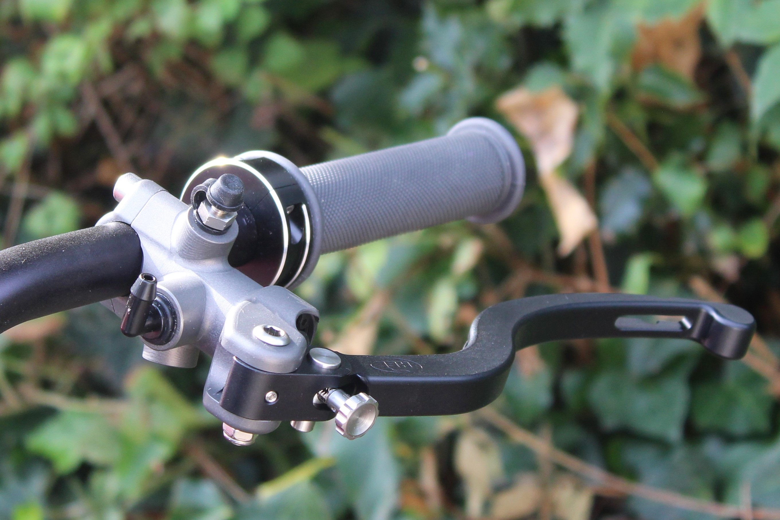

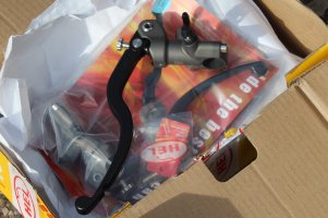

Received the clutch and brake master cylinders, made in England by a company called HEL. They are machined from billet alloy, as is the lever, while they have a variable piston size.. in my case 14/15/16mm. The clutch and brake are identical, as they are made so they can be used on the left or right. The bleed nibble and banjo threads are the same, so they can be flipped over.
