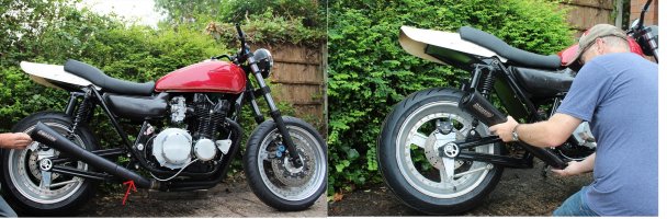

However, once fitted, it was soon clear I had yet another problem, a big problem.. The exhaust was made to fit a GPz1100B1, same as the engine in my bike. But the rear wheel and swing arm are obviously wider than that of an early 80's B1. However, I didn't expect the difference to be so apparent, as the collector pipe into the silencer is far too close to the swing arm. There's no way the silencer can be fitted. Also the foot controls are in the way too.. though I want to raise them up anyway, so the kickstand clears the gearchange lever.
And things were going so well... sigh..
I reluctantly decided that the 4-1 collector of the Delkevic would have to be cut in half and extended by approx 2 inches to allow enough clearance for the silencer. My local welder did the deed, and luckily had an off cut of 2 1/2 inch stainless tubing which was just the right size. I had him fully weld the inner joint but tack weld the outer, that way it will be easy to rejig it if it turns out to be too long or not quite right.

I may also decide to change the 4-1 outlet, so the silencer is angled up a bit more. Not sure yet. The foot controls are also being raised, by making new hangers.. again.
In the pic the exhaust is hanging down too low as its not being supported..
Cut the 4-1 collector and had 2 1/2 inch extension welded in, one joint has been fully welded, the other just tack welded. That way its easy to modify it if needed. May also change the angle of the exit pipe, to tilt the silencer up higher, not sure yet. Pic below shows how it will look as is. Will also cut off 40mm from the pipe, to shorten the look of the silencer, as it seems a little long to me.

I ground off the collector's tack welds today, cut 40mm from the collector and tried to work out how much it needs to be rotated to give the silencer angle I want. The answer is not a lot. But will wait to get the new foot control hanger plates fitted before getting the pipe welded up. Just to check clearances etc. Don't want to do it more than once.

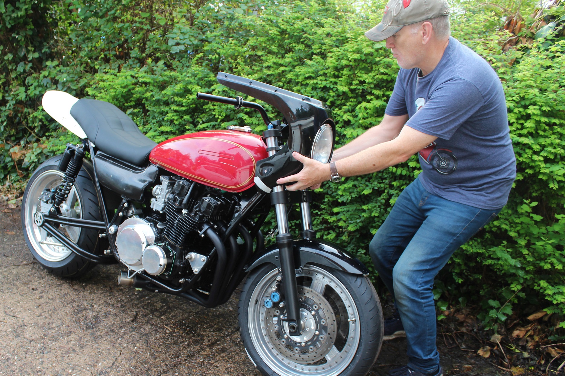

Having second thoughts about the R90S fairing, might have a problem fitting it once the brake and clutch master cylinders are on the bars. I got to see it on the bike outside for the first time today, and it does look a bit too big on the bike.
