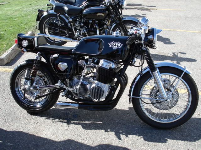

At the Sunday morning meets, there's a guy that has a Carpy CB750. His brake lever end folds up out of the way to allow his kickstarter to pass!
