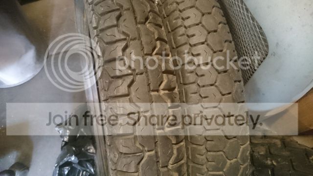

It's a Korean copy of something, branded as a golden boy but I think only fitted as OEM.
Would be great to find something to match it, I'll upload a picture of the tread pattern after I've had my supper.
Darn it! I'm going for the classic 16" outfit so will keep my eyes peeled for another block treaded 16".

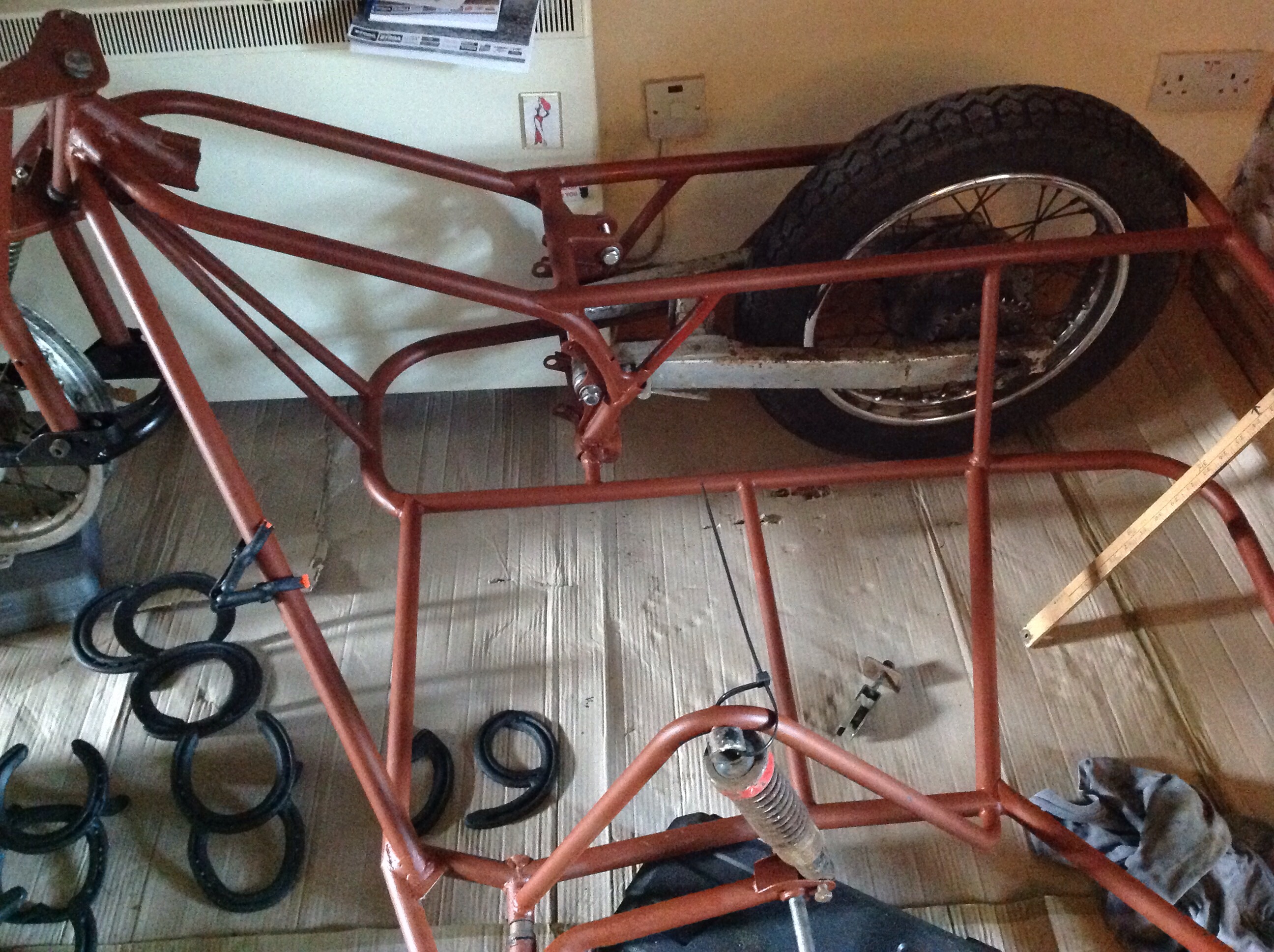

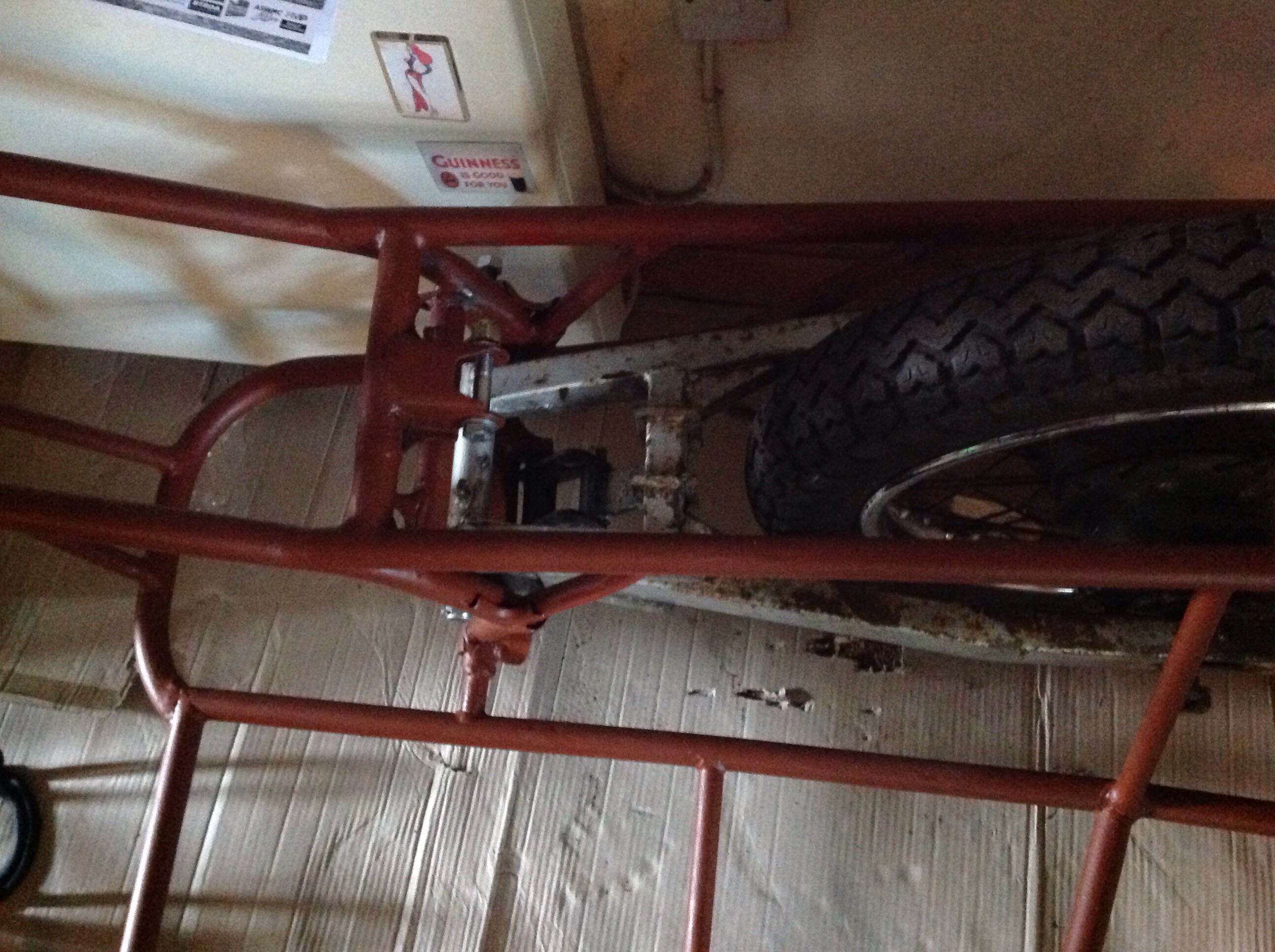

I've reached a bit of an impasse with the rear suspension .......
To get the ride height I want using the Honda 'Uni link' / 'Pro link' (can't remember what they call it) cantilever suspension system I need a 215/220 mm shock. I've found some quad ones at this length but they are for a 'direct' mono shock system. However due to the leverage ratio on the movement, the swinging arm moves a lot compared to comparatively little shock compression...... So I assume a mono shock rated unit will be too soft. At a loss here.
My options that I see are either:
A) to find a shock that is designed for that system, regardless of length and move the top mount to suit
B) to convert it to direct mono shock and make new mounts, or
C) make a new rear subframe and go twin shocks ?
Thoughts please muckers!

Steff,
PM me [ or open thread] with definitive measurements, datum points etc ....................I'm sure we can resolve this !!!!! No - we WILL resolve this.
However ...... my 4 pennarth - TWINSHOX are the way to go on a chair of traditional intent. A chair by virtue of what you are going to subject it to requires as much lateral support and torsional stiffness as poss ..............................

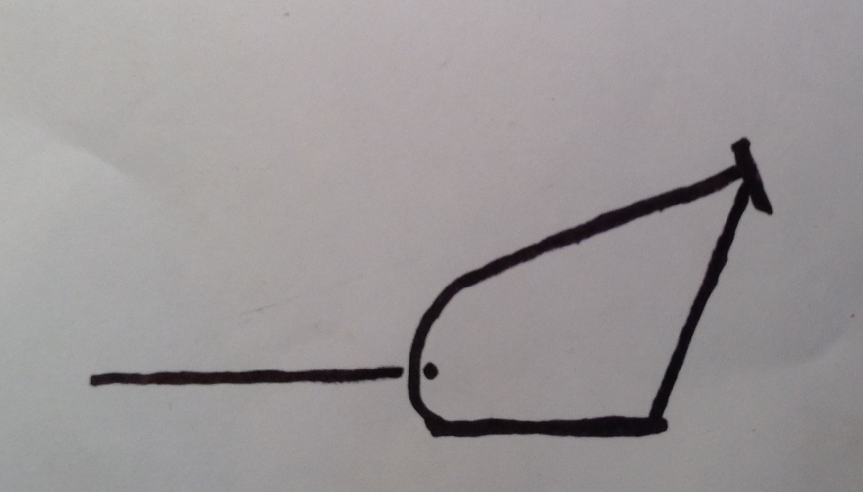

Back to a blank canvas ...... What is the optimum rear subframe design for a twin shock back end?
I'll dig out some representative pix as and when over next few days [ Hospital duties ].
However - the Commando BOTM at the header this month is a good illustration of what I mean.
The vector of the bulk of the weight [ rider ] is in line with the shocker angle.

Thanks TJ
I'm going to make some photocopies of that loop and sketch some different ideas out.
I do intend to heavily re enforce the swinging arm pivot region with boxed in gusseting and welding a spacer within to give the swinging arm pivot greater support and bearing area. I think it will easy to locate a spindle/bolt a few inches longer.
I fried my brain trying to visualise moving the existing top shock mount up and forward to allow the use of a longer more obtainable single shock at a slant, rather than vertical. However I can't see how the fulcrum/cantilever set up will actuate it from such a mild angle, it's like it need a big drop. I like the cleanliness of the single shock unit, but unless anyone can suggest a resolution I think twin shocks will be the way forward.
