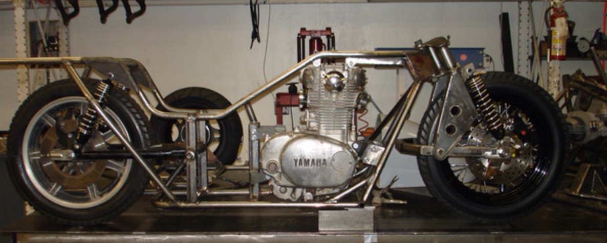

More along the theme: the last two photos are interesting solutions.

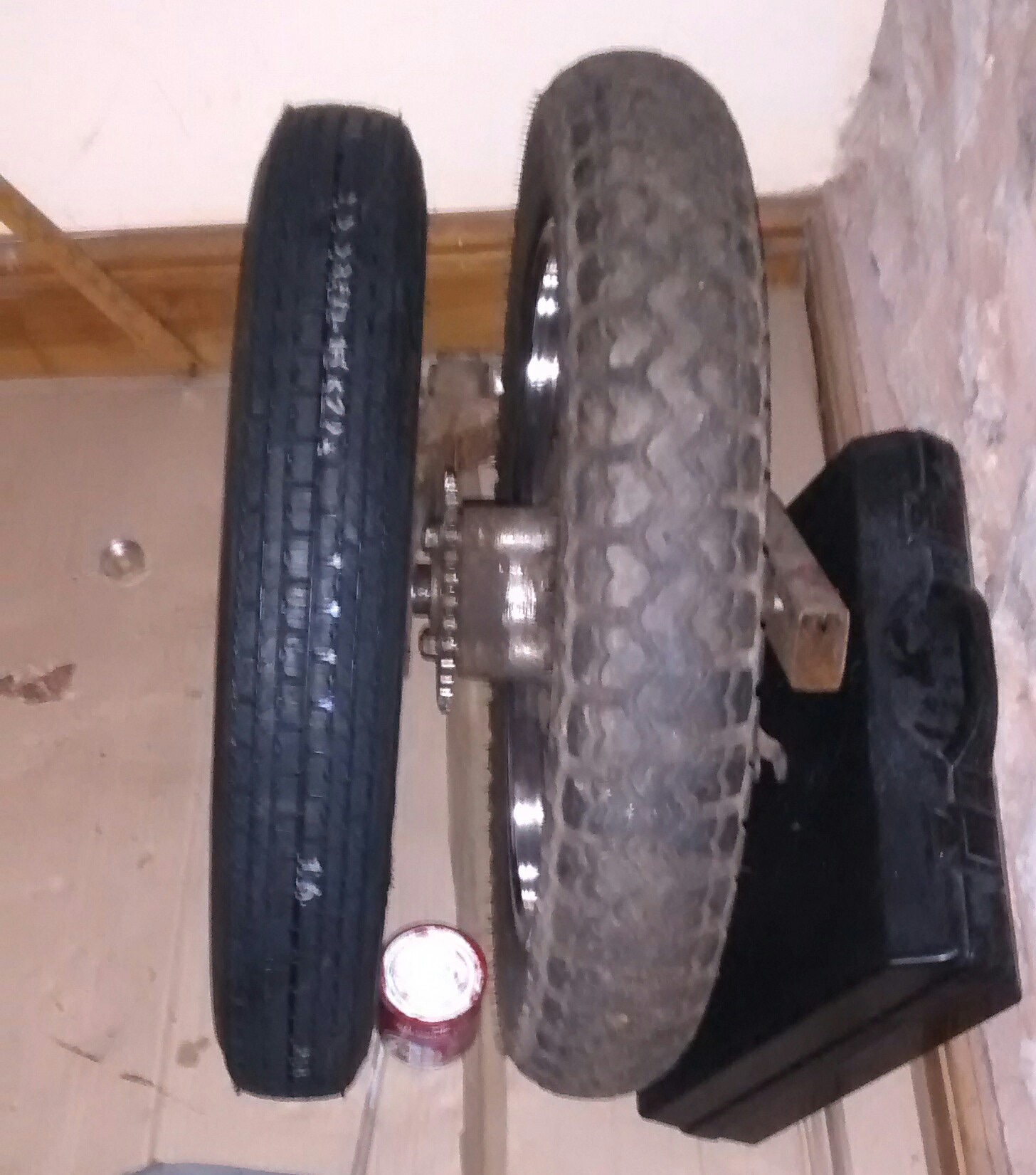

Hi Miffa, Happy New Year! Thanks for your message, when you say road trials, what is the tread pattern?
This is probably the most definitive modern take on the kneelers of the era. A certain Mr. Windle will build you one for a sack of money. 8)
Just look at those tyres !!!!!! ;)

The front is almost certainly a Dunlop sidecar race tyre the same as my ex. Kirby castoffs.
The rear looks as if it might be a new version of same.
I'll check with my pal Ben Kingham who races in several "Old Timer" series and could certainly ask the question around the paddocks.
A little bit of research has come up with Heidenau 3.50 x 16" K29 SIDECAR tyres - and they're road legal - at least to 100mph ! ;)

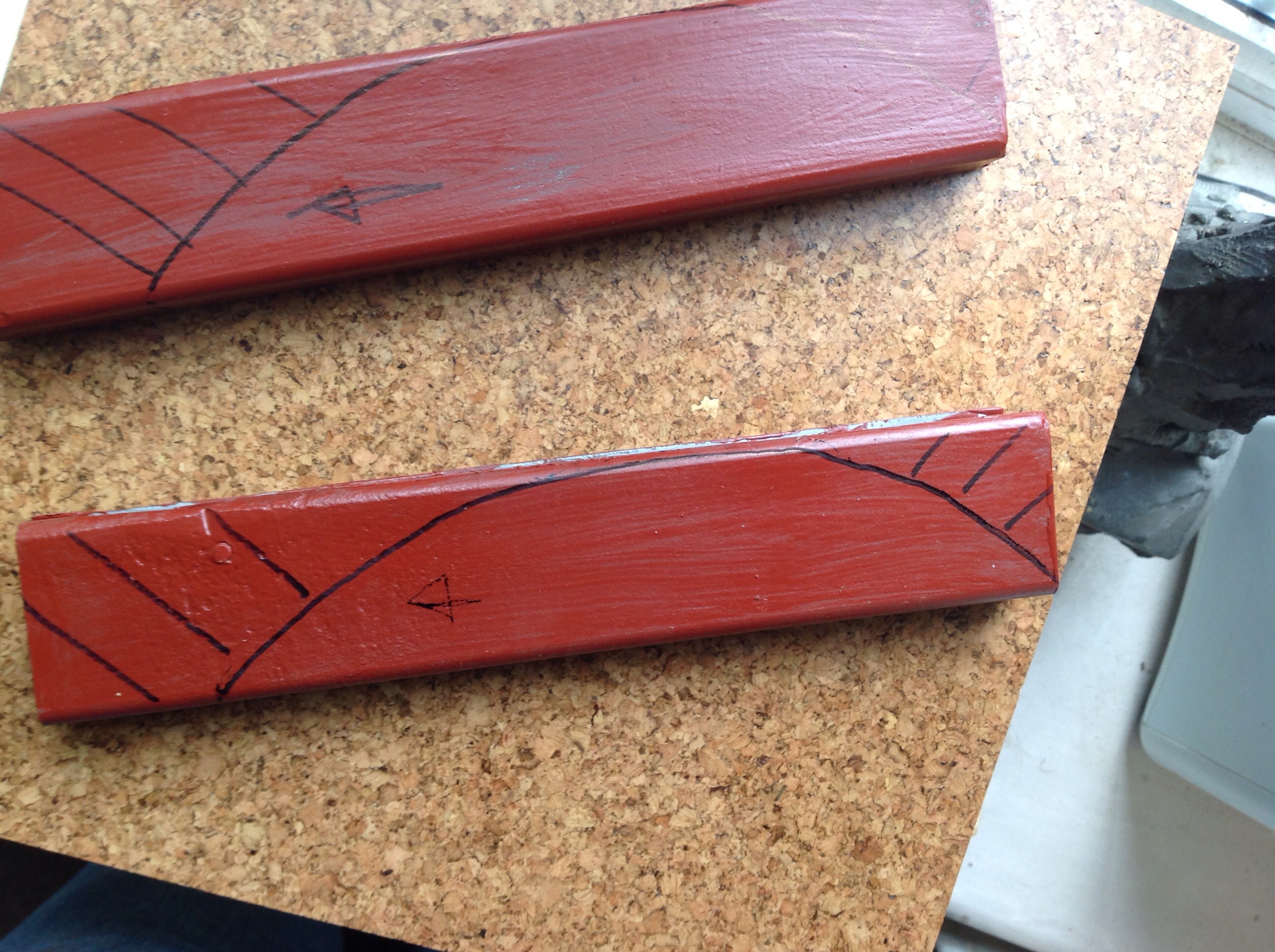

I scored a rusty old length of 2 x 1 box section from a friends scrap pile, so I've cut it up, blasted the corrosion away and starting to shape them up as gusseting for the swinging arm pivot.

I got one side of the swinging arm mount gusseted, took most of the day shaping the critter. Other side should be much faster as I took a template.

BTW - are you going to put a triangular gusset on the face of the s/arm bracket to the lower transverse cross tube?
Currently a weak point given your plans !
