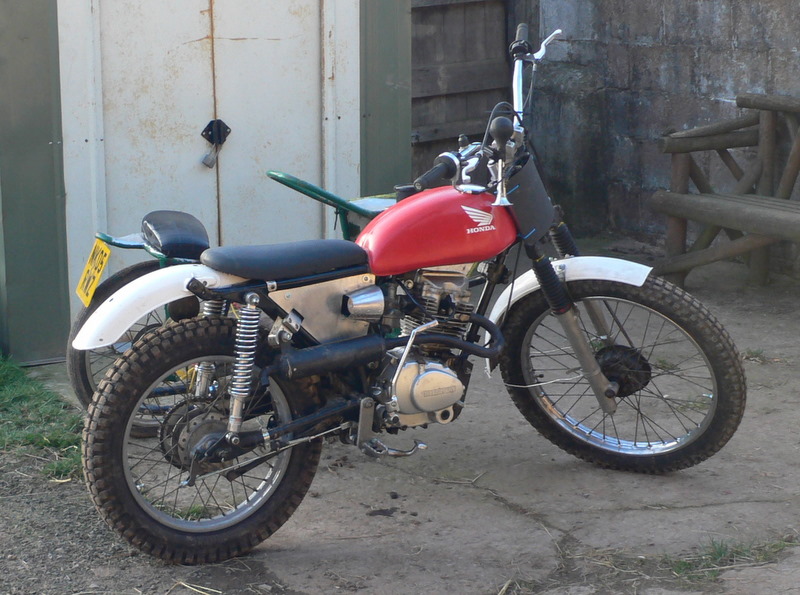

This is my bike, it has a lifan engine and pulls two adults fast enough to be scary.
Bugger all wrong with these power units!
Its got a 45 tooth rear sprocket which makes it good for 50 mph with a passenger, as fast as you can go on twisty english country lanes. I'm planning to drop it to 52 or even 60 teeth soon for a bit of an off road adventure.
