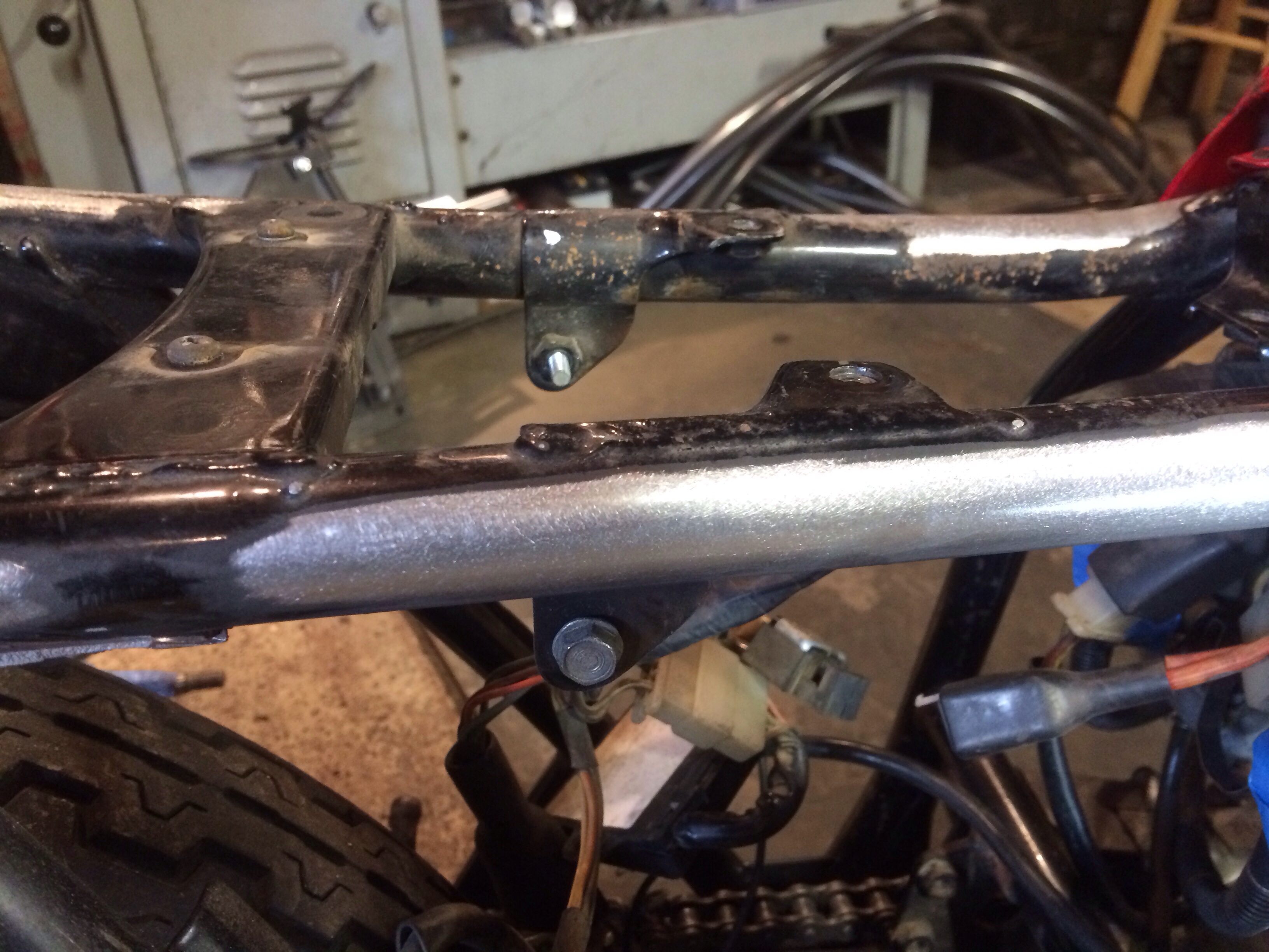

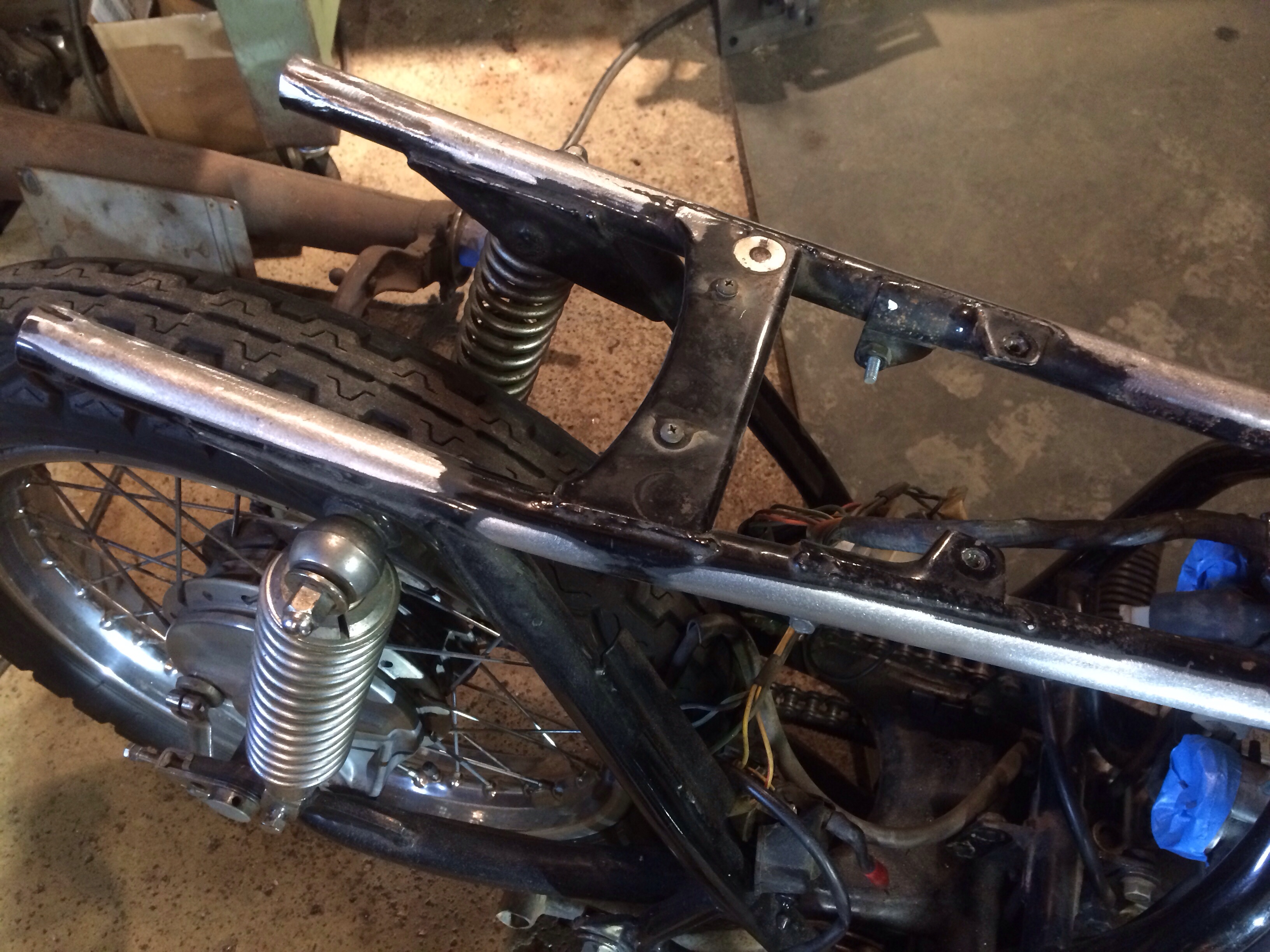

Lookin forward to more updates. How easy was it to grind off the extra tabs on your frame? That's pretty much the next thing I have to do and if you don't mind could you let me know what type of grinder and grind wheel you used? Seems like you got good results.

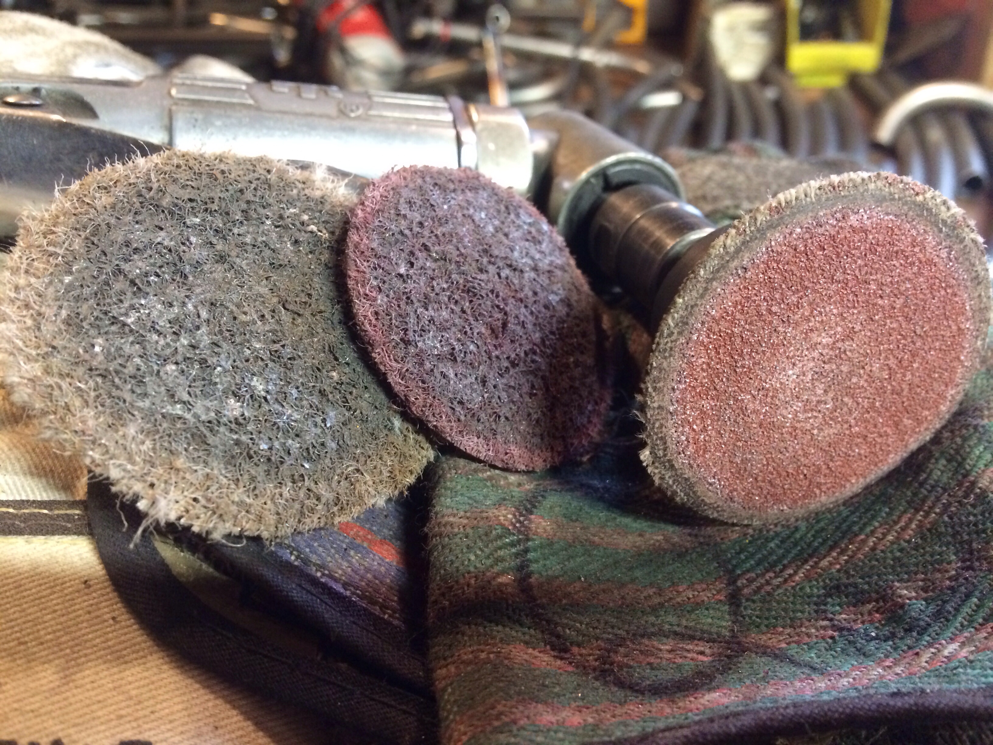

4 1/2 " angle grinder, 80 grit sanding disc and 3m Roloc disc. Harbor freight has grinders on sale http://m.harborfreight.com/catalogsearch/result?q=4+1%2F2%22+angle+grinder
Roloc are ones shown to the left.

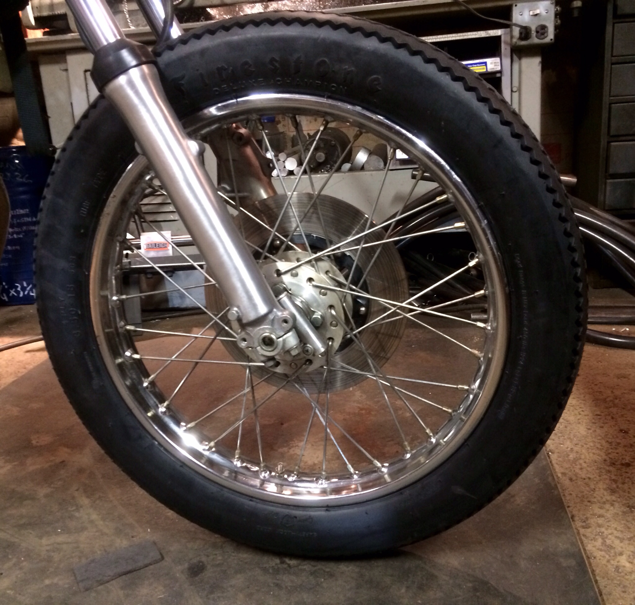

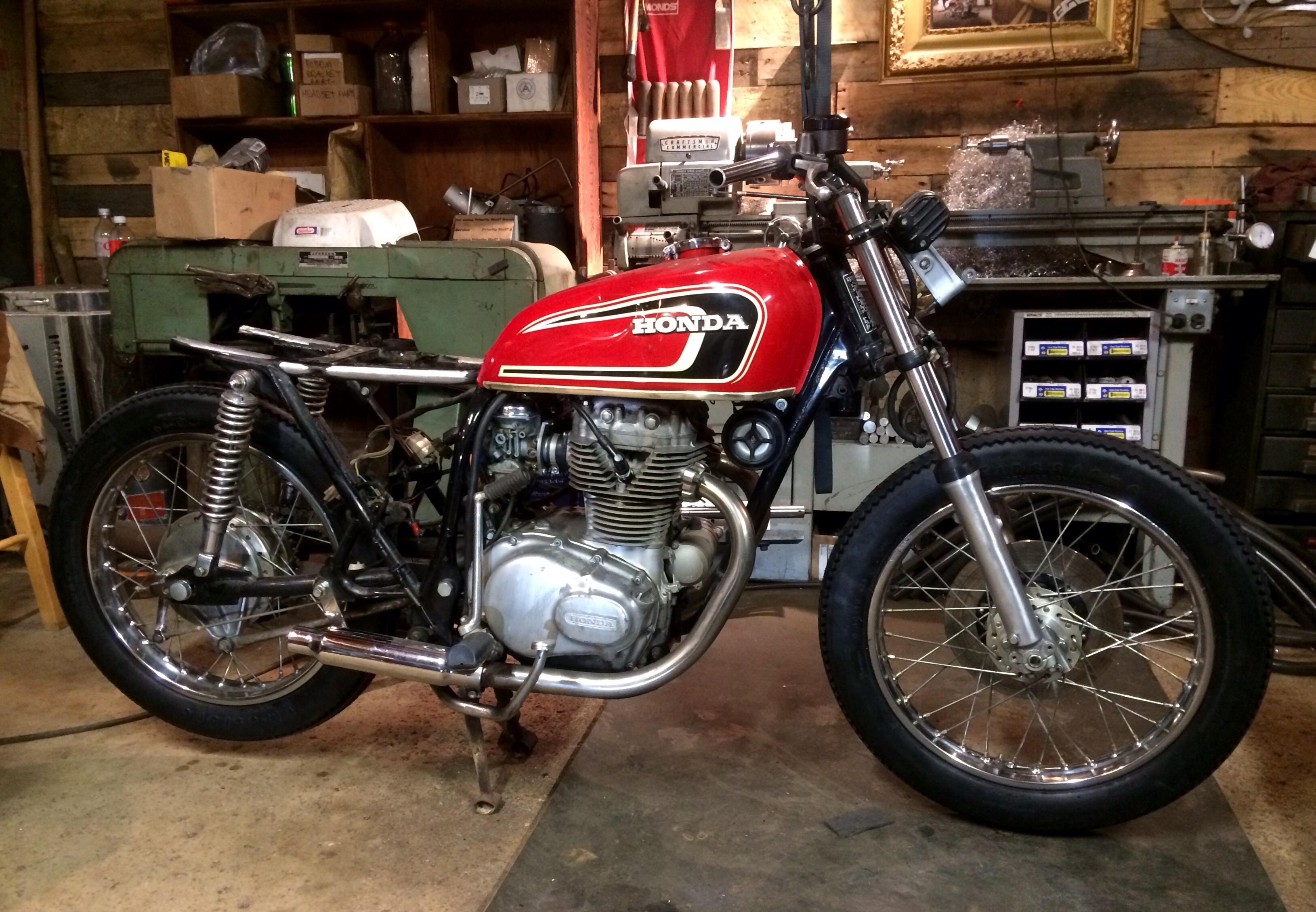

New shoes. Cleaned him up. Planning to do it proper this winter, tear down, clean, paint. For now want to get 'em on the road.

the bike looks radical ! nice grinding ! cool front tire it really helps the stance ! it really makes the bike look mean ! ready for some vrooom vrooom !! bad ass !
Yep imho that size firestone looks great on there. Sometimes I think ppl go way to big with the tires and it looks like they are riding on big ol balloons. Killer look my friend, still anxious to see this thing together!
+1 ::)
Hands down the firestones are one of the coolest tires you could put on her. I got a bunch of complements on them.
