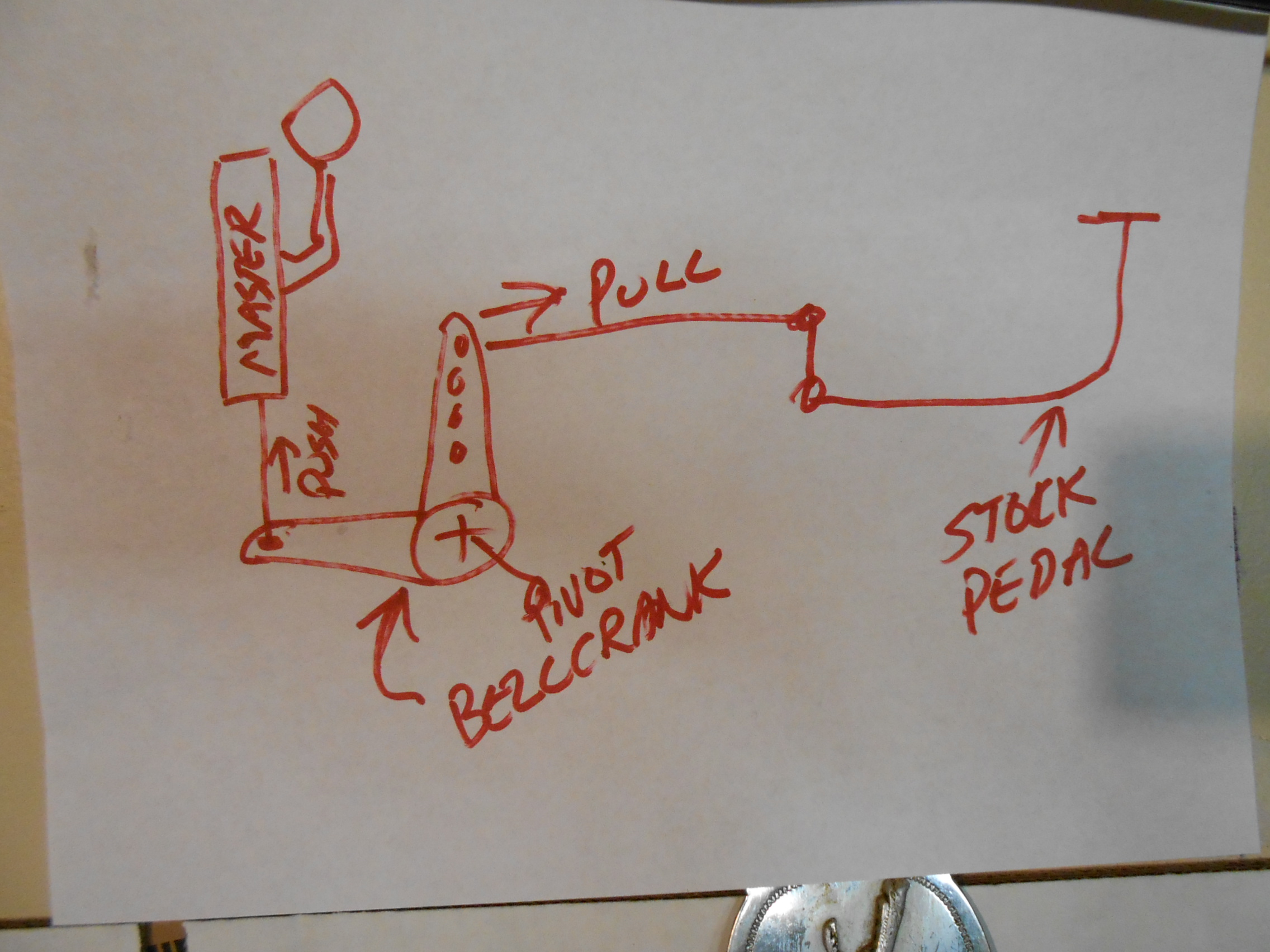

you should be able to figure this out on your lonely.
it is a simple design problem
many,many ways to do it
if you mount the master vertically behind the swinger pivot the a 90 degree bellcrank and a short pull rod would suffice

the way i have suggested is quite simple,you will be fine with what you have you can have multiple holes in the bellcranks pull arm and change leverage/feel/travel
i can make a drawing and post a pic if you like
that would be really helpful if you could. Thank you.
