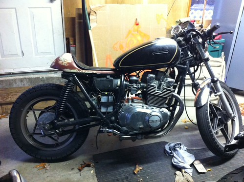

Awesome, Thanks for the info. I've actually had mine for a couple years now, got it running really well with the advice over at GSR and just this winter started modifying it. Look forward to seeing how yours turns out!

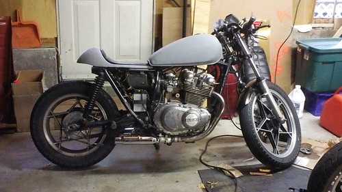

Tank lifted befor prime.
photo 3 by Emptygrace9, on Flickr
After priming, threw the shorties on with some brackets just to see how it would sound ;D couldnt wait
DSC00232 by Emptygrace9, on Flickr
Had a friend weld a riser for the gas tank. straighten out the lines a little.
DSC00234 by Emptygrace9, on Flickr
Modified a shed door hinge, and attached it to my seat bolts, then thru the mounting bracket for the gas tank. Allows me access to the air box and eventually the electronics pan.
DSC00236 by Emptygrace9, on Flickr
