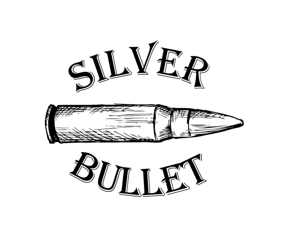

I've decided to name my bike the Silver Bullet and am going to get a couple of tank logos made up as follows. Left and right have the bullet pointing forward.
Hopefull will look OK.

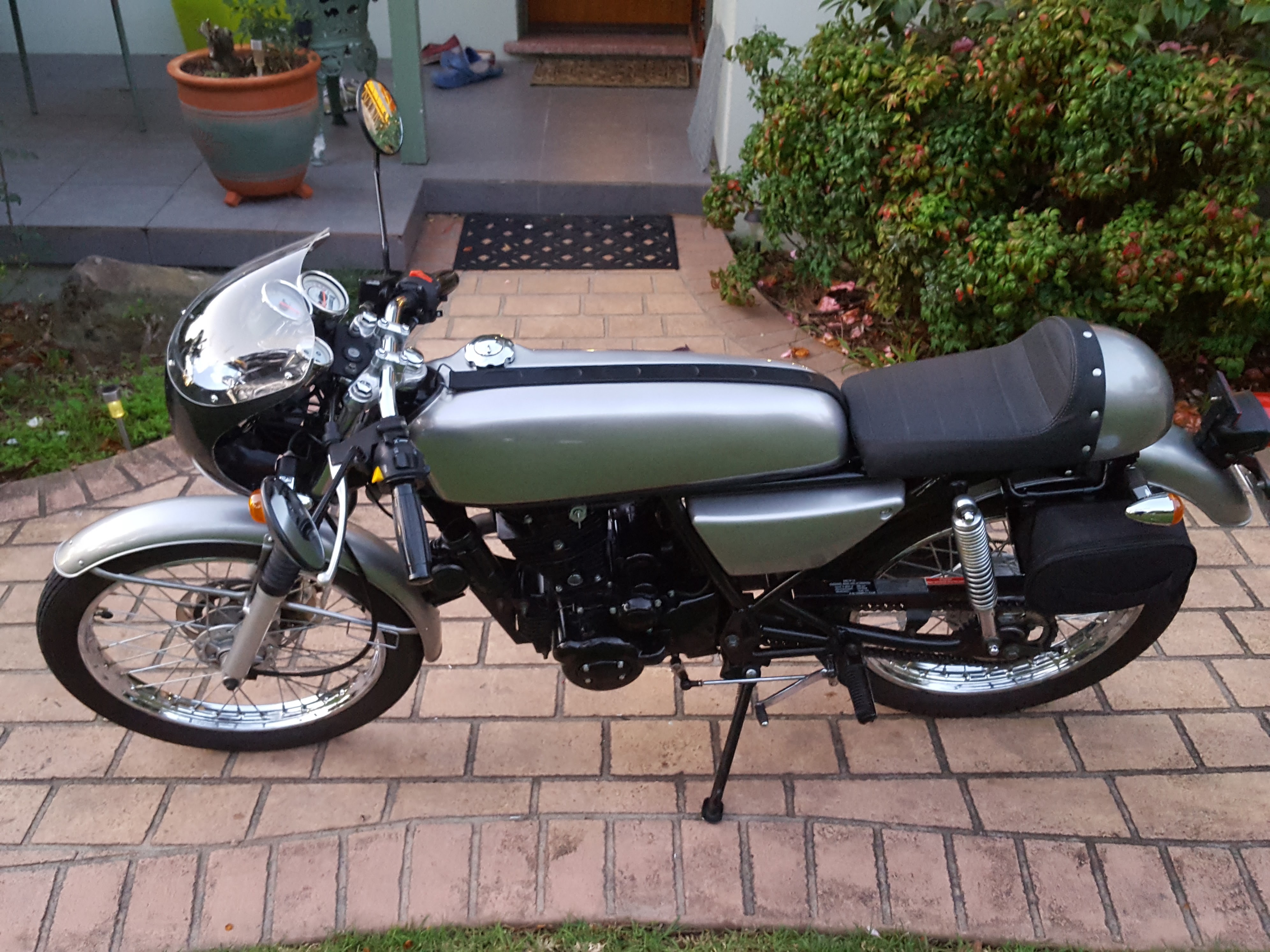

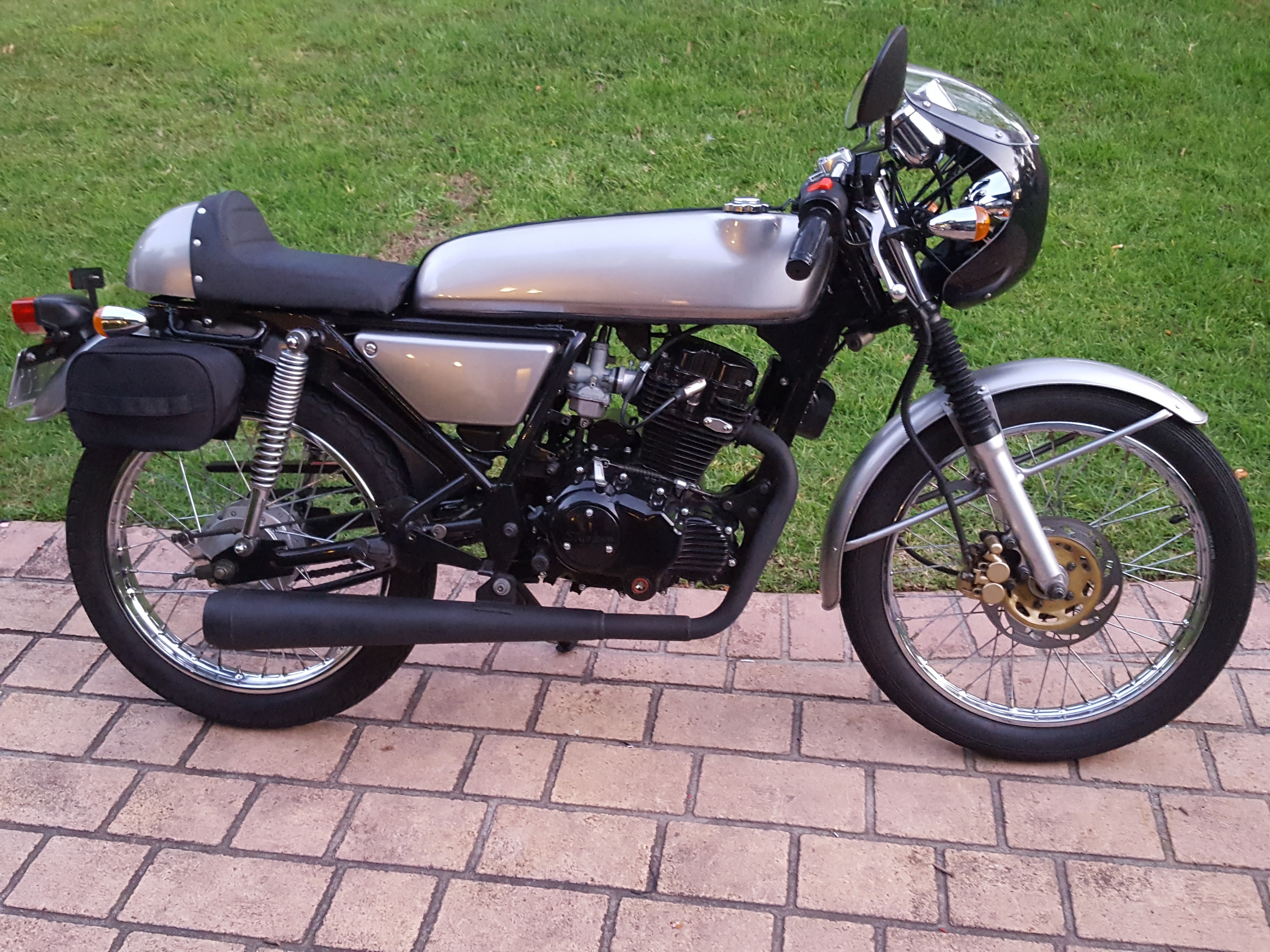

Big Saturday spent tinkering on the "Silver Bullet".
Up on the milk crate and removed the rear wheel to inspect bearings and cush bushes and bolts. There where quite a few comments regarding bearings starting to fail around 3000k and cush bushes disintegrating. Had me a little concerned given it's now my daily ride now and I'm just over the 100kgs. Happy to report that all are in pristine condition with no sign of wear. Smooth as a good cognac.
Chain and sprockets all good along with a consistent tone from each spoke.
Next was to install the tacho and bikini fairing. No problems with either. A big call out to Michael at Skyteam Canberra & NSW. Excellent service and prompt delivery of the fairing. It fitted like a glove! I ummed and arhed about painting it silver or leaving it black. Black won out at this time. Looks OK, but I may change in the future.

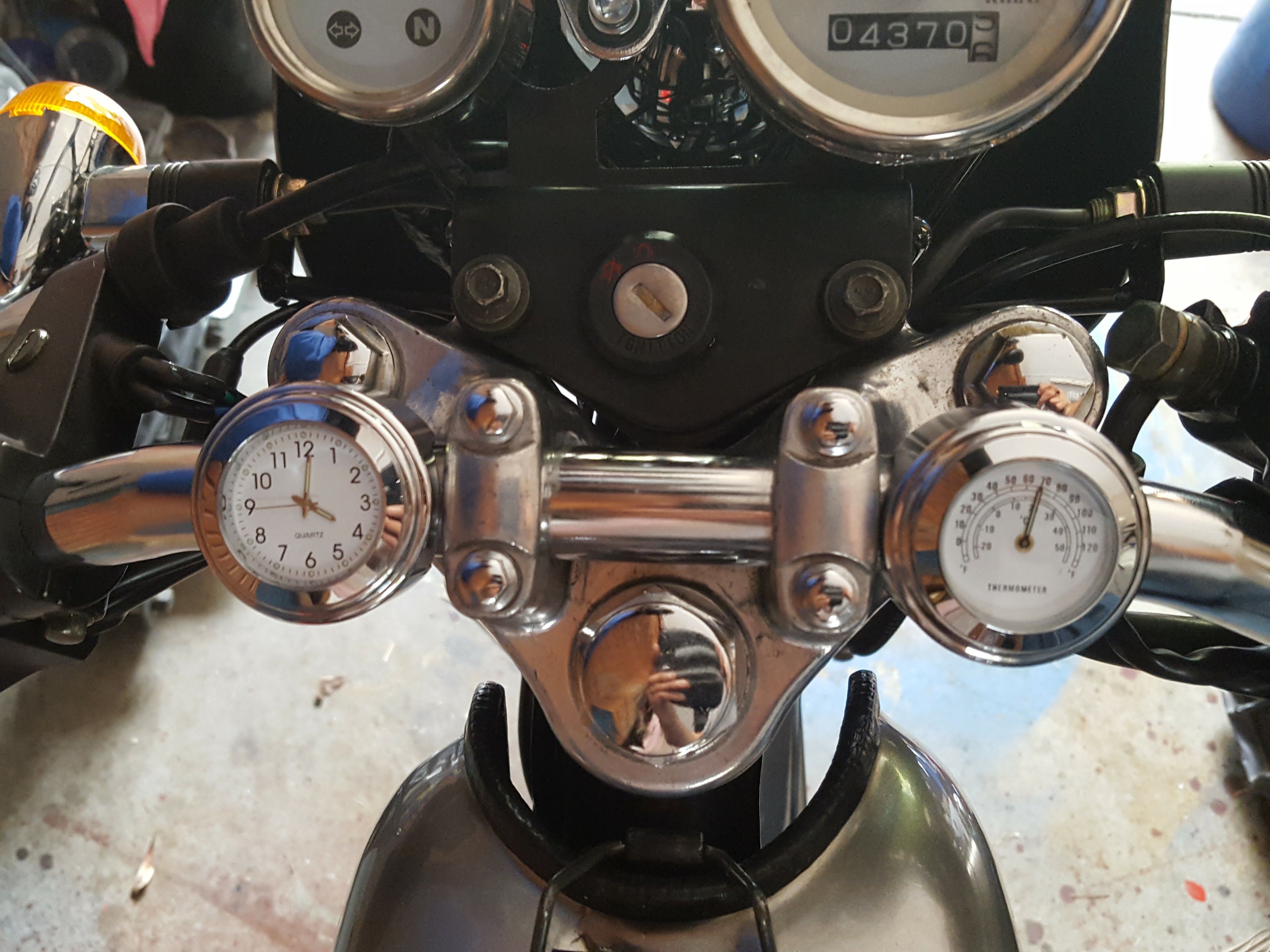

Postman Pat visited again. This time with an Iridium sparkplug (NGK DR8EIX) and my Handlebar mount Clock and Thermometer.
Now that they're attached I'm not sure that it's a bit of over kill. But at least now I know how late I'm running!

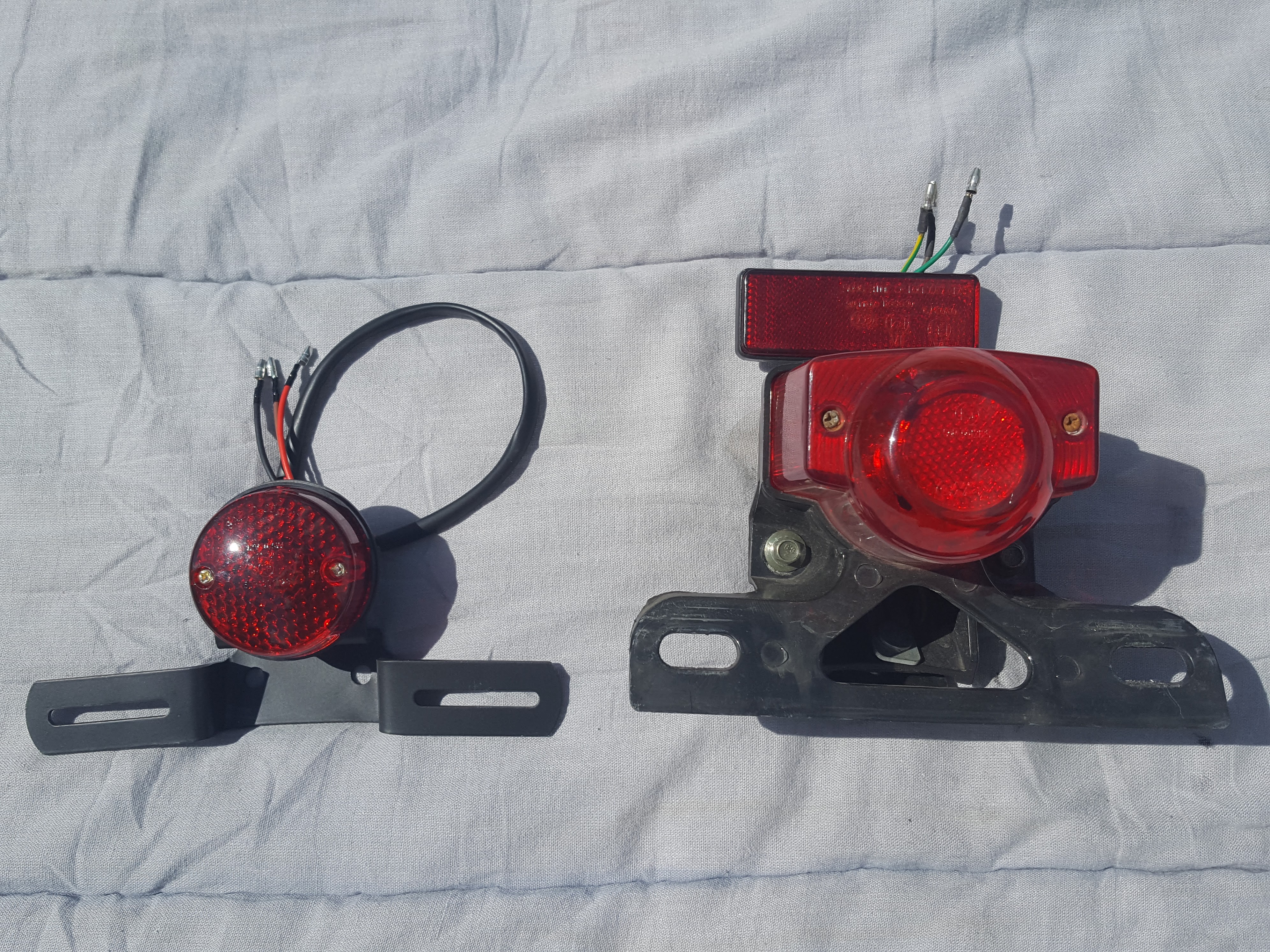

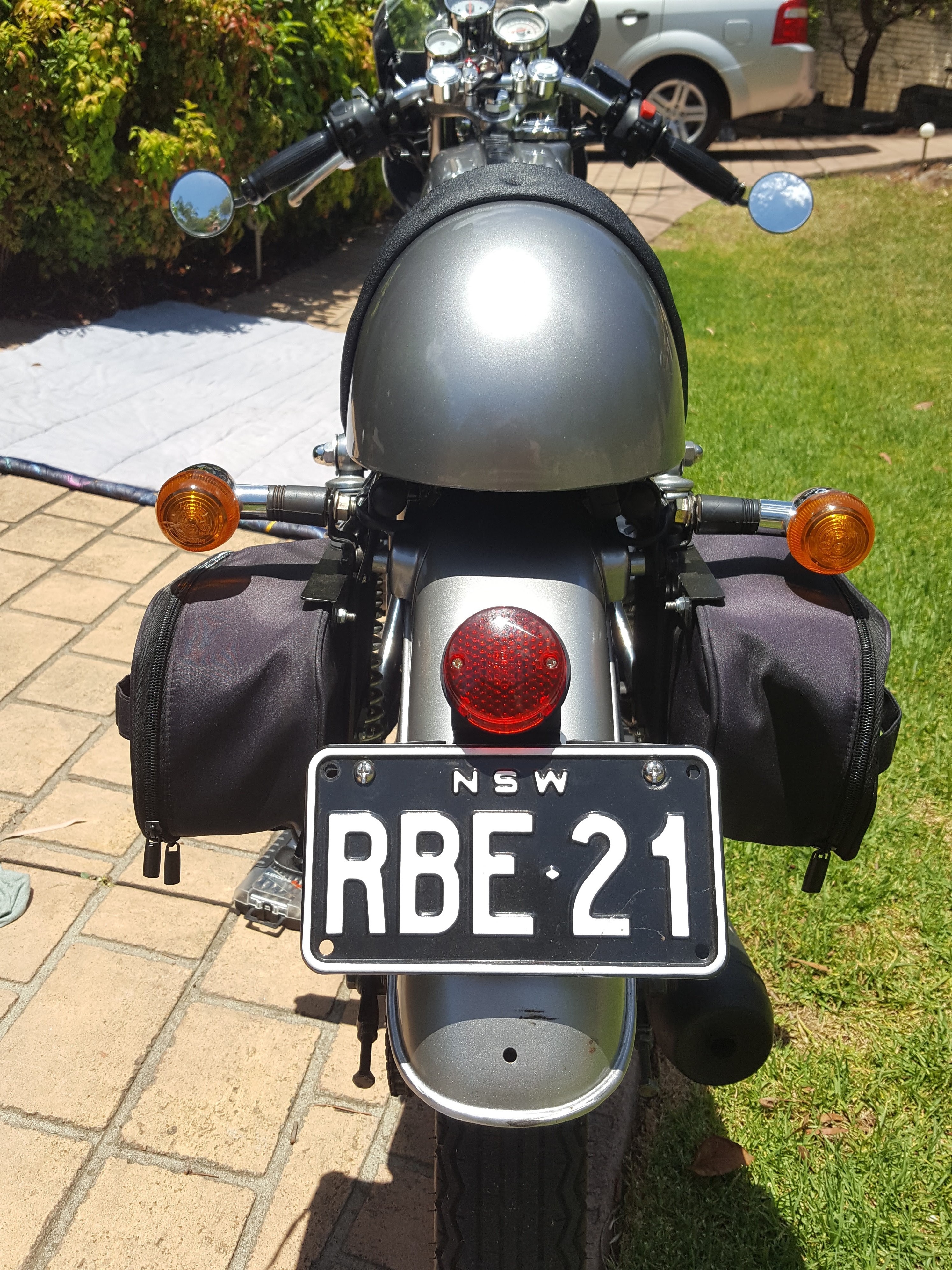

New tail light
Postman Pat is a very fine chap........ He delivered my new tail light during the week. This is a much better fit and in keeping with the style over the square OEM tail light IMHO.
Had to drill a 6mm hole on the left side of fender. Used the cable hole on the right and the light cable went in via the original top bolt hole. I attached with 20mm M6 SS bolts with SS M6 washers, rubber grommets and Nyloks.
Interestingly the original tail light loom is too short by about 50-60mm. So there's a little extension set that joins under the fender and runs through into the seat cavity to the bikes main wiring loom.
Very happy with the result at this time. Had I seen the Bate style LED earlier, I think I would have bought it instead. But this one is about 4 times cheaper.

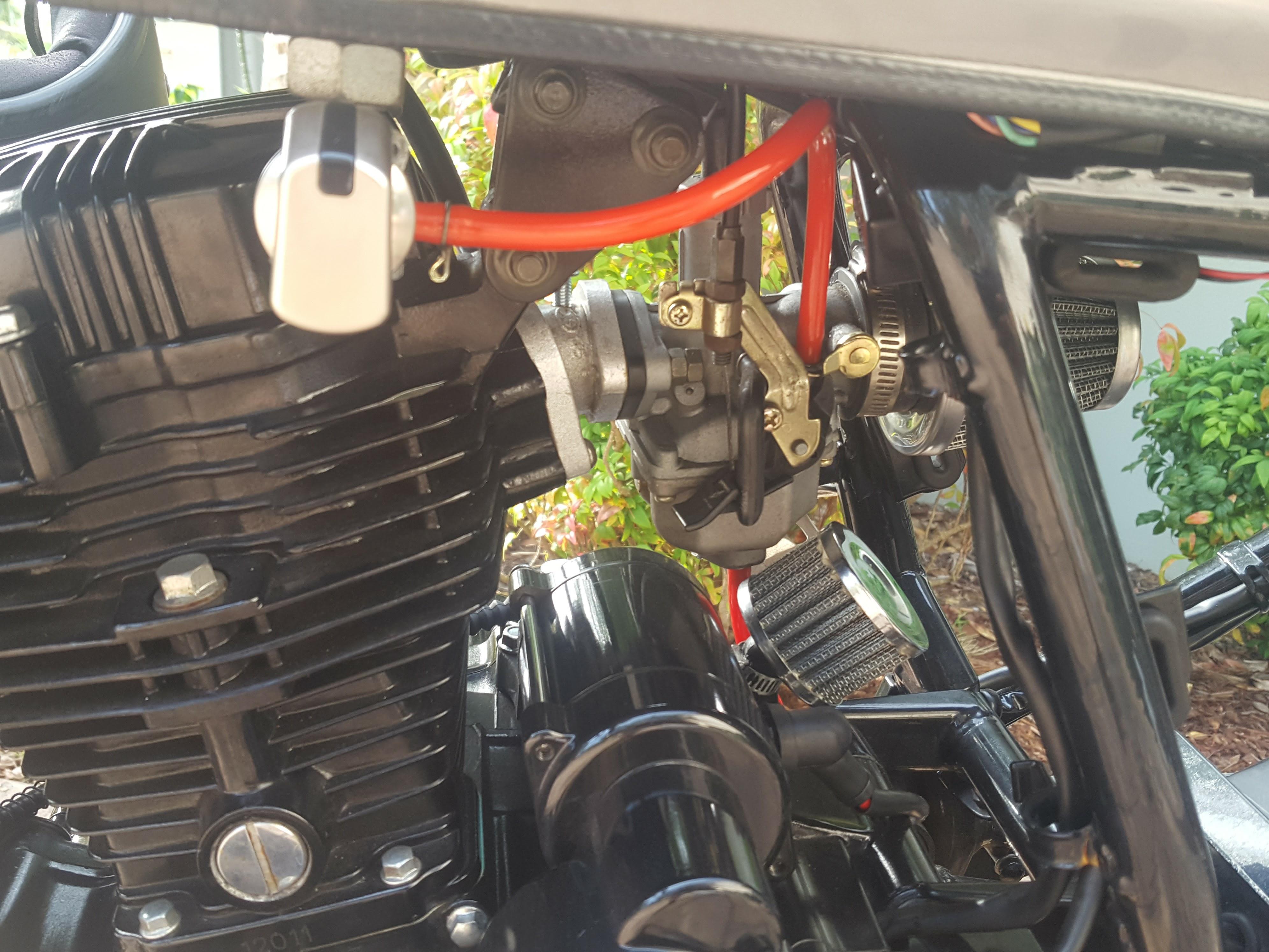

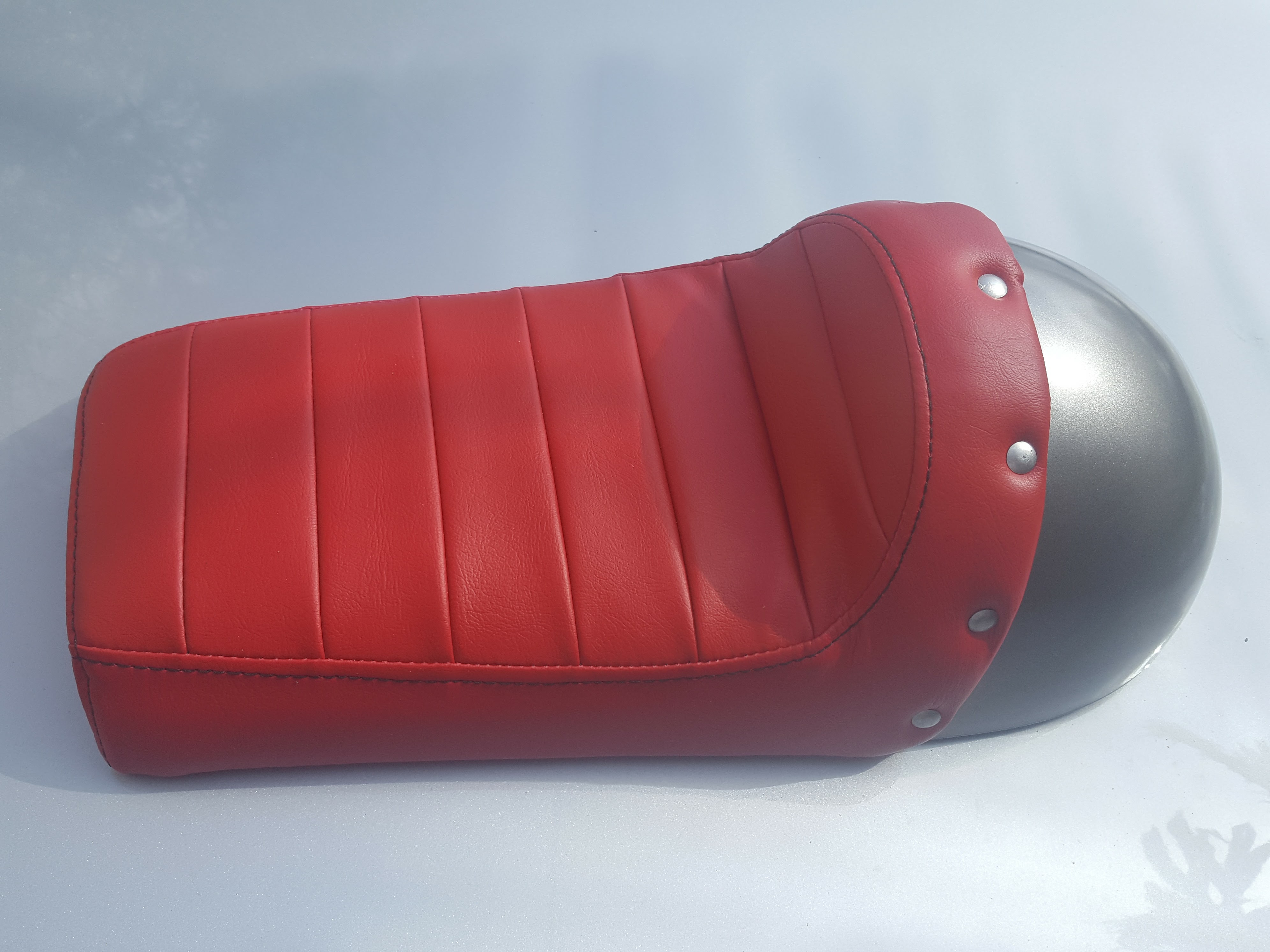

Red seat, air filter, fuel line and crankcase breather
Red seat, air filter, fuel line and crankcase breather.
Will install over the weekend and post some pics
