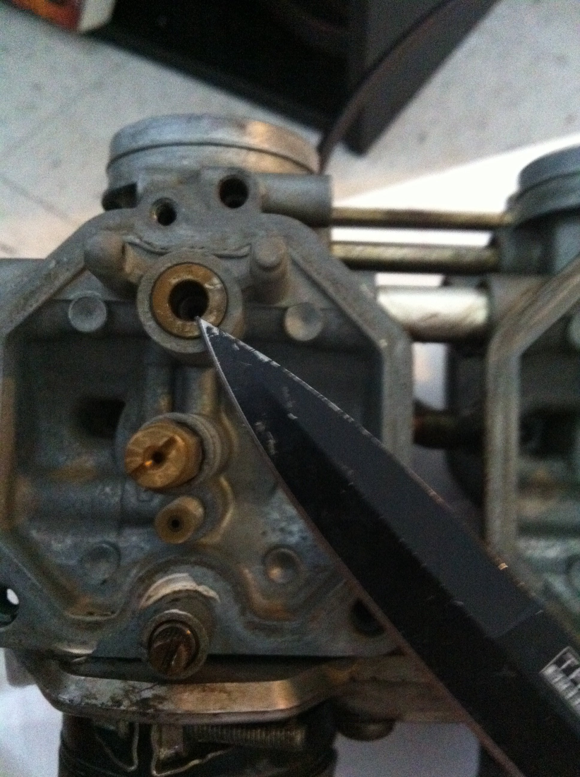

Floats are all pulled. All needles are pushing back with force. All needle "rubber points" are smooth and should be seating correctly on this side. The only variance I see is on #1,copper "needle insert" has discoloration compared to other carb bodies. Pic is attached. Next I will remove these and check them. Any advice on tool or how to remove other than carefully and with wd ;) thanks guys!

First pic you posted looked like the throttle shaft?
If you have fuel coming out of there the bike is upside down ;D
Don't mess with the float seats, unless you really want to buy new carbs, they don't come out and you can't get new ones
You'll probably have to remove carbs from mountings, real PITA when that happens, plus, I think the 'O' rings are a weird size so only available from Honda at exhorbitant cost >:(
If you get one that isn't damaged you may be able to measure it, or, you will get an answer on SOHC4.net
They are metric so doubtful if you can get them 'local' ?
Yeah all those little connectors have 2 o rings on each end. Probably pretty buggered at this point. Pull them apart and replace.
