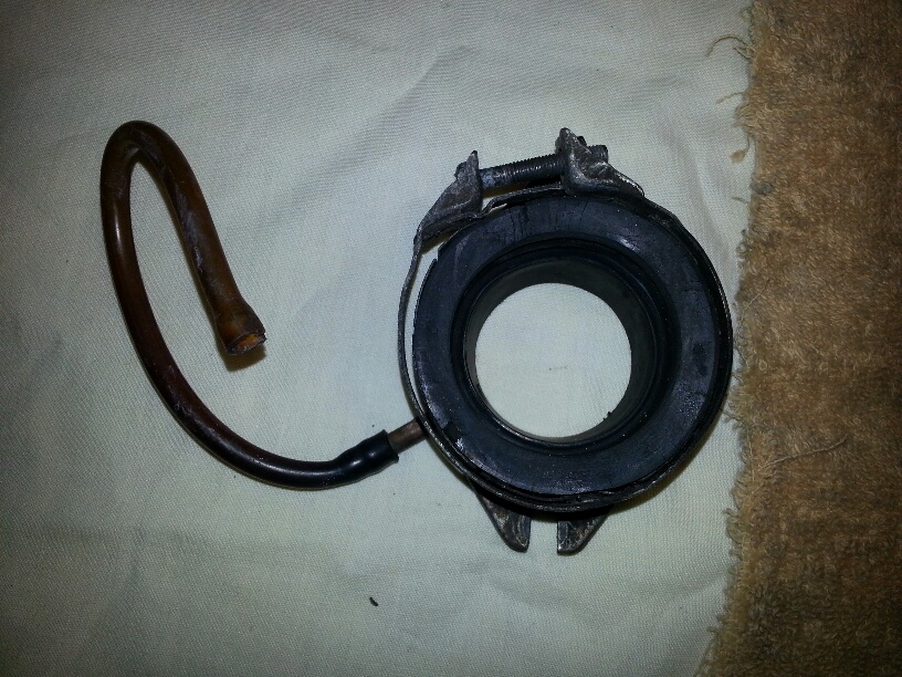

Also check the rubber o ring which is used in the rubber boot connecting the carb body to the engine. Both of ours were torn up causing the bike to run lean. Tough time starting too. We did a full carb rebuild with a new kit, but im beginning to wonder that the o ring was all that needed to be replaced. I'm picking up a set later today, and I can mail you a pair if yours needs replacing. Also check the air tubing running to the top of the carbs for cracks as well.

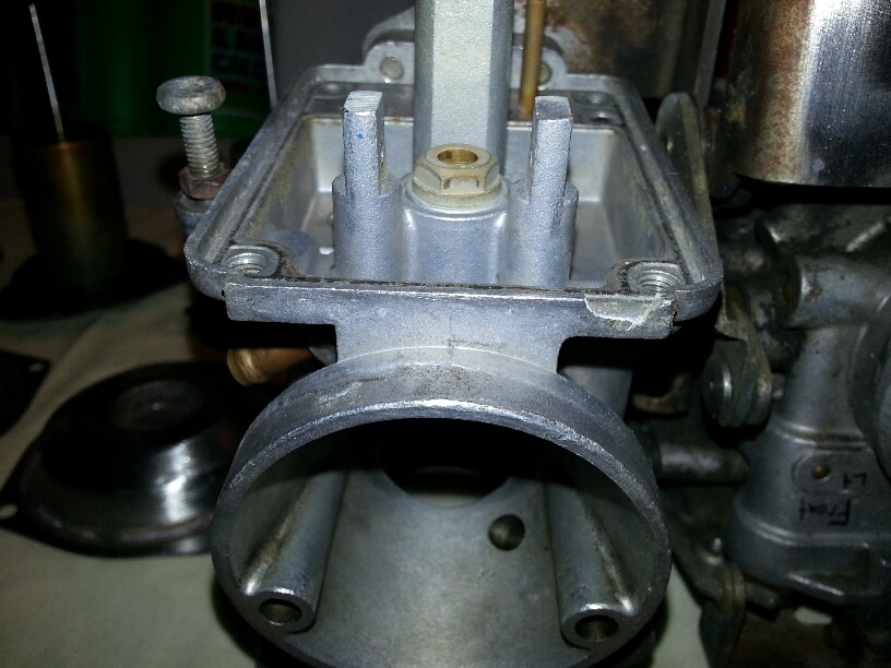

About the carb! Ill upload a pic. I literally looks like its been dropped. It been damaged both on the externals, and who ever was thinking of adjusting it..... Well I think they were smoking too much of the Ganja......... ;) not that that ever hurt... except they really hurt the internals as well. It might be possible to salvage it. But I thought since this is the main part of the engine. I should have a proper intact carb, without the fear, of burning to rich or lean, or leaks of any kind!
I will think about cleaning them and looking at the needles, but the one, as you can see clearly, jiggles about and when turned doesnt come out... IN or OUT.!
BADNESS!
I wish I was a mechaninc with years of experience. But if I was..... i would probably say..... YEAP new carbs are needed.

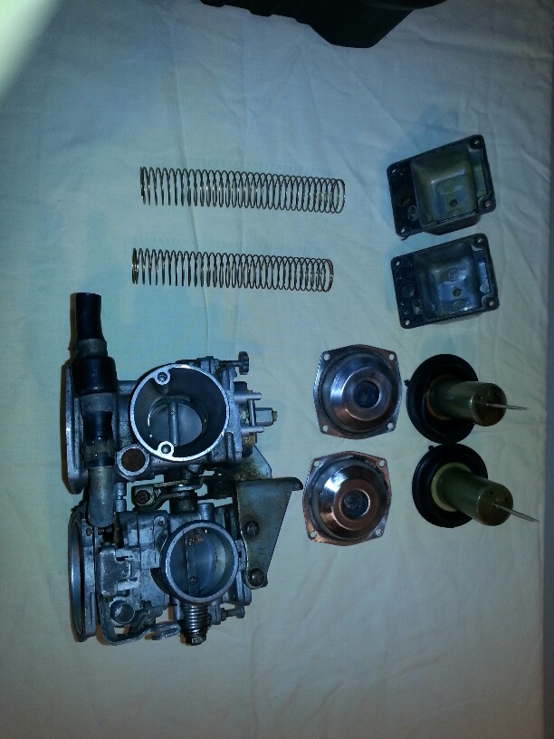

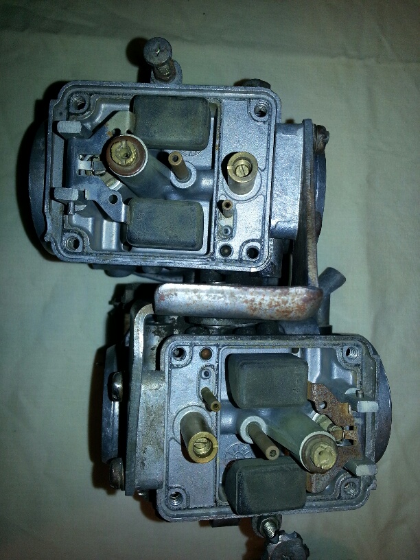

Ok so here is what I really think, now that Ive had the opportunity to examine these carbs, with out fear of the big bad parts man coming and beating me up for not just bending over!
I think there is nothing other than a cleaning, and replacement of key equipment, such as jets, and floats. The diaphragms look ok to me, the one gasket on the right bowl needs replacement as well.
So I just need to buy a carb rebuild kit, or what ever its called. Do some boiling in lemon water, and carb cleaner. With a blessing from the round Buuta!
Rebuild it and set the jets to original stock level, not that the bike will be stock after im done! but for now.
I think 2.5 whole turns is the right amount. But im problably wrong, but im sure Ill be notified shortly. So without further Yakati smack here are the pics.

Parts look good. A carb rebuild kit will be about $50 and comes with the jets and the gasket. I think the gaskets themselves were just $10 if you just want those.
The "jet" you were referring to should be the fuel mixture screwn and should be 2.5 turns out from a soft seat. (Its the only screw you can access when the float bowl is attached). The other jets are all screwed in hand tight only.
Can you check the other side of the carb boot (last pic) and theres a little round gasket that runs on the inside. Make sure its intact.
Also make sure the rubber diaphragm isnt torn.
You can test the float bowls for leaks. Dunk them in water (gentlyl and look for bubbles.
And this is out of curiosity.. the main jet nozzle (long brass tube with holes in it).. Can you count the number of holes on the sides? Its like an alternating patern of 2-4 or 2-3.

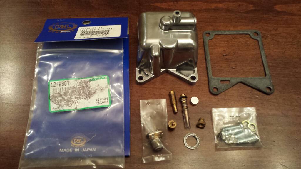

Actually between our two carbs there does seem to be a difference with the bowl shape. You can see it in the gasket. Also showing the KL carb kit I got.
Sent from my SAMSUNG-SGH-I337 using Tapatalk 2

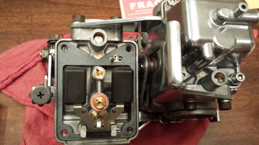

Here's the key:
index.php
Your carb has a pressed-in tube in the center where Mike's is a screw-in. Unscrew the idle air screw as well and you'll see that it's shaped much differently than the one in Mike's pictures.

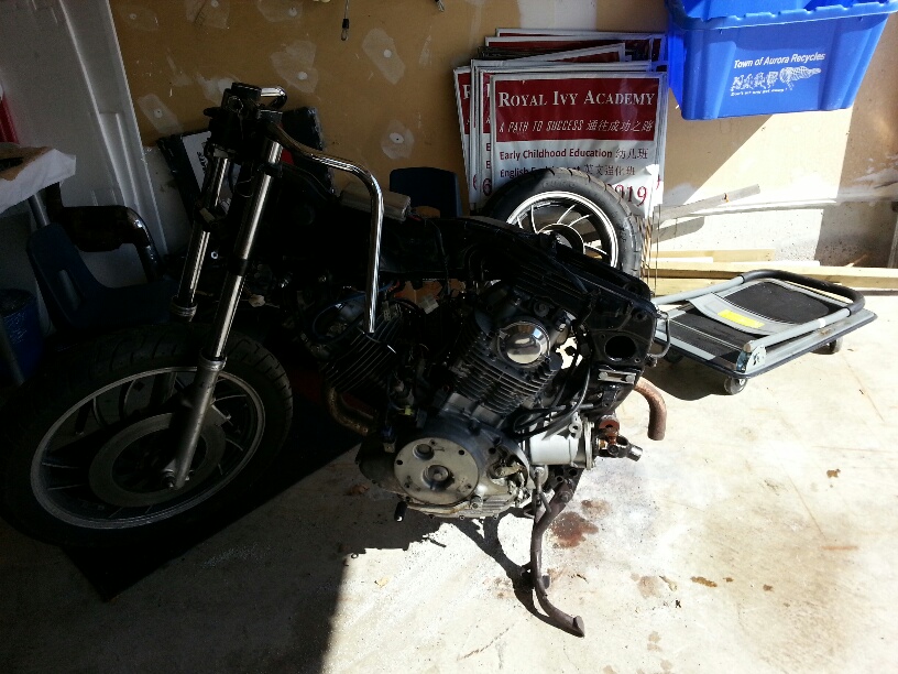

Ha. My XV is torn down to its component parts right now for finish work and a front-end swap from a Ninja 500. Imagine it spread out all over my garage in boxes and on shelves.
Im just restoring my friend's virago to get it road worthy. Nothing much to look at. Here's a shot of the garage though. Yamaha is outside.

Im getting confused on the carb generation thing too since we both have the same year bike. Anyways I did a search on ebay, and there are some kits with a gasket shape that will fit your carbs. Maybe look at the pieces you removed from your carb, and make sure that they all match whats listing on the posting. And maybe ask the seller if you are getting what's pictured in the ad.
Everything here looks identical to what I have, except for the gasket of course, and the pilot screw, which I think Ard mentioned.
http://www.ebay.com/itm/111093193186

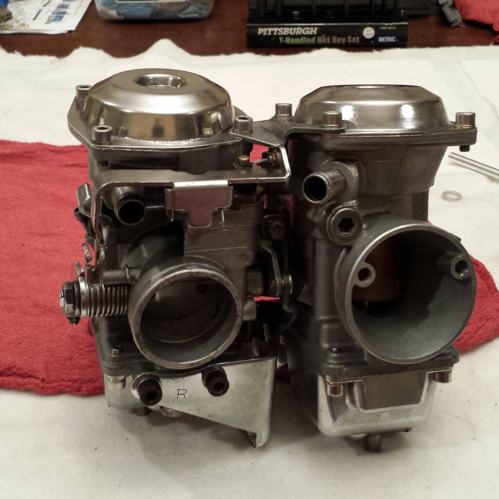

OK, update.
Today im stewing my carbs in Pinsol, the miracle.... bringer backer of Carburation!
Boil and bubble away. my today day mission to bring back what was once lost!

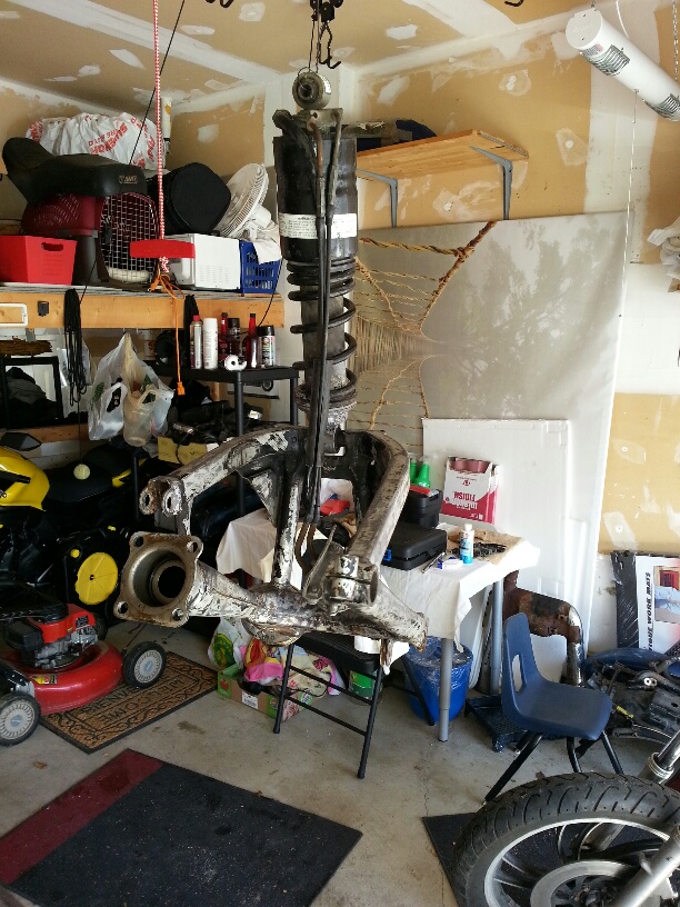

That and finally got my swing arm off. Was a real bitch! But the real man won. Fair and square. :)
Here are the pic I took during my OPERATION!
Ubergeez
