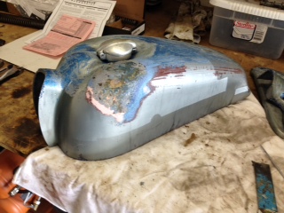

Here is a pic of the tank as it sits.

Re: Paint and 2K Clear? On Fibre Glass Gas Tank
as others have said, spraymax will spray nicely over the duplicolor.....but def don't sand the color as that will show in the metal flake....just get the clear on within the re-coat window when you're spraying it. Usually 15-30mins after color you can lay your clear.

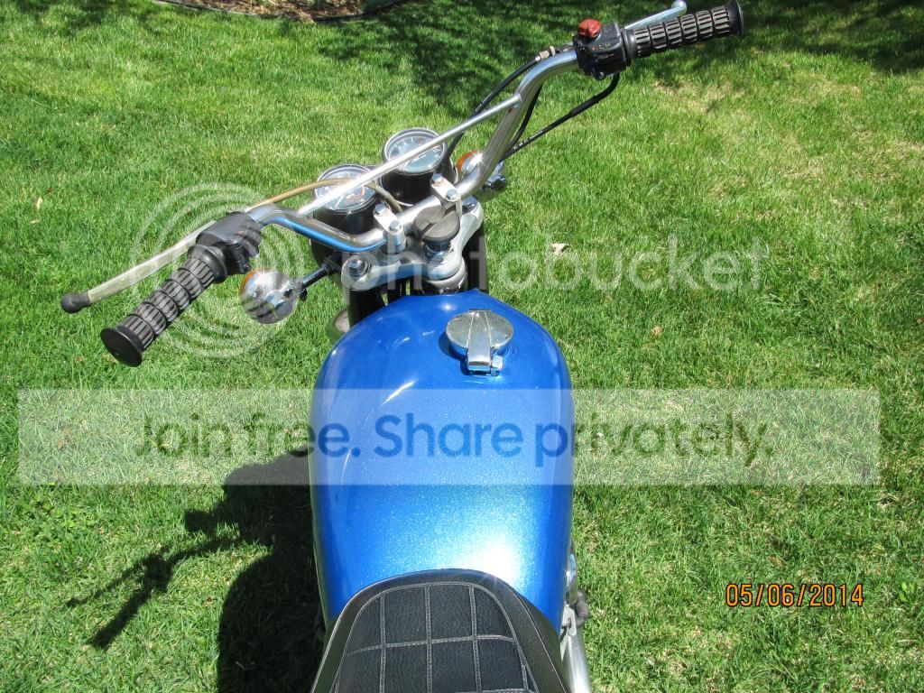

Here's a cb350 I did this past spring using the Metal Specks and SprayMax. Really liked the way the Metal Specks went on. Put some decals on, then cleared over it all. Done within two days over the weekend.
Thanks for those pics! Good to see what the blue actually looks like. I hope mine comes out that well. My tank was originally blue metalflake which I think was in the gel coat.
