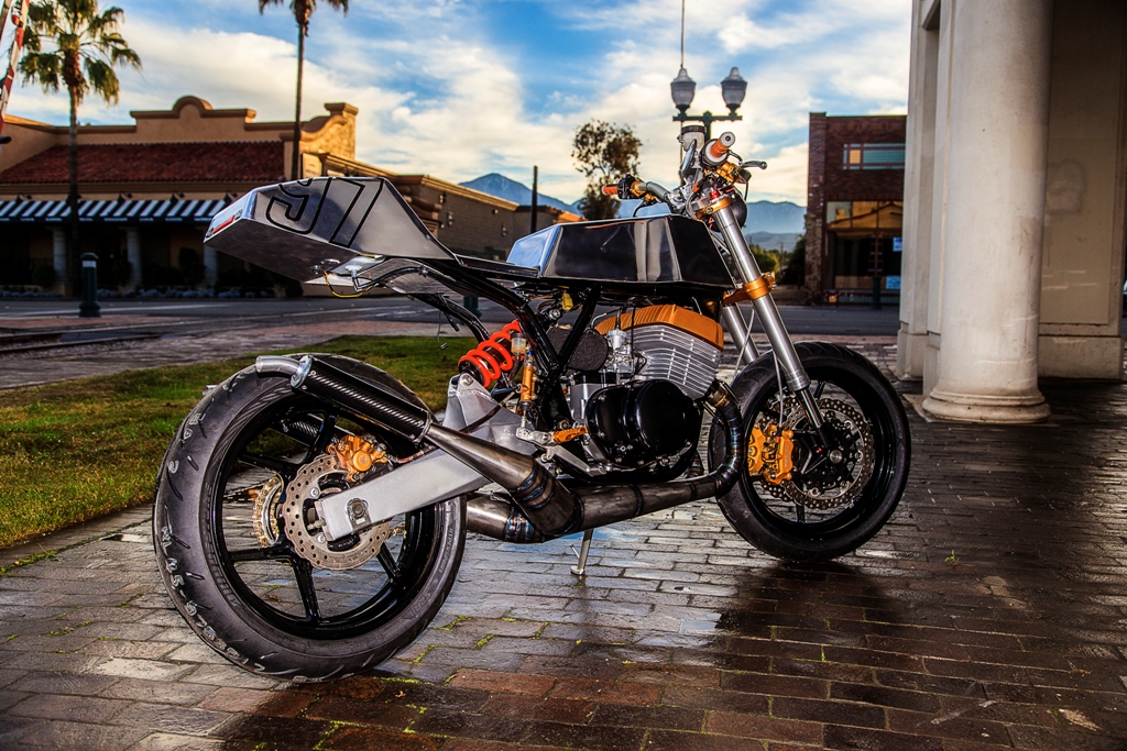

Ryan, I made my own expansions too! About $35 for materials and $150 for the carbon silencers.

Jeezus.that bike is insane.
Wow.i'm planning on doing that too :-)
If i do something on my own i try to achieve the best i can do,results will never look pro but i know that i learned alot along the way.
I prefer building bikes like the Suzuki over restorations just so that I can build everything the way I like it.
If you look at my build for the Suzuki you will see how I built the expansions. Good luck and I totally agree about making your own stuff, much more rewarding.
