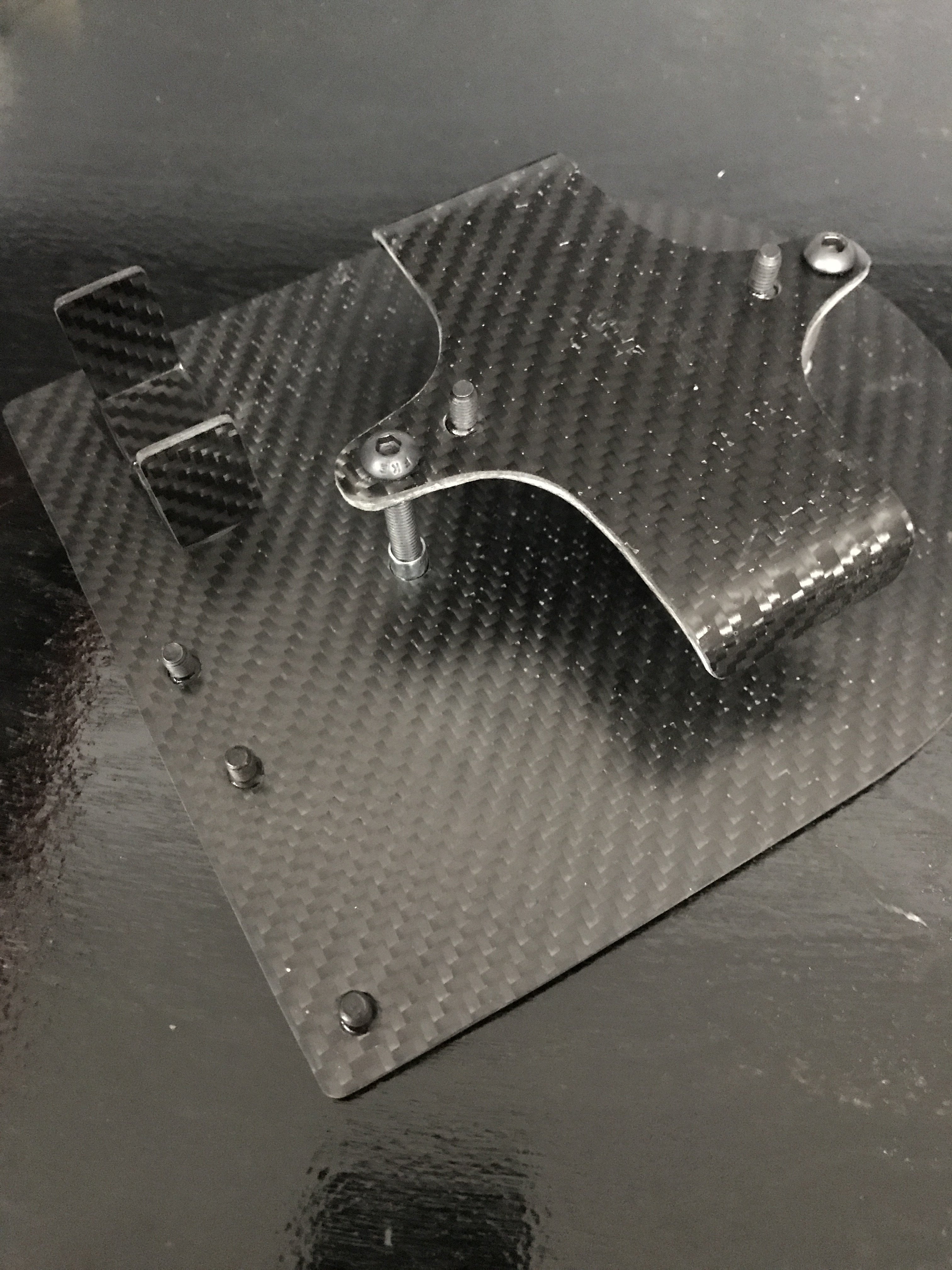

Most if the lbs were lost due to carbon fiber. The 4 seat bolts weigh more than the seat. Here’s a pic of the battery/electronic mount under the seat.

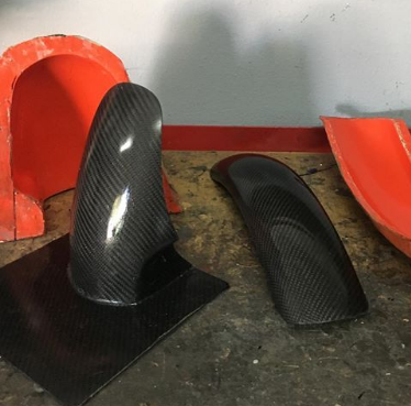

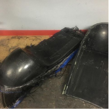

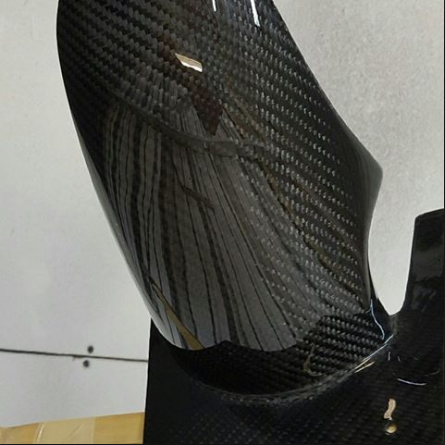

some progress pics from making the carbon fiber parts.

CrabsAndCylinders said:
It would be great if you could document as much as you can. Do you have any advice on building with carbon fibre?
Brian
Advice? "Don't do it" LMAO
First off, I don't build bikes for a living, and I don't work with composites for a living. So don't think for one moment that I'm an expert. "Jocelynne" is the 3rd carbon fiber bike I have built. Mistakes are expensive. So heres what i learned.
1. you'll need a proper mold. any youtube video can help with that.
2. NO POLYESTER RESIN. except when making the mold
3. never use a paintbrush, always a squeegy when applying resin.
4. start small: hand layups on front fenders is good practice
5. easier to design a paint scheme and hide seams than try to make complex parts from one continuous piece
good luck
this rear hugger is seamed at the 90 degree angle. if not you get weave distortion. if you look at the seat you can see the seams which is covered with the seat pan on the finished product.
