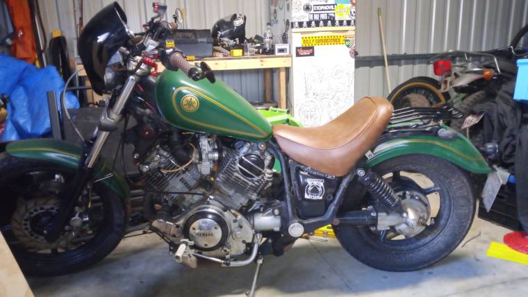

Still not done but when are we ever really finished.

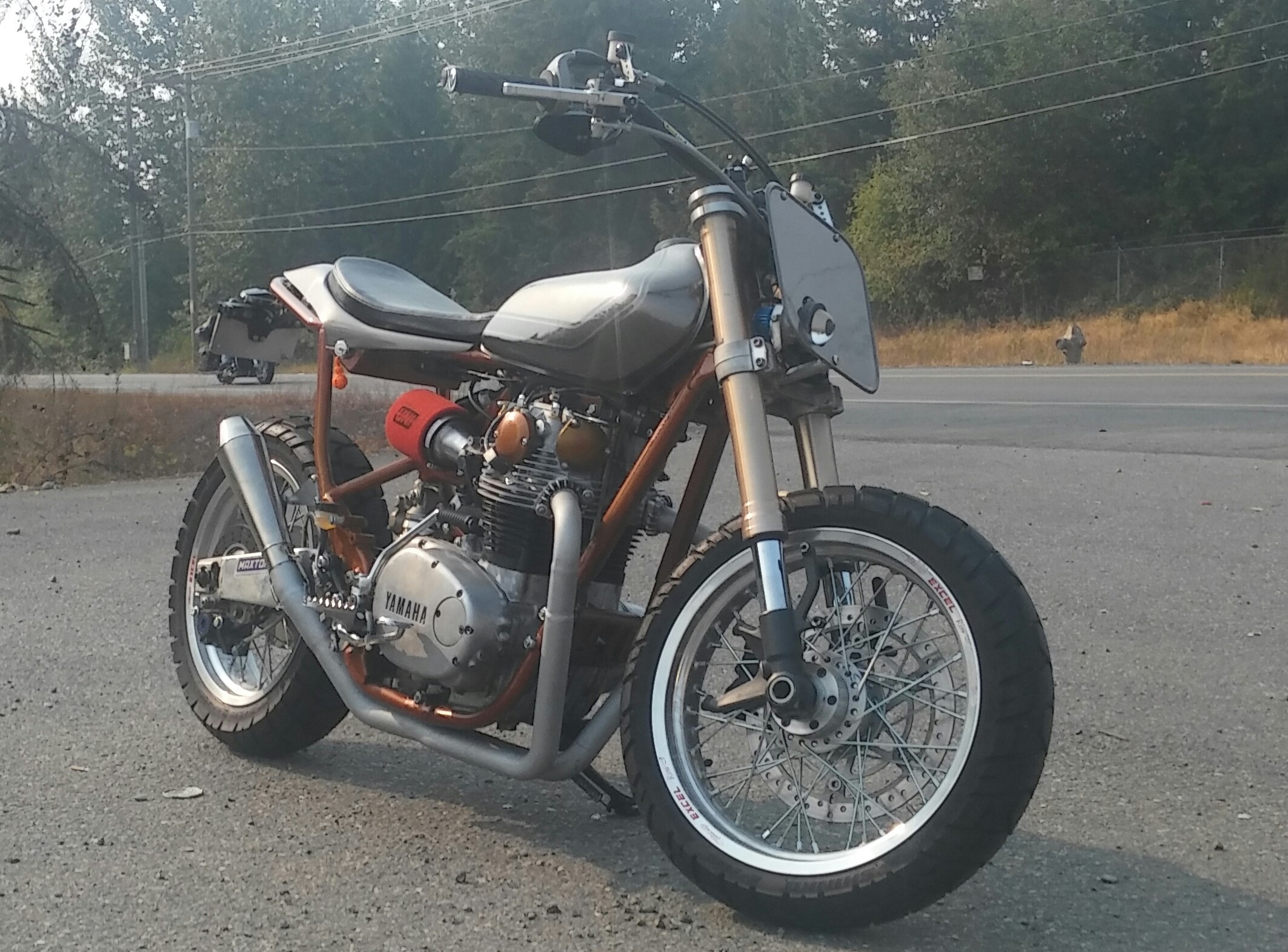

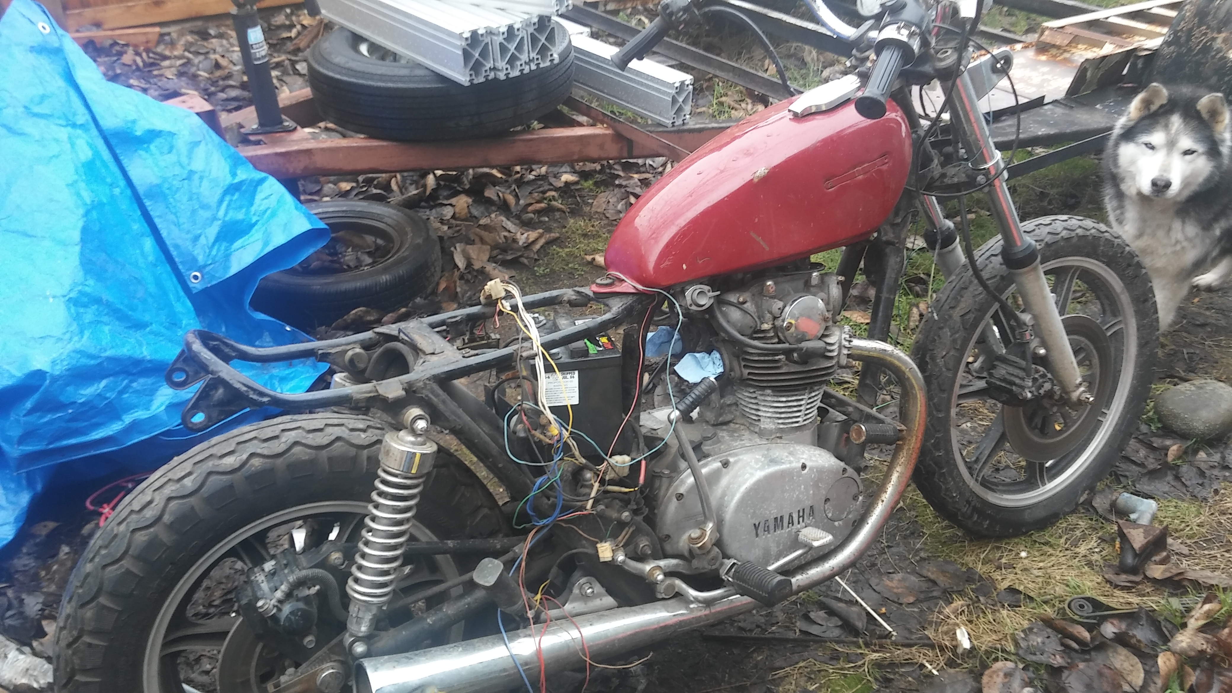

Feb 2017-Aug 2018. Thats fast progress for me.

Fantastic work! Time frame is not at all unreasonable. I really like the overall style and finish. Sure miss my '73 Yammie... (my mom sold it for peanuts while I was in boot camp)
It's a fun bike. The rephase gives it a nice sound, and the EFI works really well and will get better as I ride more with a laptop.
Don't you hate parents getting rid of something just because you aren't there?
I did it myself. It needed new rods, so I took it apart, reassembled, trued, and had a coworker tig it for me. The cam I rephased myself as well. I did it for the sound and to see if I could. I couldn't have afforded to send it out to be done.

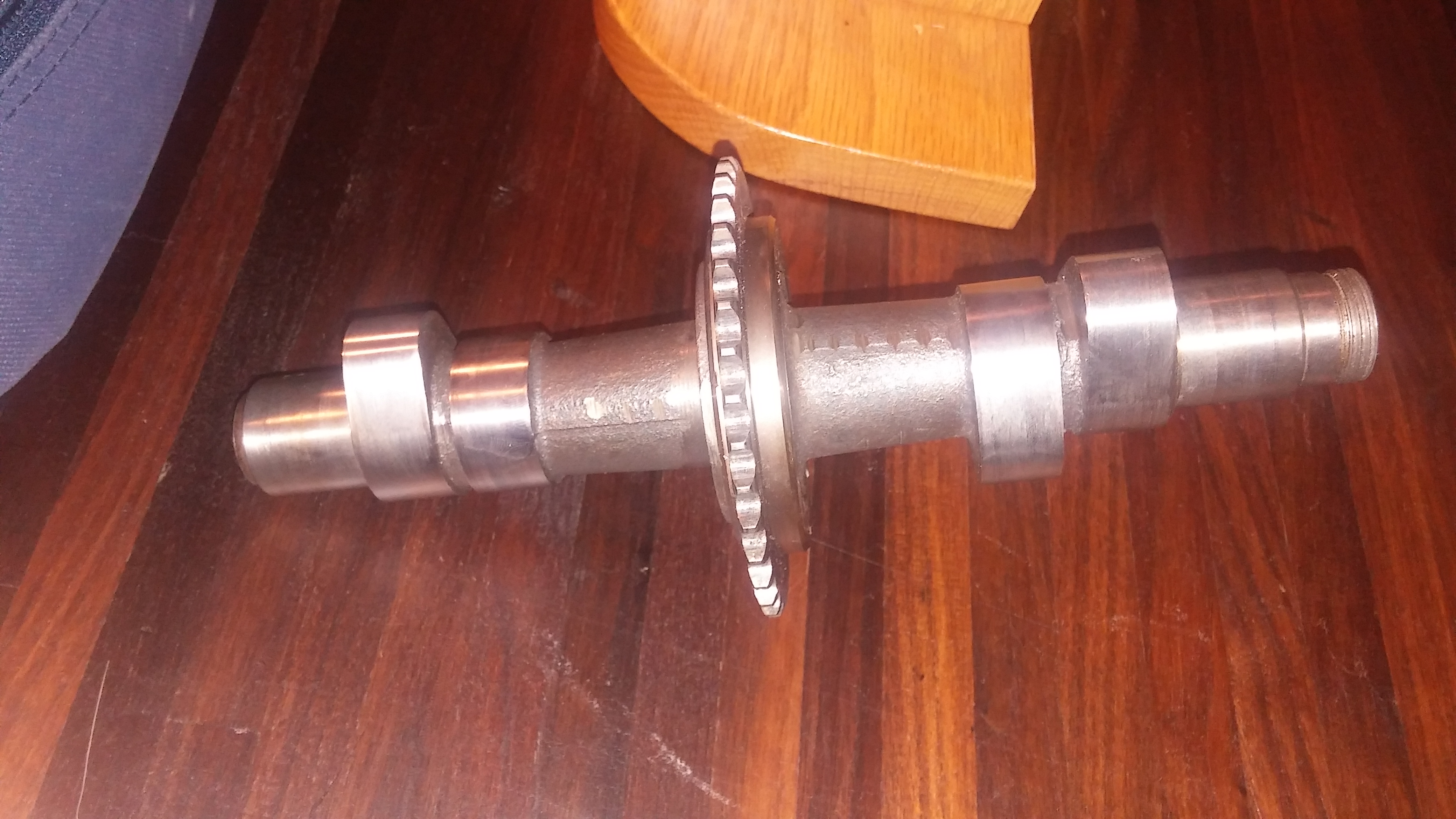

Lol, I cheated on the cam. I was programming and running a mill/turn when I did it. So I programmed it to drill two 3 hole patterns 41.54* apart and then part right in the center. That let me use 3 1/4" dowels to align everything and the press fit of the sprocket holds it together.
The crank I tore apart and rebuilt according to the manual, just I cut a new notch for the sprocket and pressed the right side on advanced 3 splines.
I didn't get any pics of the crank in process since others have done write ups.

Ah the joys of a smaller shop. The last place I worked at there was no heat in the winter and no fans in the summer. But I got to learn how to program, set up and run a dual spindle live tool lathe. Most of the parts for my bike were made on an old Induma mill and a 1940s Atlas lathe. Only parts I cheated and used the CNC on were the cam and velocity stacks. Things worked out well for me as I had wanted a mill and lathe for years, and when it was time to leave the army I went straight into school for machining. I'm lucky in that one thing I really wanted to learn pays the bills and is still fun.
After 2 years finally got it just about done but going to re-do the wire harness, the turn signals keep f'n up and just setting up on/off switch, start button and turn signal on tank console.

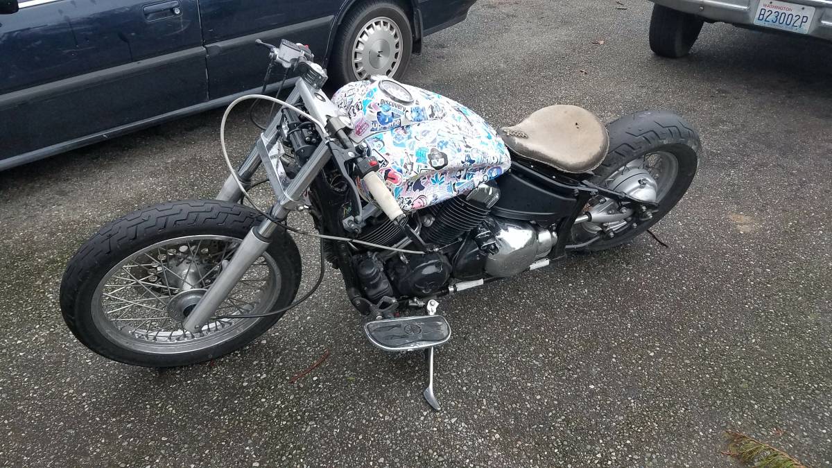

Good news: I still have 'em
Bad news: they are completely trashed. The backside/bottom was rusted out of each muffler for a good ways
I keep telling myself I'll find something to do with them. For now they are just décor/taking up space (top left)
