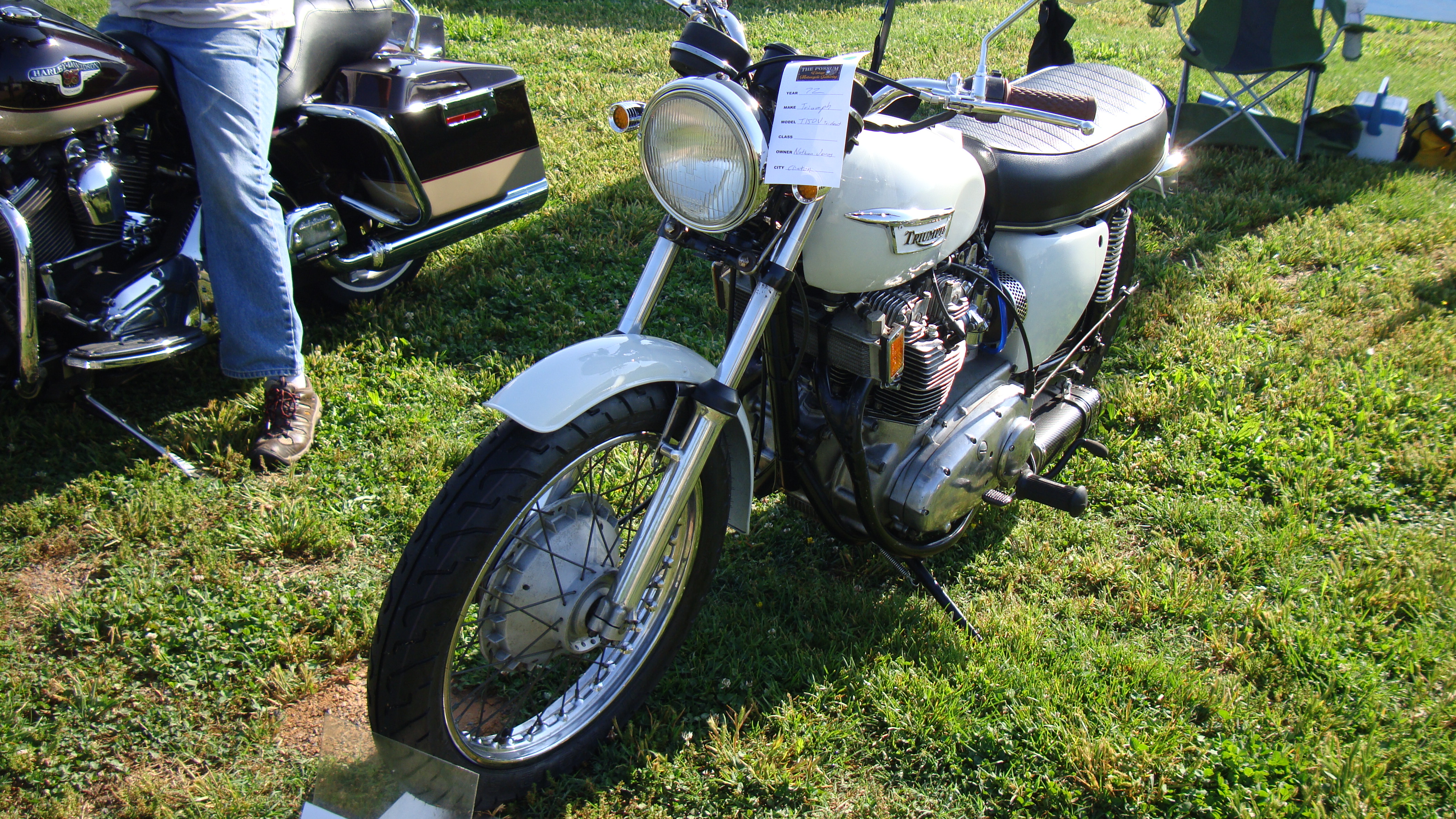

Took her to the Possum Gathering and today started and rode her two laps around the track. Goofy-foot brake and shifter still messing me up, but she ran well. So many gorgeous bikes at the show.
