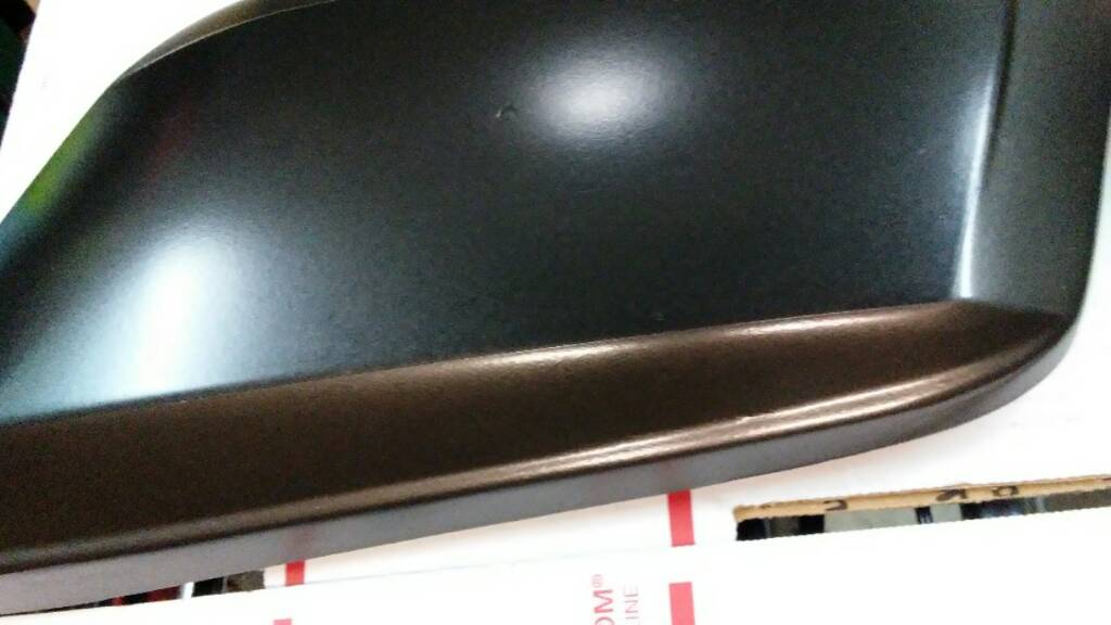

My painting is either too much and get runs/sags, or too little and get orange peel like a bandit. I'd rather have the orange peel because the clear levels it (mostly). Desire was for black with a little gold (4:1) and black with more gold (3:2) as accent. Maybe too subtle? Anyway, no runs drips errors or bugs this time. Clear is supposed to be here Saturday. Of course, it looks a lot different depending on light and observation direction, but I like that.
My motto is... put enough clear on to wet sand and buff out. I despise orange peel at the highest level. Even for matte clear I'll pile on the gloss clear and level sand that back to 800g and spray the matte clear over that.
