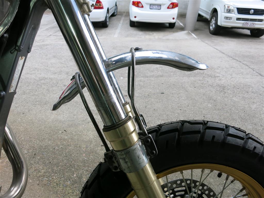

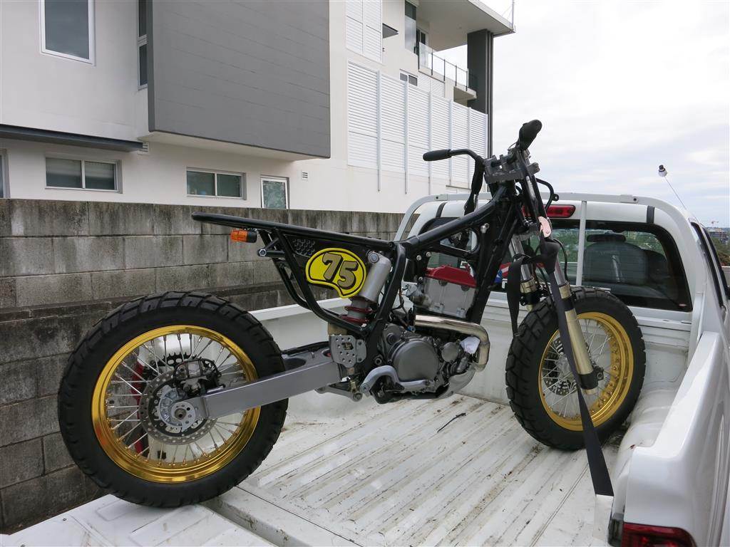

Small progress, I dropped the headlight brackets down and fabricated the mounts for the front guard.

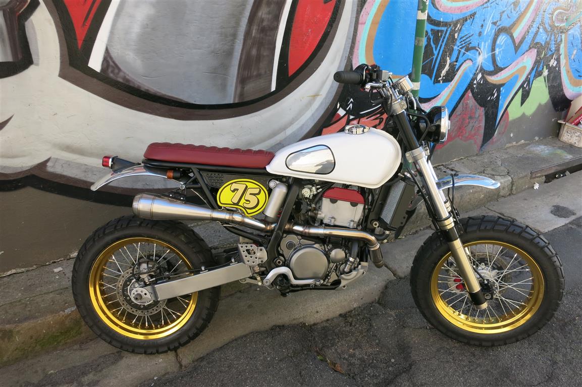

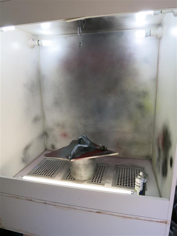

I built a Mini paint booth and got to painting everything, the rest of the parts came back from Powdercoat and I got it back on its feet. Seat is done. Exhaust and wiring next. pj

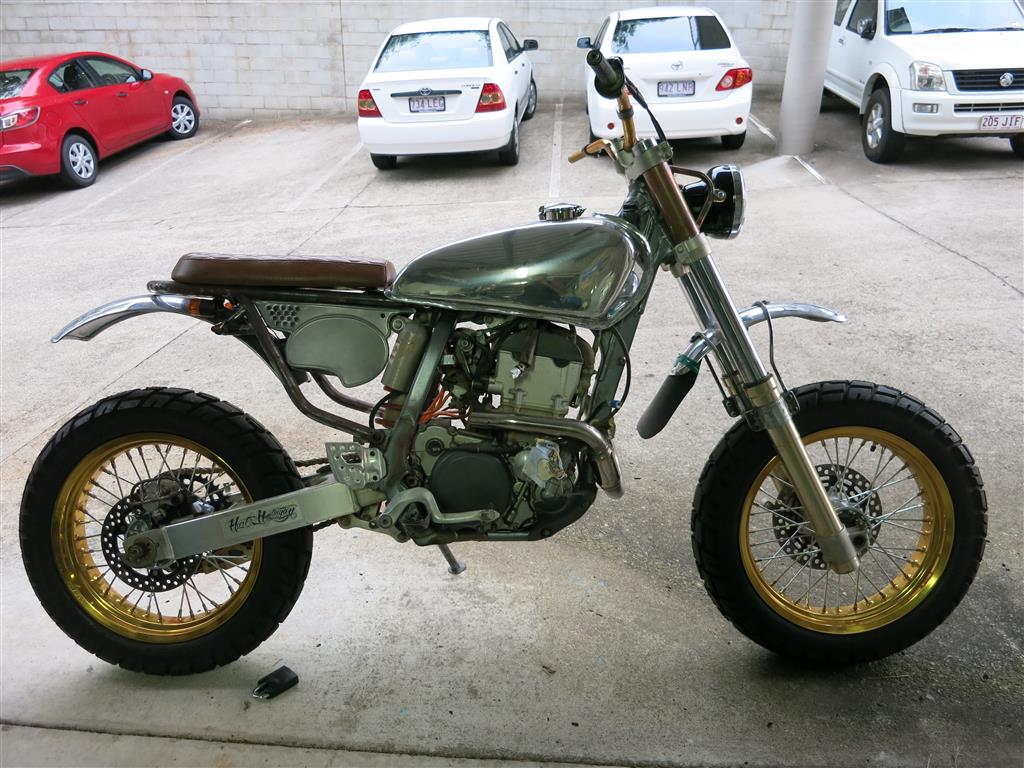

That is fantastic!
Are you keeping the tank polished, or are you planning on painting it?

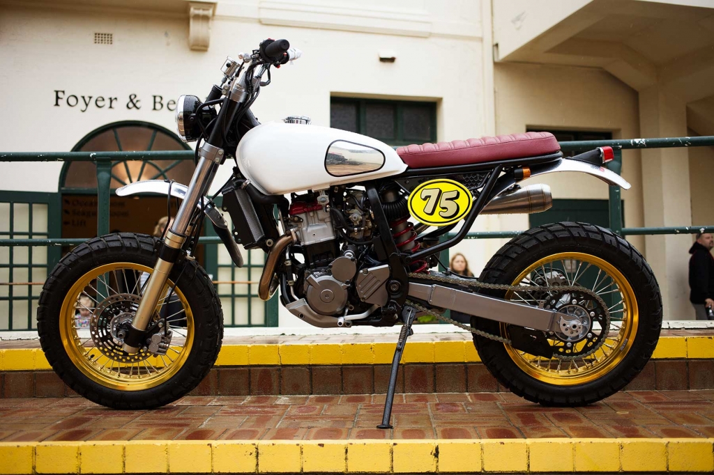

At the Australian Deus Bike build off on the weekend. Pic stolen from http://www.weareninetynine.co/events-rides/deus-bike-build-off-sydney/

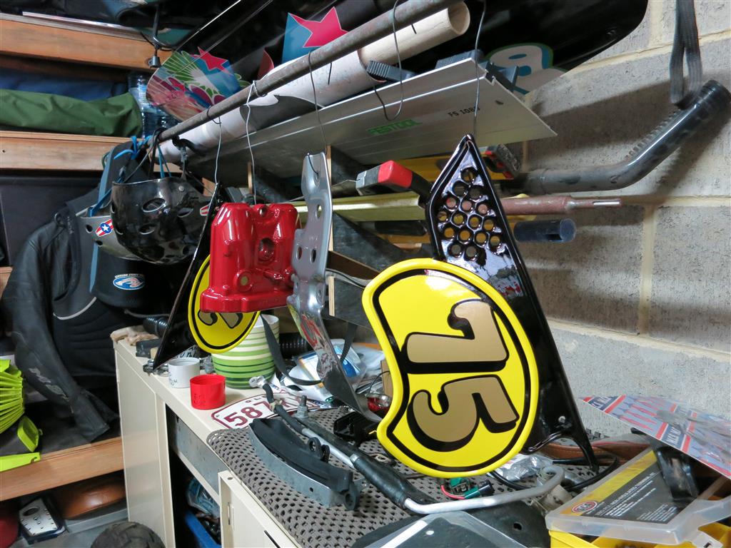

The Side covers are bead rolled, the seat pan has round bar tacked to the edges.
A little more progress. Fabrication is now finished on the rear end, so I started the front end. Yamaha IT inspired number plate. Dave
That is an awesome Marchal headlamp!!! I bet it was very hard to find.
Hey, the Marchel headlight was quite easy to find, I found it while searching on webike for parts for my monkey bike. Would love to have got a yellow one but I wanted to keep this bike legal.

I have never ridden a super motard (Drz sm), only rode this one about 3 klms before I stripped it down :) Took it for a rip this afternoon pops wheelies easily on and off dirt such a fun bike.
Chop the Wr up, I must admit one of the hardest things of the build was sourcing a radiator, ended up with one off a Honda 08 Cr 125/250.
