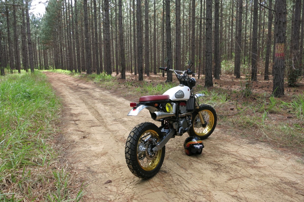

Pjdaves DRZ 400 scrambler
Went out for a Braap in the forrest, couldn't resist throwing up a pic.

How much clearance do you have between the triple clamps and front fender at full compression? Any mods to the forks to limit travel?
Love this bike!
I thought the front fender would touch the radiator first but it has a small mark from where it has hit the triple, I noticed this after doing some wheelies. The rear fender just touches under full compression. The suspension is stock at the moment

Tank is a modified Yamaha SR 400/500. The petcock has been moved forward. Remember to do this conversion the radiators will have to be changed out as well.
Hey, The header pipe is a FMF powerbomb built for a DRZ and the Exhaust can is a TYGA. http://tyga-performance.com/site/index.php?cPath=71_815_1125_1126
I had to make an internal baffle as it was offensively loud.
I know this an old post, but hoping pjdave is still active. I've just bought a dzr and was wanting to remove the airbox for my custom build. What did you do for the carb setup? I've just purchased an fcr 39 mx and it's jetted to suit with the 440 big bore.
