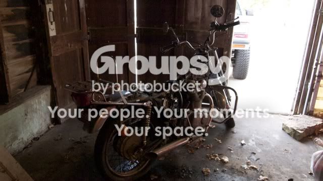

While visiting my parents for Thanksgiving break all I could think about was how gas was killing my wallet. My truck gets around 12 mpg in town and 18 if I drive slow on the highway... :( So I started looking into getting a bike. After searching the interwebs for hours I found this piece of junk on Craigslist in Kansas City. It is a 1974 Honda CB360. Since I was picking up my girlfriend at the airport I thought I would commit and buy the bike. While everyone was trampling each other at the malls and what not on Black Friday I drove 281 miles to Kansas City (my parents live in central Kansas) to pick up my new project. Afterwards I had another 130 miles back to good old Kansas State. It was a wonderful 7-8 hours of driving that day.
Here is how she was when I picked her up (not the girlfriend of course!)...

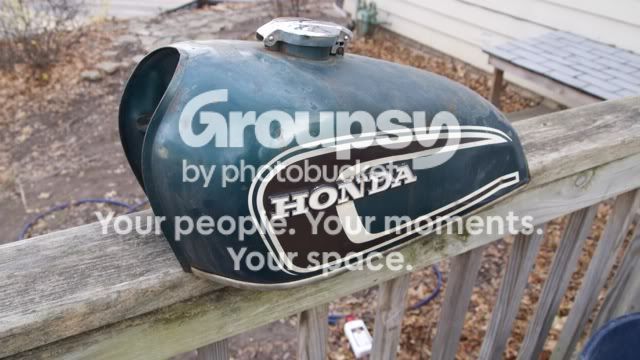

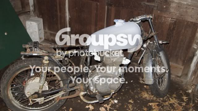

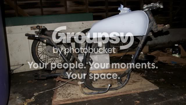

The first major item I tackled was the fuel tank. It got a nice helping of Aircraft paint remover first thing. BEWARE: I wasn't using safety goggles (foolish of myself to do so) and somehow the tank dropped on the floor when I was removing the paint. Unfortunately some of that harsh chemical splashed up on the ridge of my nose and close to my eye. Immediately I grabbed the can and ran upstairs to flush my eye and skin as a precaution. Luckily I didn't suffer any injuries besides an ugly mark on my nose for a week.
Then the lovely bondo-ing began.
After having a few parts removed, I mounted the tank.

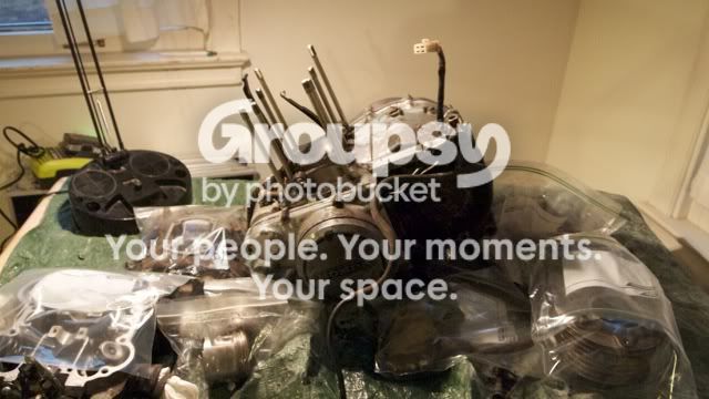

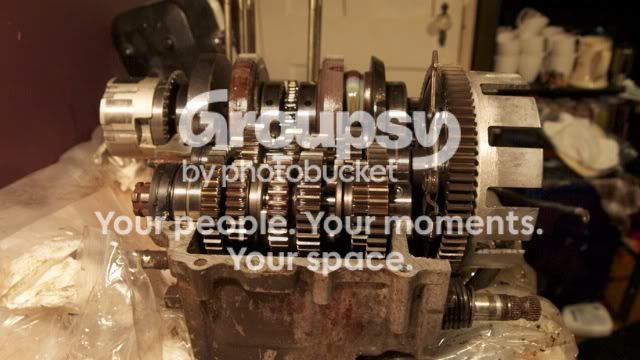

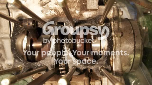

A good friend and I started to tear down the engine. This really worried me because I had no idea what I was tearing into. The odometer that the previous owner gave me with the bike showed it had 4,938 miles on it.

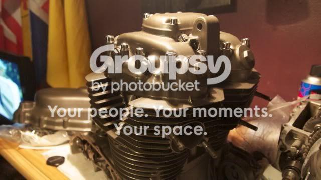

Surprisingly the engine is in extremely great shape. The cylinders still had the hatches from honing and the piston and rings looked awesome. There was some carbon build up on the pistons and valves though. For being in such great shape I wondered if it had a full rebuild before it sat for awhile. After getting a good look at everything I decided to clean, replace gaskets, stainless steel bolts, and paint. There was no need (and no money) to do a full rebuild.

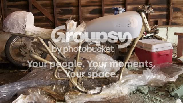

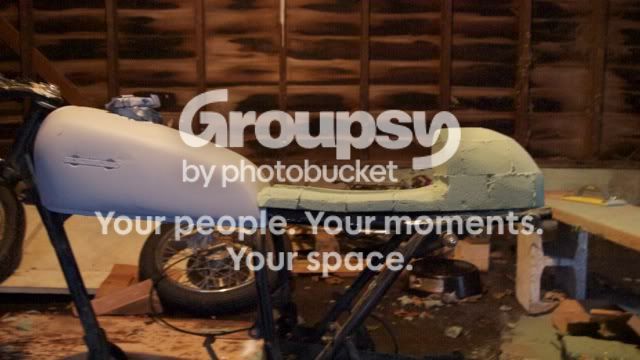

The next item is the seat. After spending many hours on it, I have decided to completely redo it. I could possibly save it, but it isn't what I envisioned. First thing I did was buy some floral foam to carve it into shape. Using some 3M Super 77 adhesive, I glued the pieces together and left to dry for a couple of day. Using a large Buck knife I shaped the foam. I initially wanted to make a removable seat pan, but abandoned the idea.
Next I laid down some aluminum tape over the foam. This is so the fiberglass wouldn't stick to the foam. Then I started to cut and lay out the fiberglass.

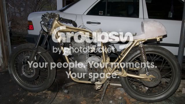

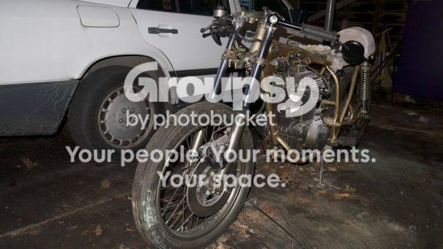

I started to get ahead of myself and forgot to take some pictures as I go. Luckily over winter break we had many days in the 50s' and 60s' in late December and early January, so I worked my ass off to get the frame painted. I also started to bondo the seat. It came out very half assed. Luckily the fiberglass was left overs from a project.
More glass work..

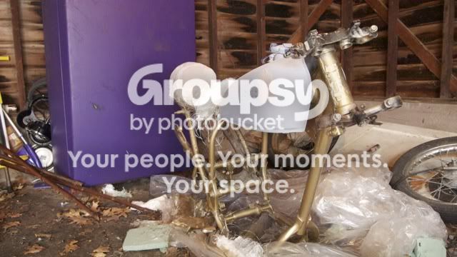

Forks and wheels painted and installed!

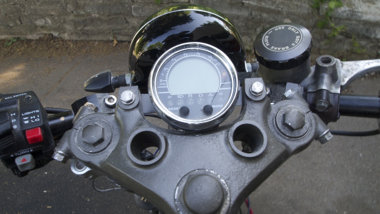

Here is the Danmoto gauge. It is an Acewell ripoff, but I am on a budget.
Recently I had installed the back wheel and now have a kickass rolling chasis. As soon as it isn't below freezing again I am going to get back to work on her. I will keep updating as I go along. Thanks for looking!

I'm on the fence about the danmoto gauge, thinking of pulling the pin, let me know what you think about it.

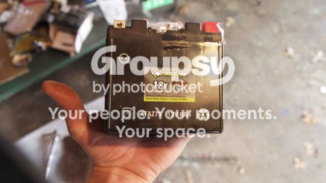

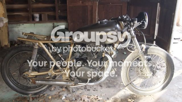

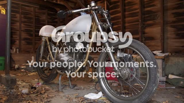

As promised here is a photo of the bike as it sits now. The engine looks a bit white from sanding bondo. The garage is super messy and a ton of leaves have blown into the garage, so I will be sweeping too. Tomorrow I am going to work on it a little bit. Maybe I will start wiring. I am going to hold off on the seat until I get my battery from DCC. I want to be 100% sure it will fit and be concealed.

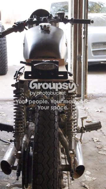

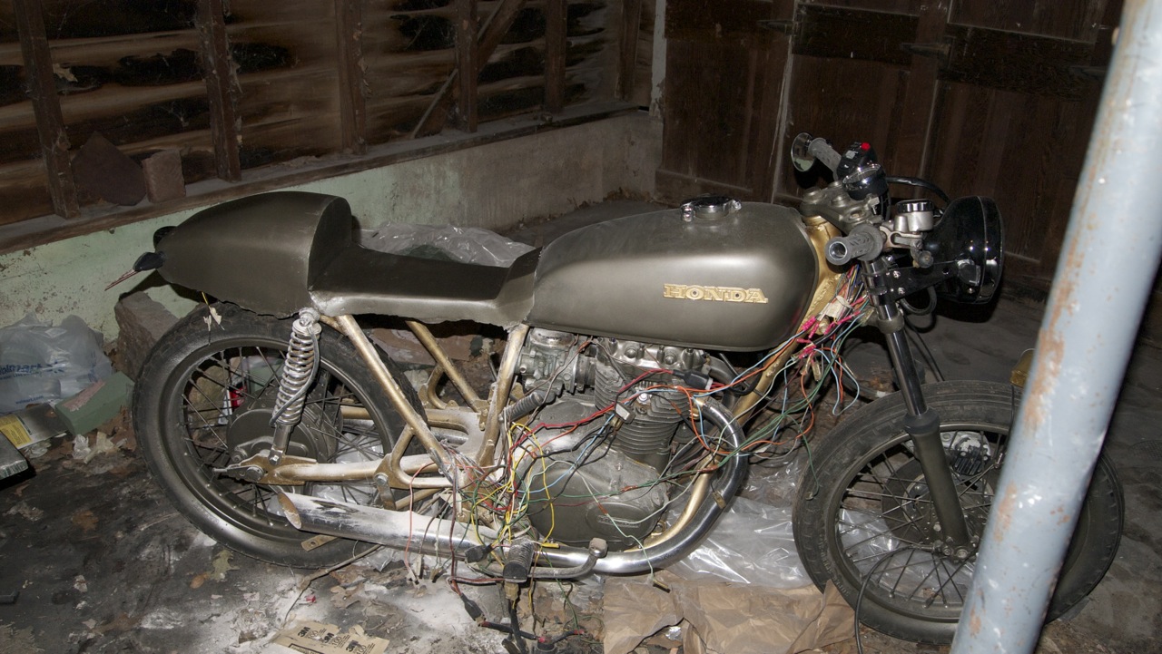

Today was probably one of the most beautiful days Kansas has had all month, so I had to spend the day working on the 360. To day I started to get the wiring harness all set in place. I am not looking forward to hooking it all back up, but it will be a huge relief when it is all done.
I also got to painting a few things. I started with the Honda tank emblem. Of course it had to be gold/bronze to match the frame. I also painted to exhaust flanges to match.

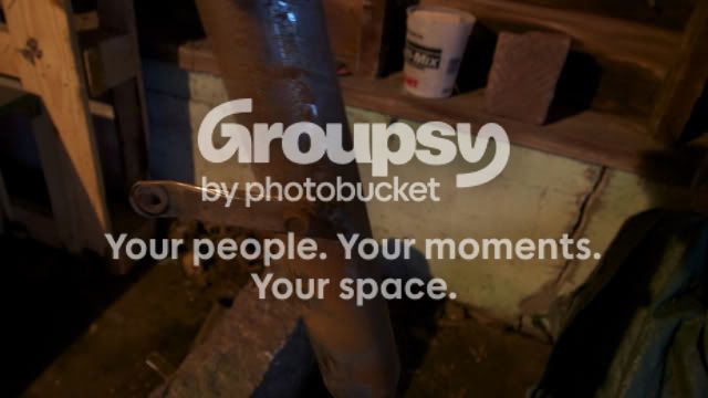

Here is the old rusty exhaust. I spent a little time using a scotch pad to remove the rust, but I didn't get it all done today. Eventually I am going to replace the exhaust with a 2-1 system. Sorry for the bad picture.
Also was the day I thought I would try a color on the tank. I spent a few hours sanding and priming. After all of the was done I decided to paint it the same color as the engine, forks, and wheels. I must say I really like the look. It doesn't look to busy.

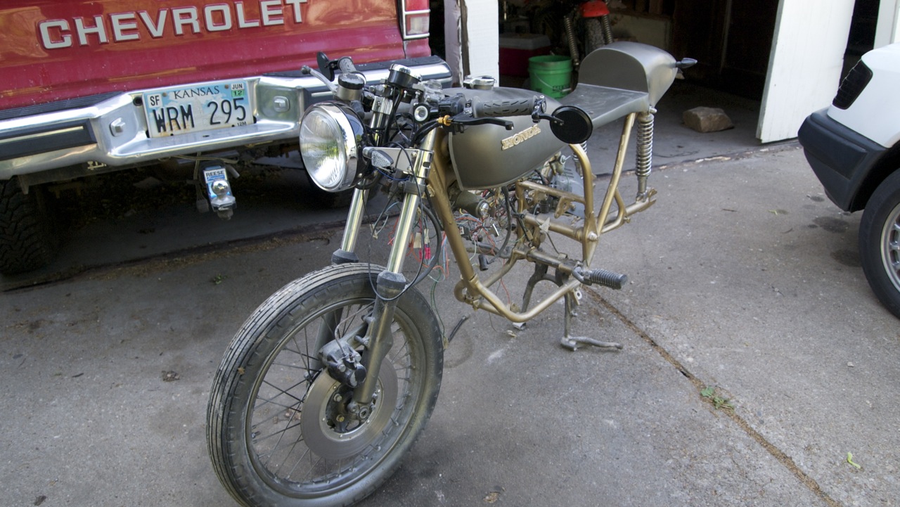

I think it would look better if the front end is lowered a bit ;)
You could have them sticking through the top triple for a an inch....
I might give that a try tomorrow! If it has an agressive stance I am all for it. Right now I am contemplating whether or not paint my exhaust. I am not sure it will look good or not. What do all of you think? I know it isn't going to stay on there forever, but I don't want to have to stick with something that looks bad for awhile.

So today I received that package from Dime City Cycles! I wasted no time getting to work once I opened it. One of the first things I did was attempted to put the air filters on the carb. They did not fit. I bought ones that the outer diameter was 39mm and not the inner diameter. >:( Maybe it takes a little encouragement to get on...

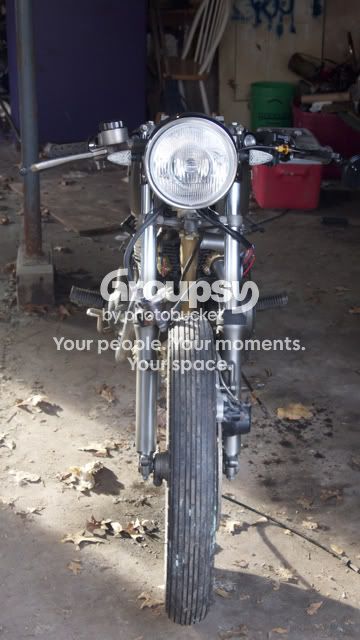

So I went on to my 6 1/4" headlight. It has an 60/55w bulb which is too much for my bike, so I replaced it with a 35/35w h4 bulb. Once installed I thought it looks like it sticks out kind of far, but I really like it now!

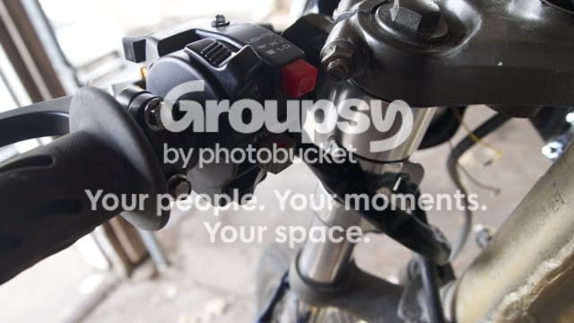

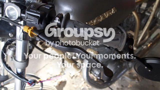

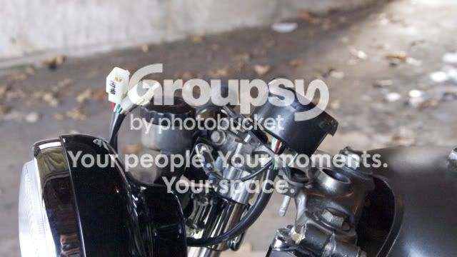

Next I went on to installing the grips, clutch lever, and all-in-one controls. Those controls are sweet! It looks like it will be a piece of cake to wire it up too. The only thing I need to do is make it from moving. It likes to turn a bit if you use a little too much force.

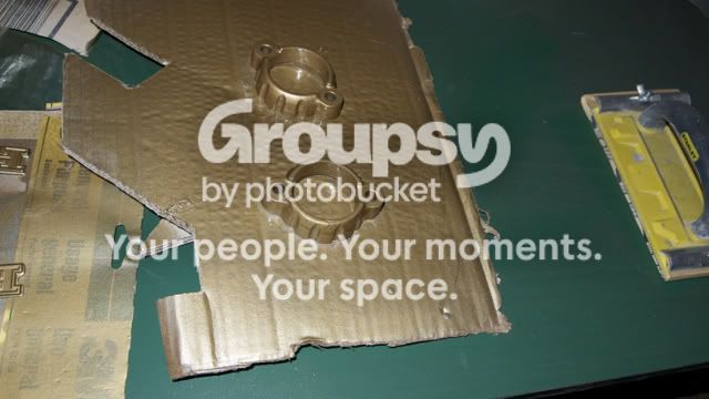

I also mocked up my seat pan with cardboard. I will be sheet metal to support the battery and fuses under the seat.

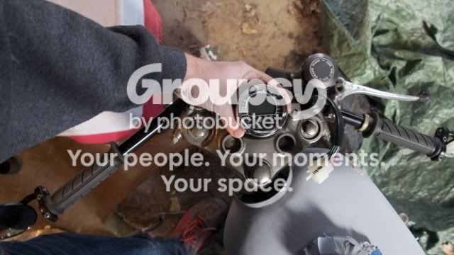

Next I mocked up where my Danmoto gauge will be placed. I spent a little time determining wear it should sit. I think it will sit lower than on the side picture.

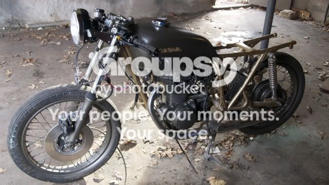

The exhaust was also mounted.

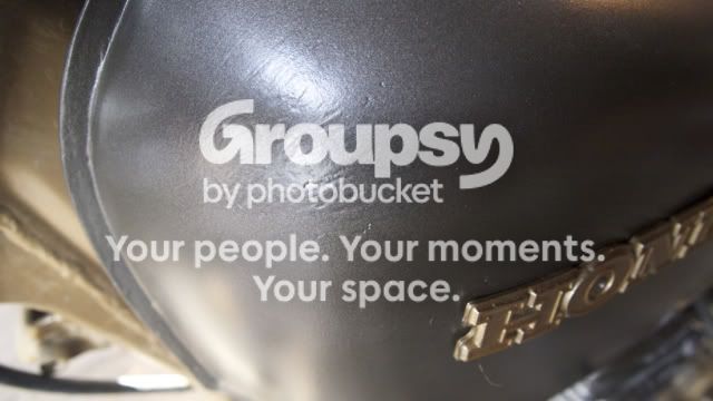

After looking over my tank I noticed it wasn't in good shape. So I will be sanding it down and painting it again.

The bike is really taking shape! I like the DanMoto Gauge and placement.
