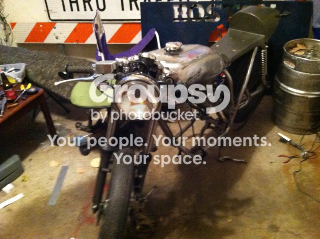

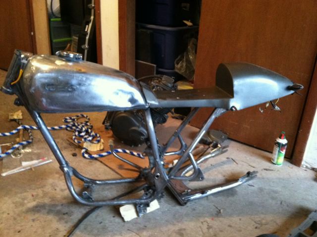

Lately I have been super sick of a lot that was going on this bike, so I broke out the angle grinder. I have had a bit of time to finally work on it and I am going to take a whole new approach.
Still having problems with the gearbox I pulled the engine yet again. I haven't gone through it, but I am going to reevaluate the whole assemble.
For this revise, Project War Horse, is going to be a stripped down version of what I already have. The paint was horrible and I cannot afford powder coating the whole thing, so I am going to have as much bare metal as possible. The exclusions of that will be the engine, wheels, and forks.
I am thinking of clear coating all of the exposed steel, but if I find a better solution besides clear powder coat I will do that.

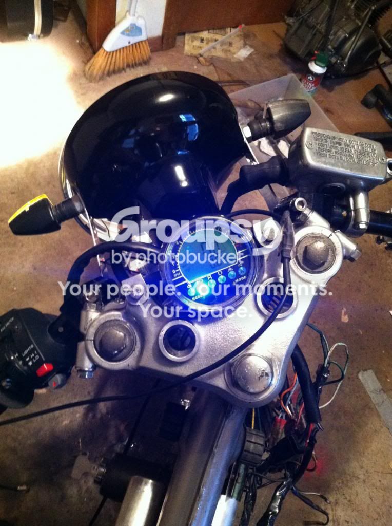

The Danmoto gauge was fully wired up before disassembly. Those LEDs are unbelievable bright
The seat is going to stay the same, besides some foam and leather for a seat pad. I am using leather from a jacket that I got from a thrift shop for $8 for a party. I will probably make straps and a rollup tool bag too.
Here are some photos.

Trying to make that metal look new. Angle grinders are fun!

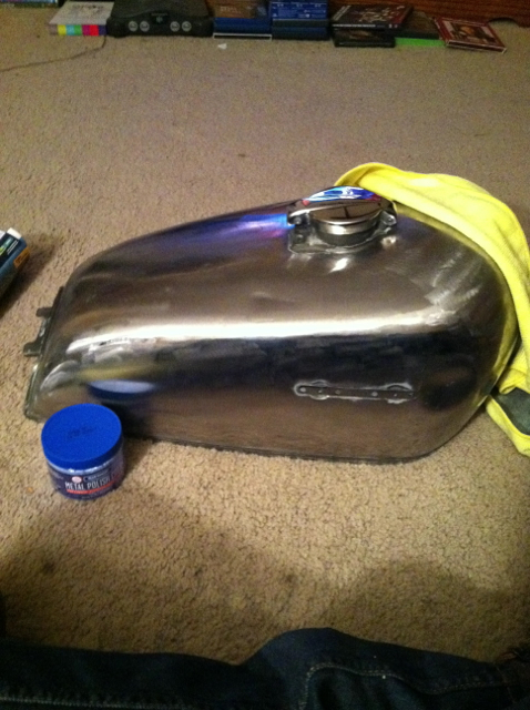

Lately I have been busy with tests, but it looks as though I will get a bit of time to work on this. Last night I started to polish the tank. I am debating whether to keep the sanded angle grinder look or a straight uniform sanded look. We are suppose to get about two feet of snow here so classes will likely be canceled. More time to work on the bike. If so I want to have at least a rolling chasis again and maybe start going through the damn tranny.

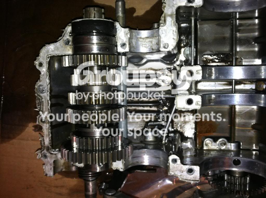

I have been keeping busy with this little turd. Finally I got the paint off of the metal and put some polish on it. Today I got it all wired up and cracked the case open again. With the tranny I am stumped. Maybe it moves when I put it together or I am over looking something. Tomorrow I plan on going through this whole thing and making sure every part of the tranny is in its place. Sorry for the crappy cellphone pictures.

The cause of the whole gear issue came down to two things. First, the ball on the shift drum looks as though it wasn't settled in perfectly. Second, I was checking the clutch and loosened the bolts and everything popped into place and was free. It was the weirdest thing.
