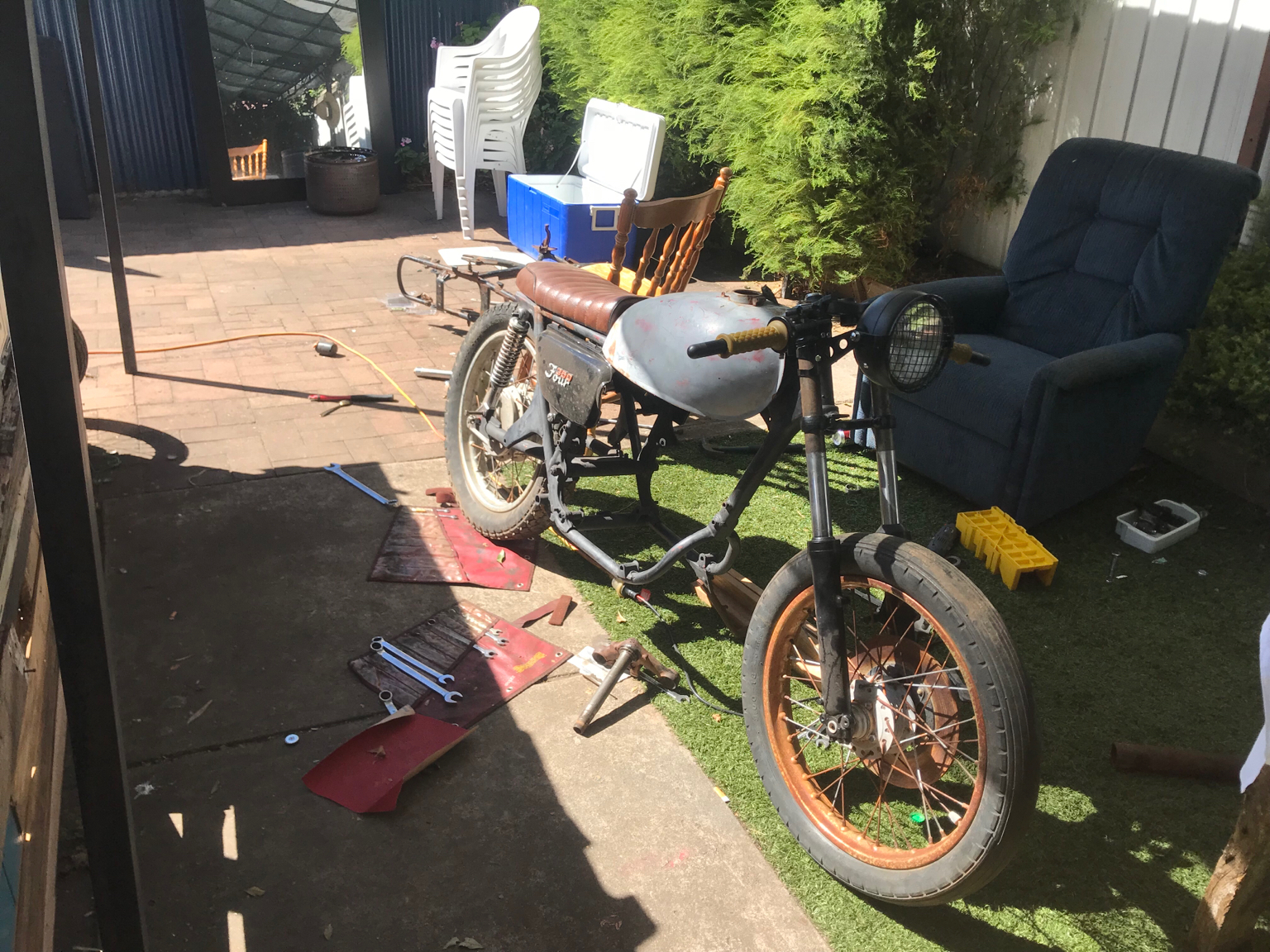

Decided to mock up a bit of the bike yesterday. The back rim is the wrong one. So I wanted to change the tank rubber mount locations so the tanks underneath edge runs parallel with the seat. Currently the front dips way down because it’s not a Cb350f tank. The tank I’m using came with a cb360 I got but I feel it might even be a cb250 tank maybe. So the next job is to cut and weld the tabs, fasten the tank and move down the bike to the seat. That’s a bit I’m not real sure about yet. I’m wondering if I should make a seat pan that is hinged so I can easily open the seat or not bother. See, I have the side covers which will be removable and obviously that will give me access to the battery and electrics. So once I work out the seat I will move on to the back loop I need to weld. Then I need to work out the back mud guard so it passes the annoying Australian motorbike laws. All easier said than done ‍♂️
