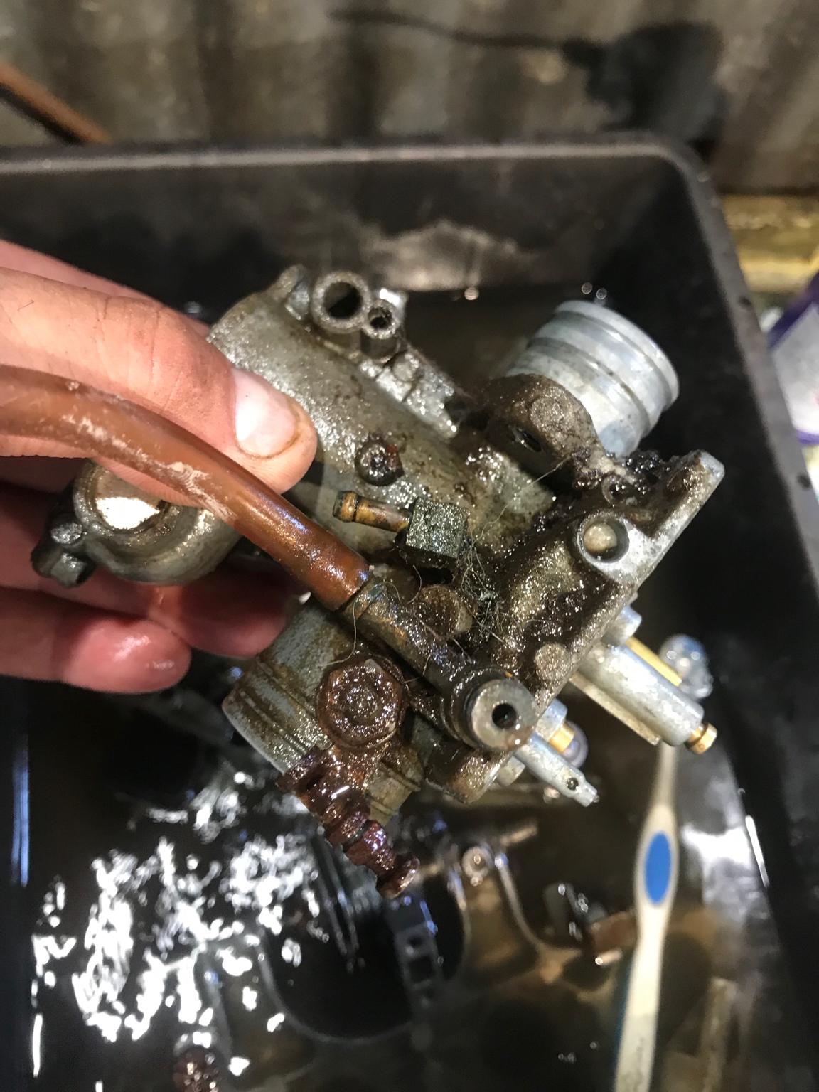

Thanks for the advice I have rims on the way. Also ordered a pamco electronic ignition with coils, leads and spark plug caps. Couldn’t help myself and ordered some rear shocks as well. I got some new carby rubbers which are way over priced. $80! Finally, I have a carb rebuild kit in the way and that’s what I’m working on at the moment. Just split it all down and have it soaking in mineral turpentine at the moment. It’s all filthy! probably going to buy an ultra sonic bath cleaner tomorrow to get them looking clean
The ultra sonic cleaner will help the rust as well I hope

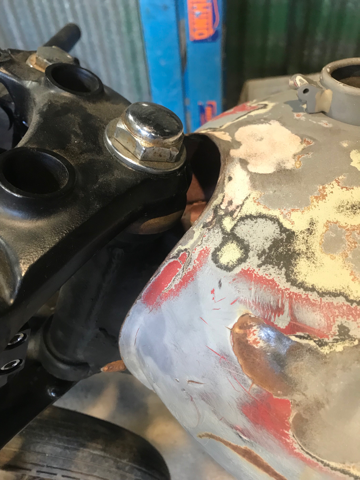

So I’m working on the tank at the moment while I can do some grinding during the day. Two areas that I have been putting off are the tank and rear hoop. So this tank isn’t original to the 350 so it’s being a bit difficult to make look right. I like the shape so I’m determined to make it work. Here’s the issue, I want the bottom line of the tank to run parallel with the seat section. Also it can’t foul the side covers. The straight up option is to lift the tank at the front and rear until it all clears the side covers and is level. Thing is, it sits super high up at the steering colum/triple clamp.

Haha and this is what I get when its level ‍♂️ obviously that won’t be happening.

There must be a way but I haven’t worked it out. One option is to go with the first picture. Grind the bottom of the tank line till I get the level I want and then tig weld it. If I go to that effort I will get rid of the curve at the back of the tank as per this photo

And this is what I have come up with. Not sure if the front of the tank is too high? Otherwise I find a tank that has the same shape but is smaller. Not sure. Annoying as I have three tanks and none fit

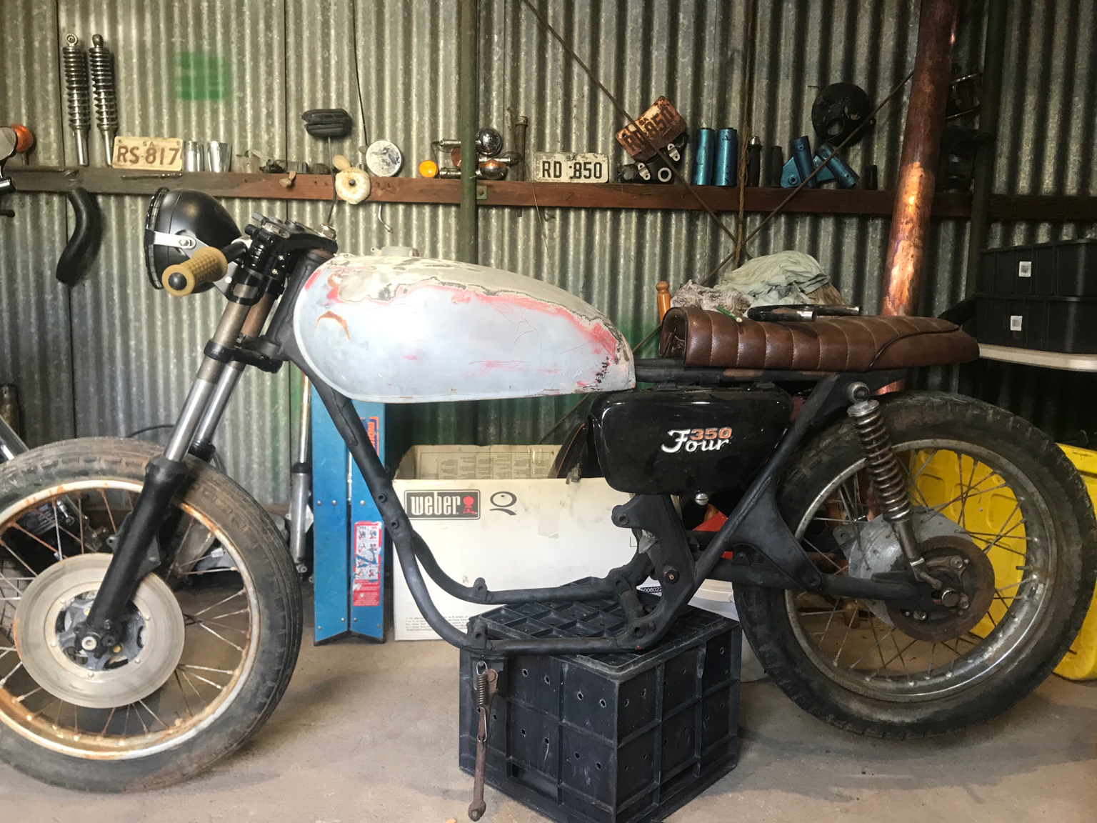

Progress shot. Tank is in place, hoop welded but not cleaned, seat altered but not fixed and new shocks

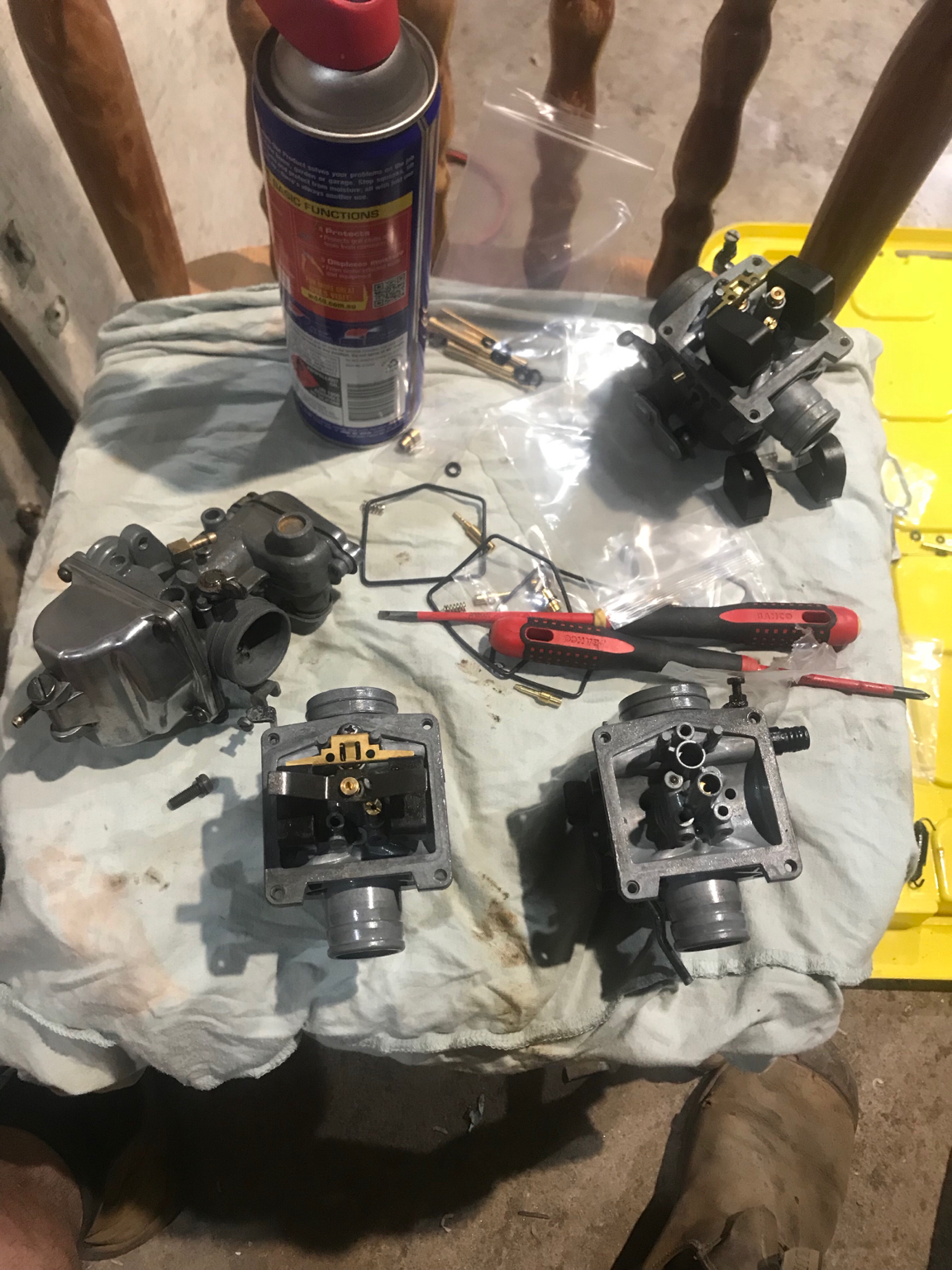

Carbs are clean. Mixture screw was suck so I used an easy out which was a pain in the arse. Putting them back together now. New spokes are ordered. $150 from China. 304 stainless. Hopefully they fit. Will get to the seat next unless some valve bolts rock up from the UK.

What a fucked process! I’m still at it. At least, the carbs will be clean, new everything and hopefully a worry free starting and running experience. I don’t know how you guys out there get a rebuild done with a missus and kids. This project has taken god knows how many hours and I’m probably only half way! Fark! Oh well, beats watching the lefty project here is Australia. Peace ✌️
