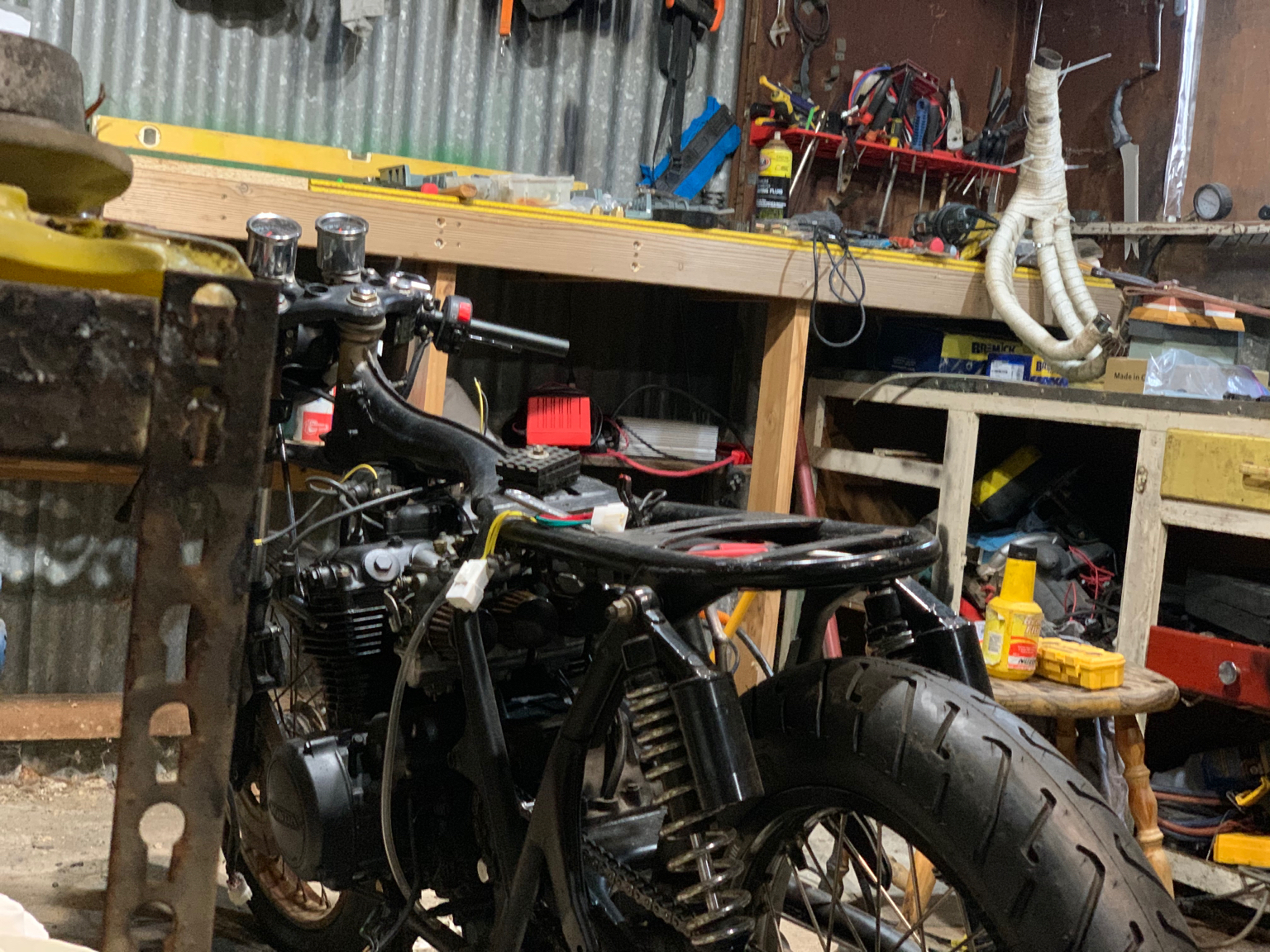

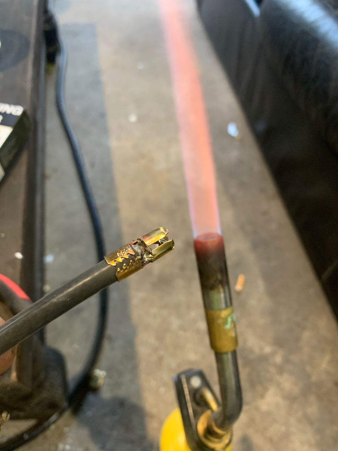

Ordered some bits from 4 into 1 Monday night and received them today. Not bad from America to south Australia in that time. I’m now rebuilding the front brake with a new kit and sorting the plugs, caps, leads and new solder crimp connections for the ignition system
Mounted the coils. Had to weld a little tab to make them fit as the cb550 tank I’m using is in the way
Still waiting on the rearsets. I bloody ordered them ages ago and they never rocked up so I’ve ordered another set and got a refund from AliExpress
I’ll do a video this week of it running. Then maybe I might do one of syncing the carbs. That’s actually going to be annoying because of where the screws are been each carb and filter
