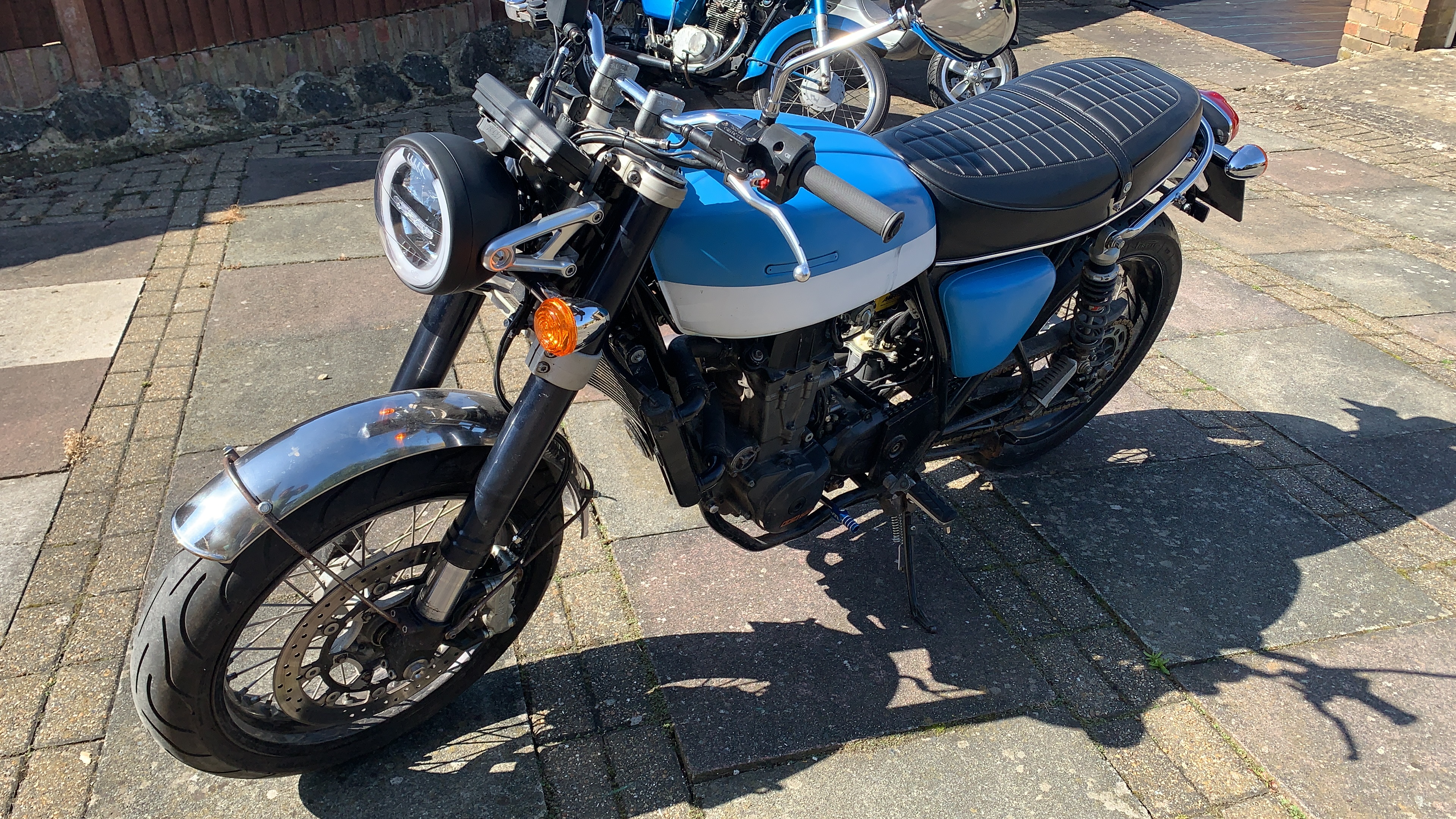

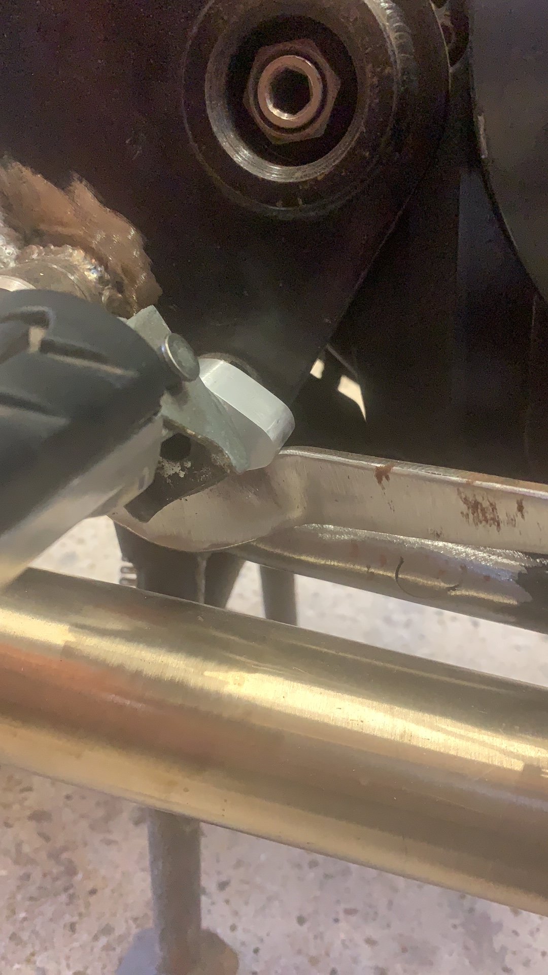

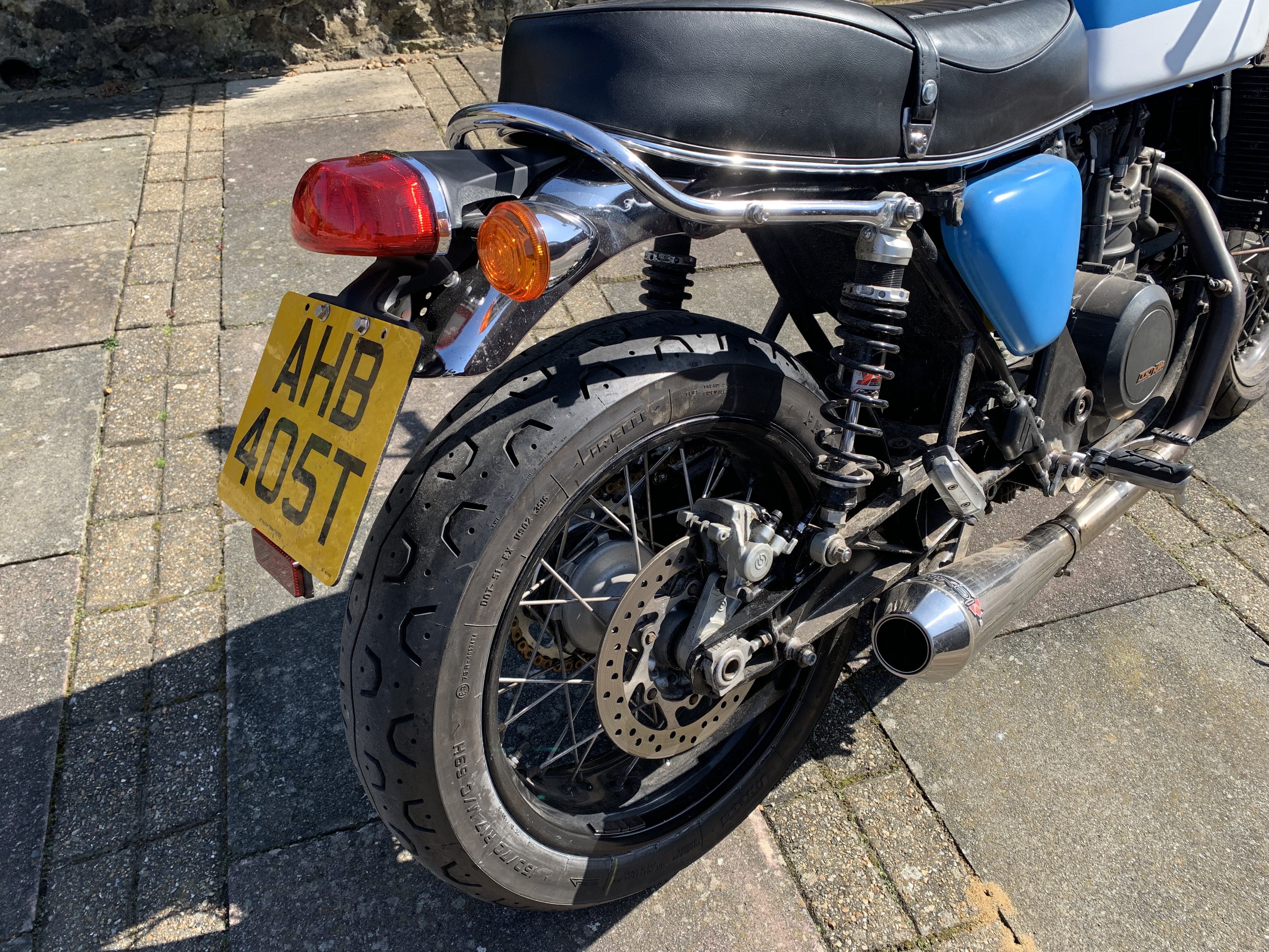

I got a tail light unit from a 2016 Thruxton, I love it. It will really clean up the lines of the bike and get rid of those ugly black blinkers. I will cut the tabs off of the grab rail, grind them down, and rechrome it. Also got an LED leadlight. I'll make new fork ears too, to move the headlight rearwards almost 40mm. The SV650 headlight ears that are on there now are almost 110mm long, which is unusually long.

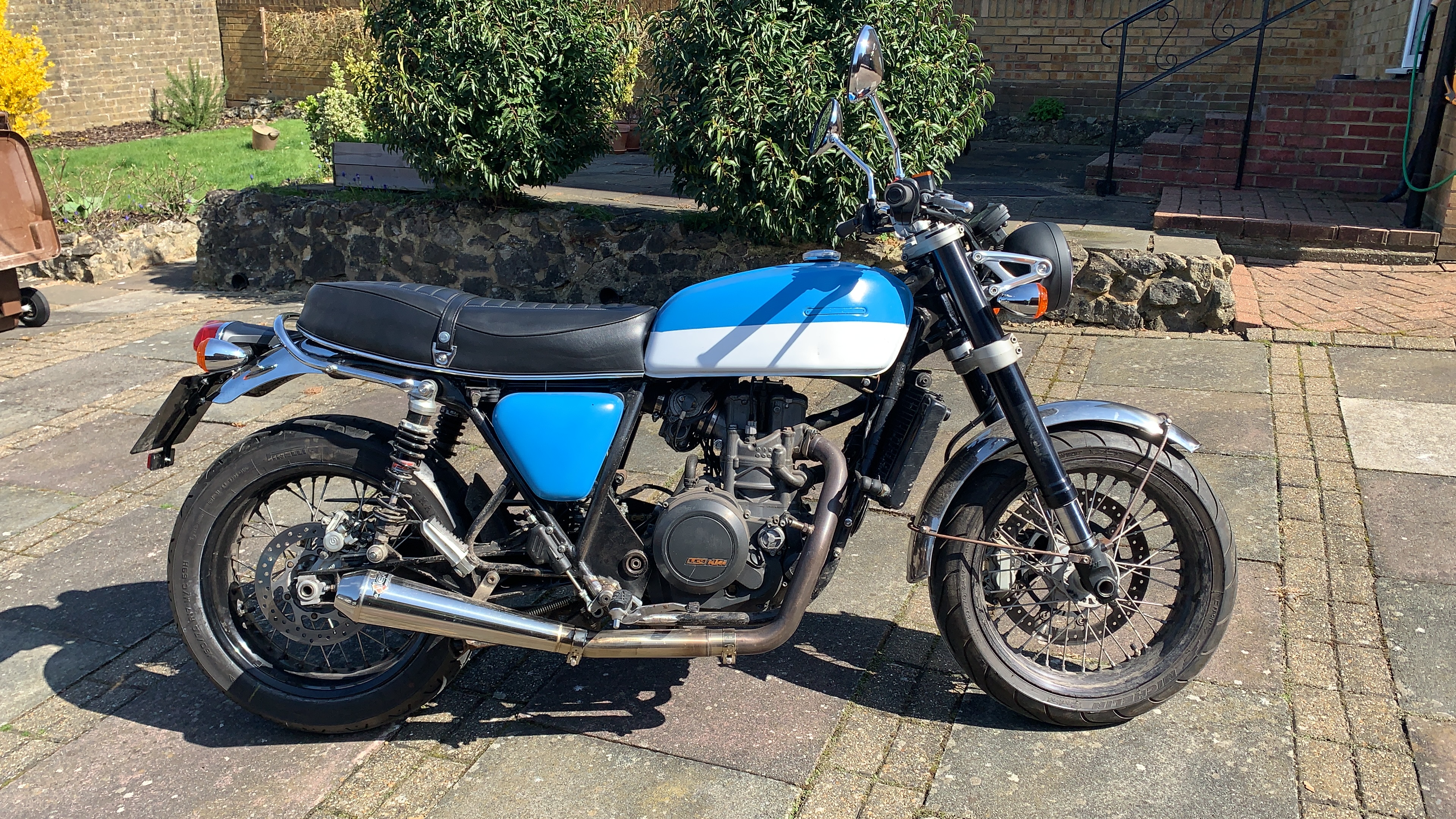

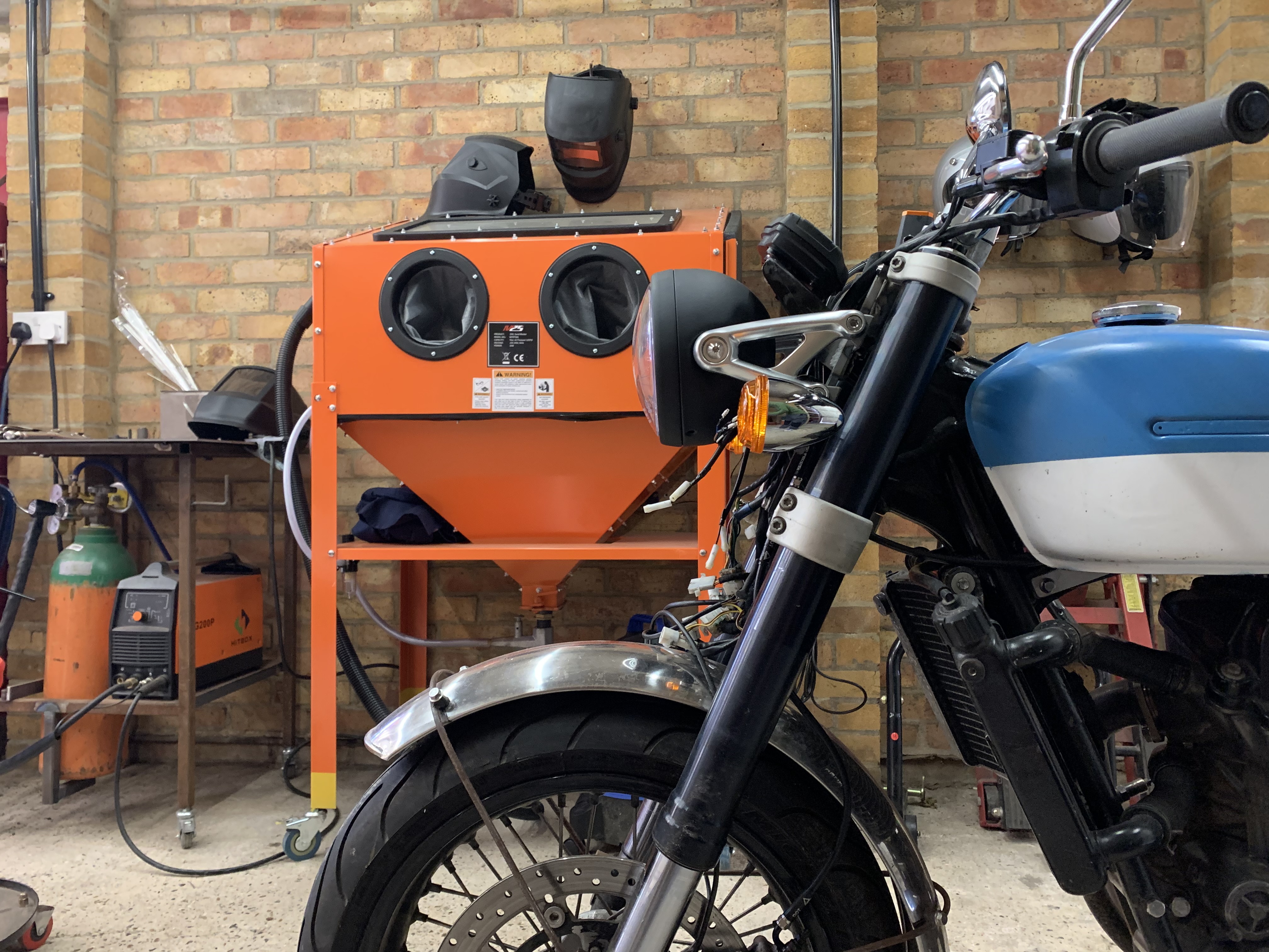

Reworked the headlight brackets to accept the Triumph ears and new headlight, and replaced the clutch and brake cables to fit the shorter bars. Very happy with how it all looks. The wiring didn't fit into the headlight shell initially, so I had to shorten some sub harnesses and replace some large connectors with smaller ones. Fits in very nicely now.
Also you can see my new bead blaster in the background.

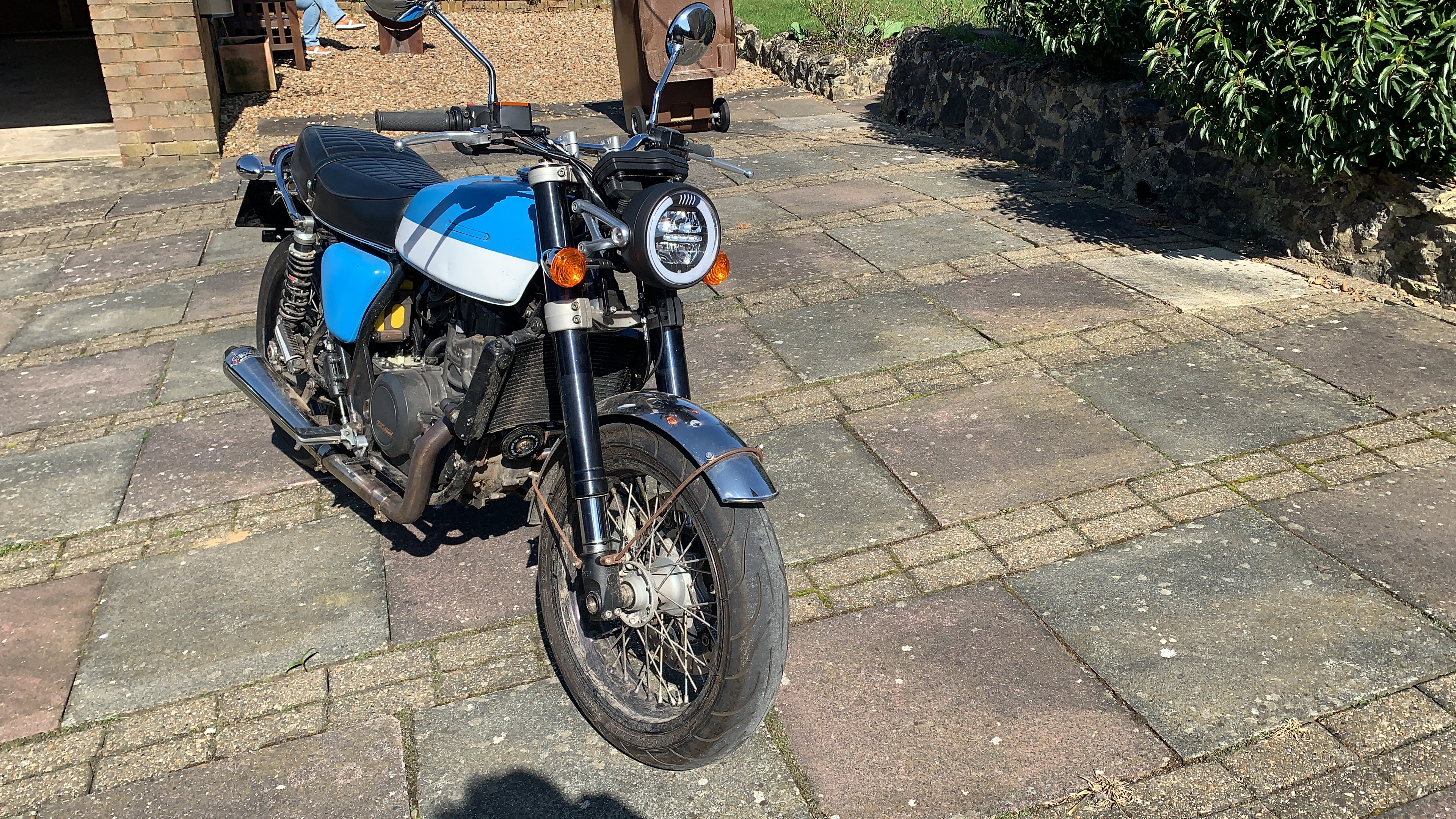

Just some more glamour shots. It's almost ready for the full teardown!

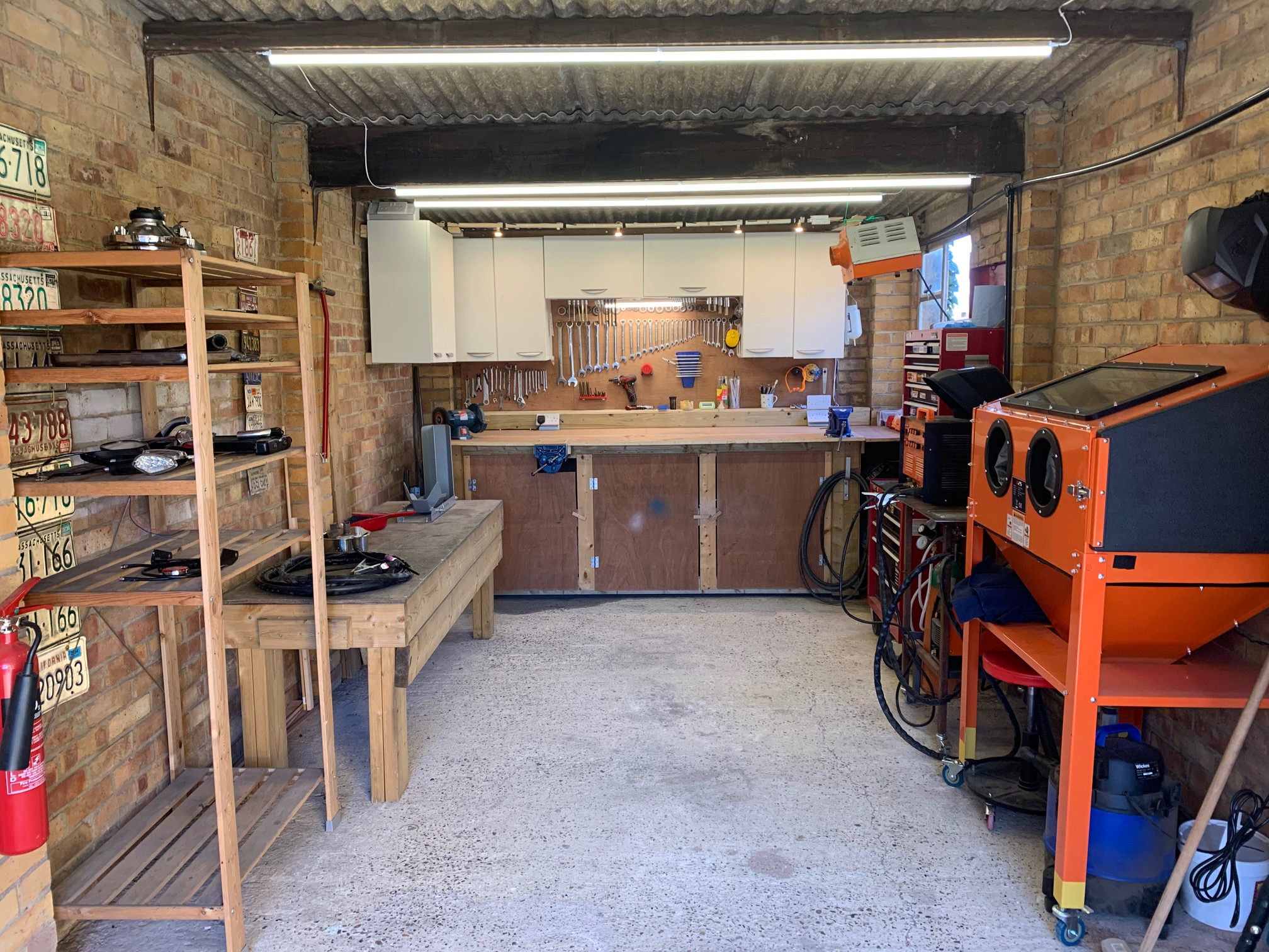

Current view of the workshop. I got an Inca Euro 260 bandsaw for £188, it is in perfect condition with all the extra bits like t-square, fence, beltsander attachments, manual and documents, etc. Well pleased. Ernie has inspected it and deemed it fit for service.

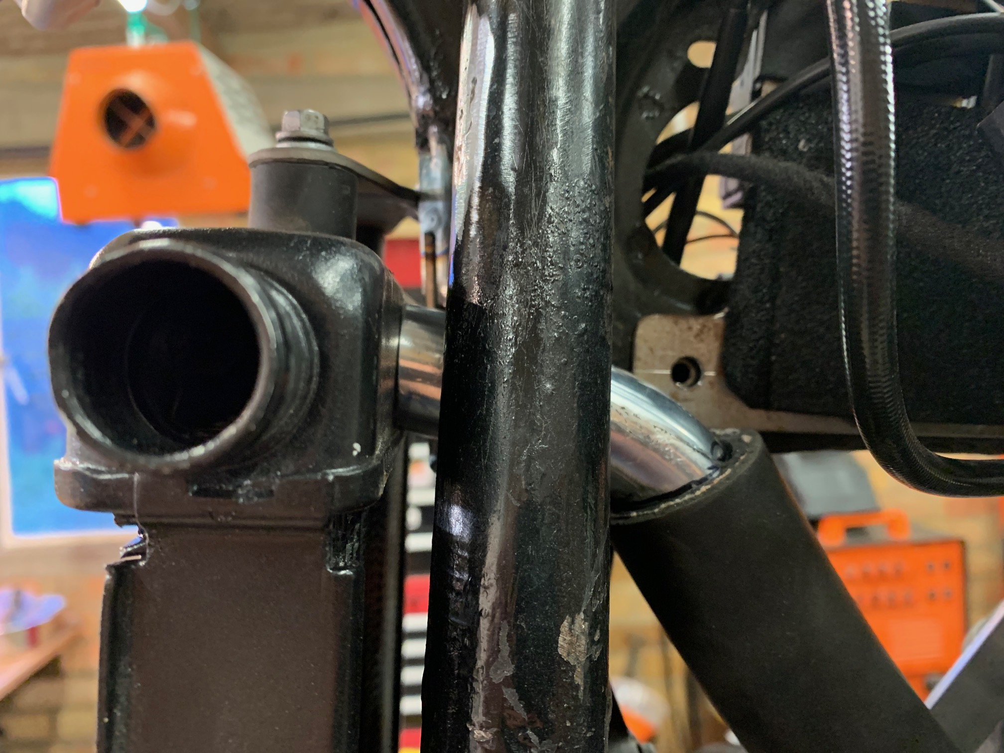

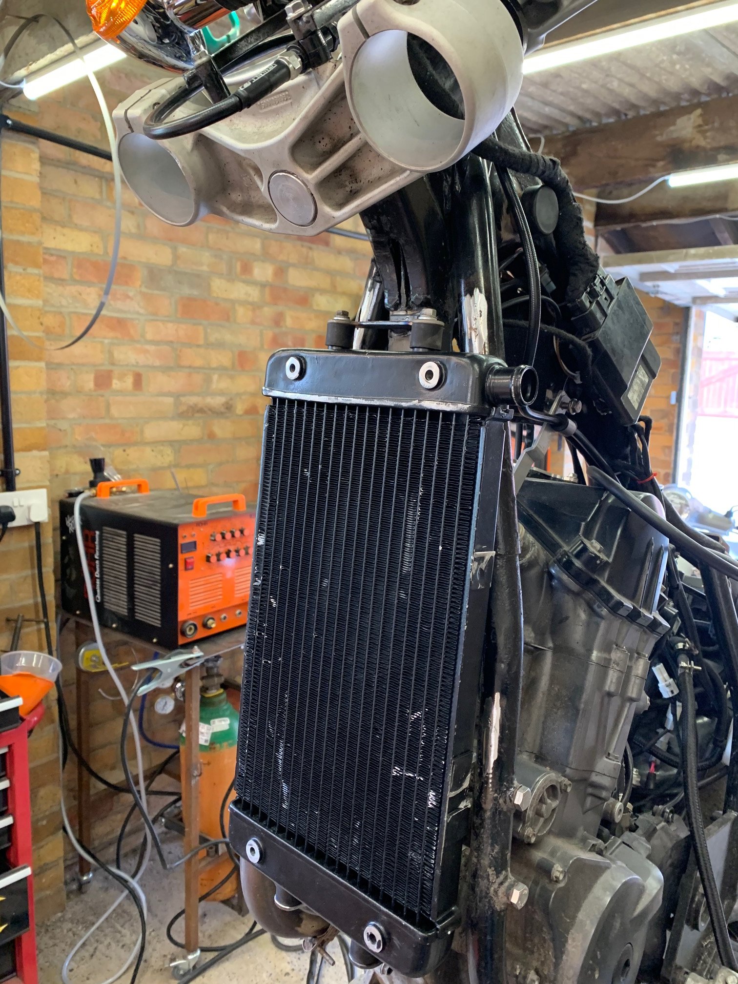

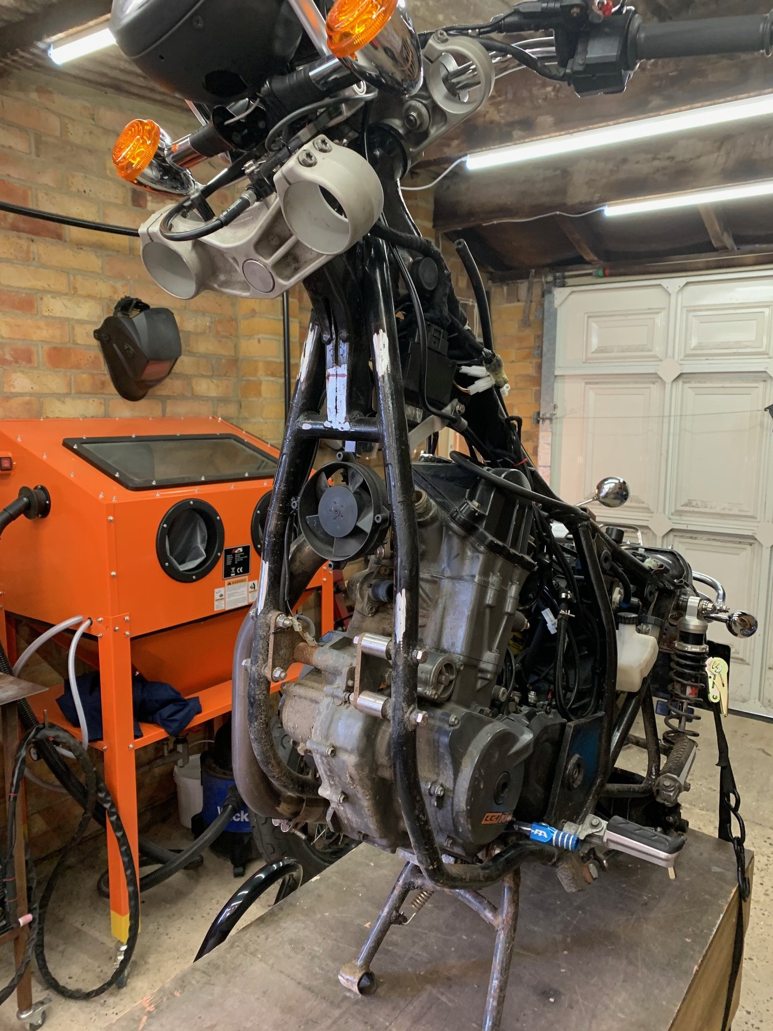

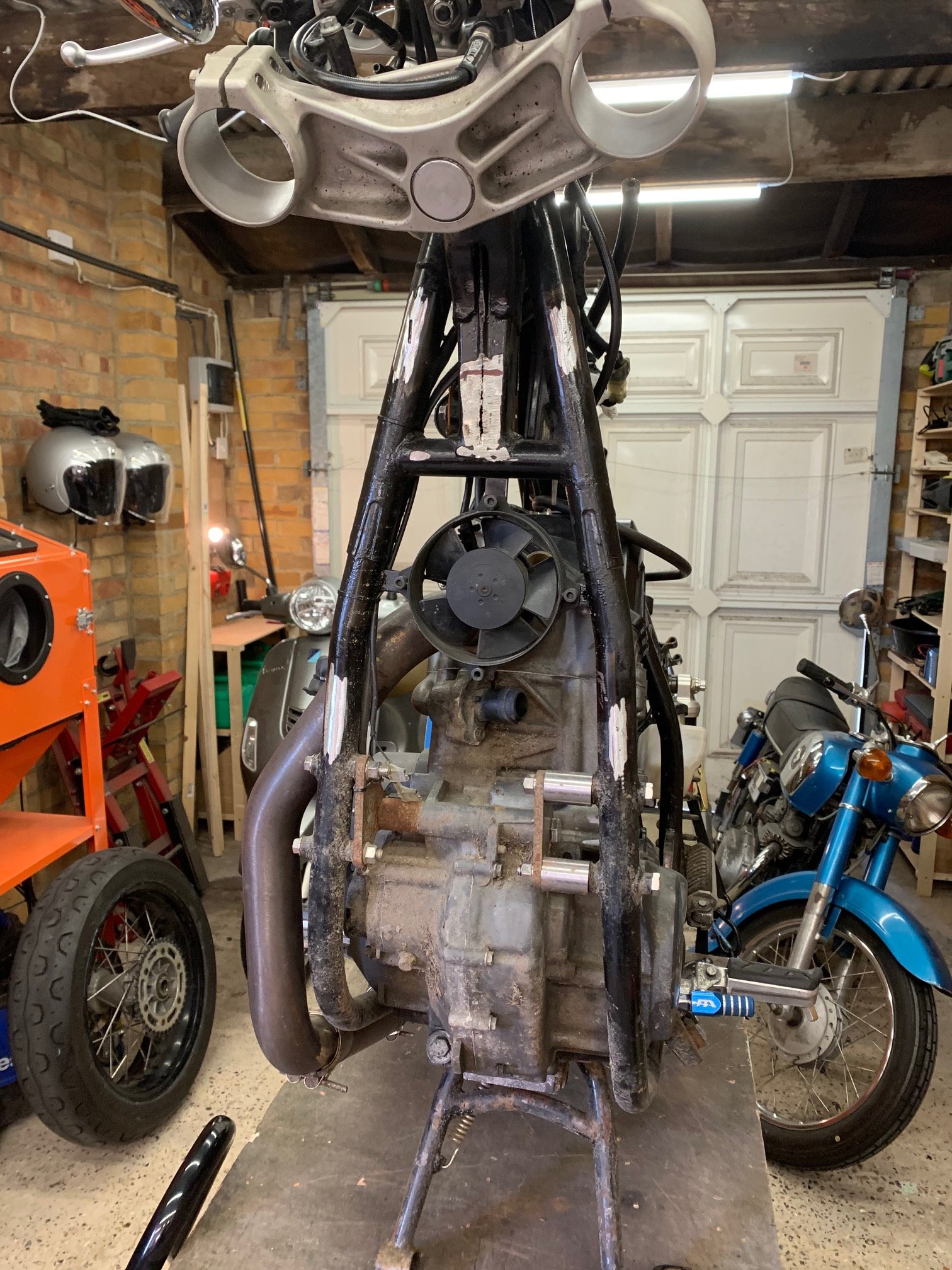

Back to the radiator again. Here the radiator is removed and the hoses mocked up. I removed both wheels and tilted the bike up for easier access to the area.
My aluminium welding is awful, and this is not the project to practice on. I think I will take the radiator I got and mock it up, tack it together, and use the radiator as a tool to show a professional radiator fabricator what I need. The prices are not too bad, £450 for a full custom radiator.

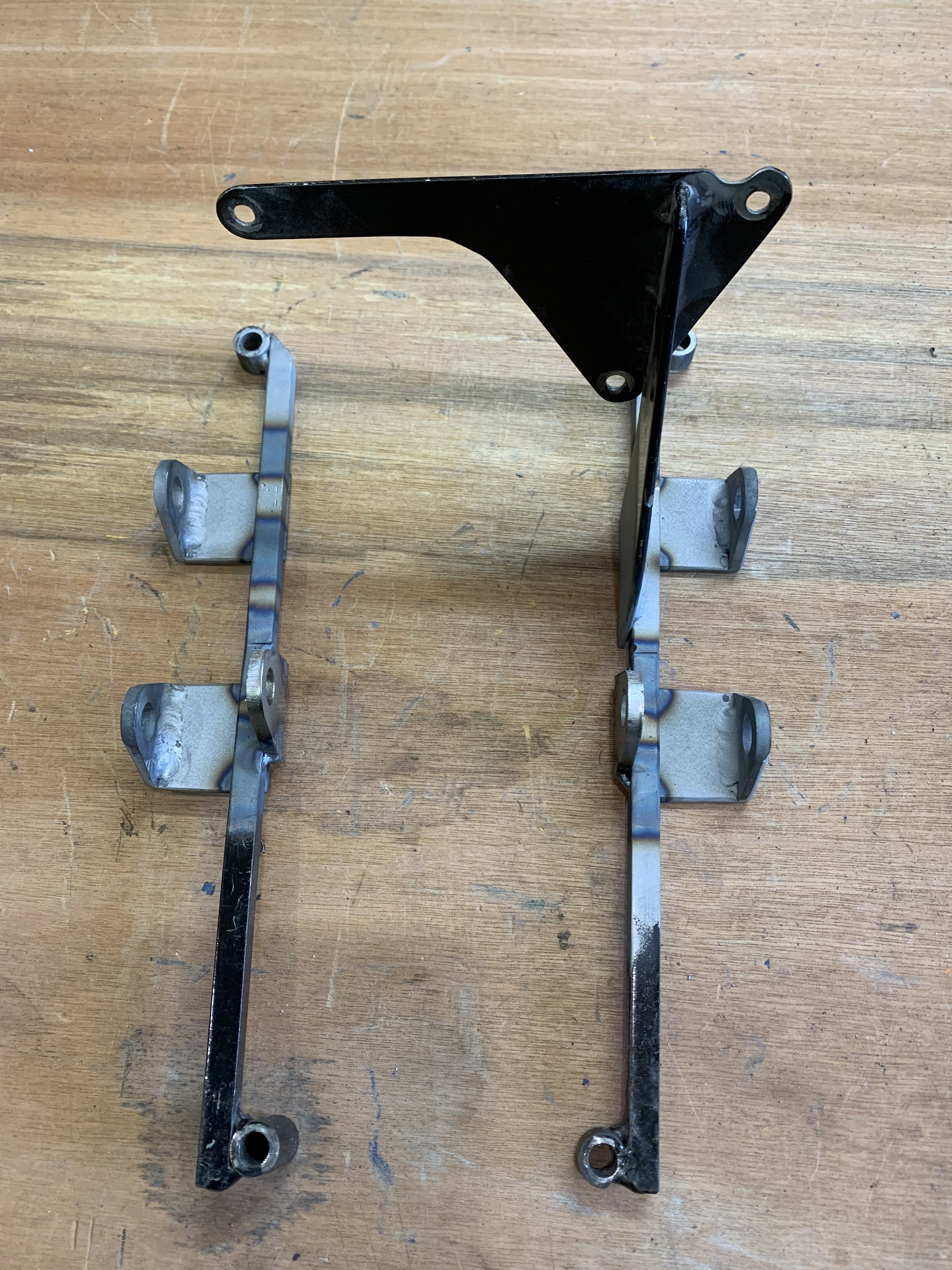

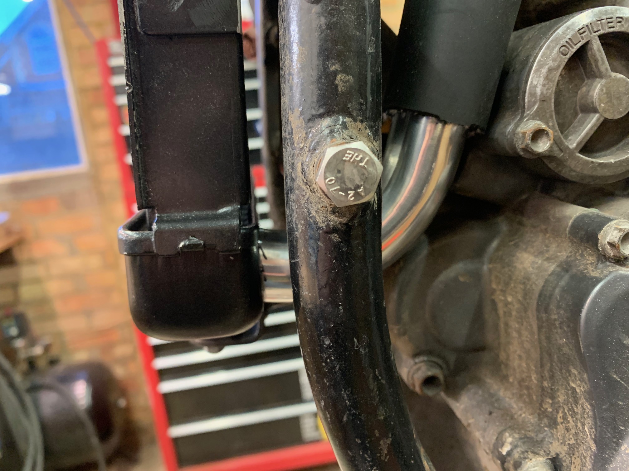

Bottom support done. This actually started as a top support but I measured wrong and it was too short, so it was repurposed into the bottom support. I decided to mount it to an engine bolt since it was convienent and it only needs to keep it from moving left and right. It is plenty secure.

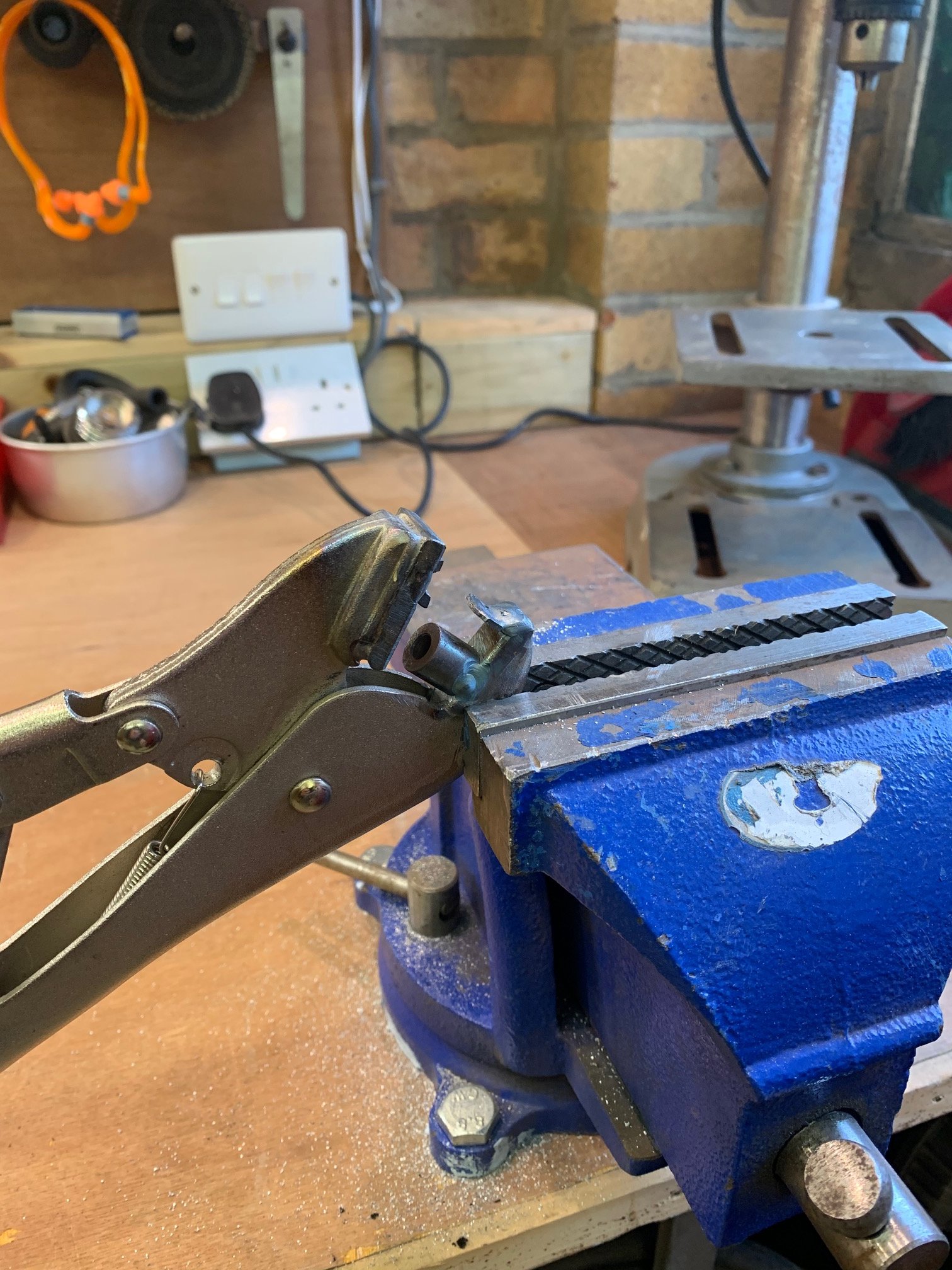

More radiator inlet and outlet mockup pictures. In the 3rd picture you can see my blood on the case cover, this was the result of essentially punching my vice. I was hacksawing through some aluminium and on the last stroke the metal gave way and my hand and hacksaw went right into the vice, bending back my index fingernail. It's not as bad as it sounds! Will be more careful in the future, however this is not the first time I've punched my vice and knowing me it won't be the last.
Next I will tack on the tubes to the radiator and do some more fitment trials.

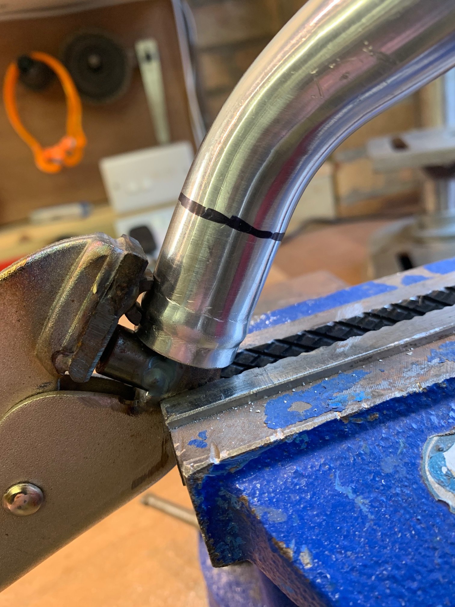

So I may as well have a go at welding this radiator myself, because if it works it works! With that in mind I made some modifications to my home made tubing beader and tried it out. It was very successful. The tubing diameter is 25mm, and the bead can be made to almost any diameter. I chose around 26.5mm for one hose and 27.5mm for the other hose. Being able to control the bead diameter was really useful for that, because 26.5mm felt way too loose in the bigger pipe, and vice versa.
