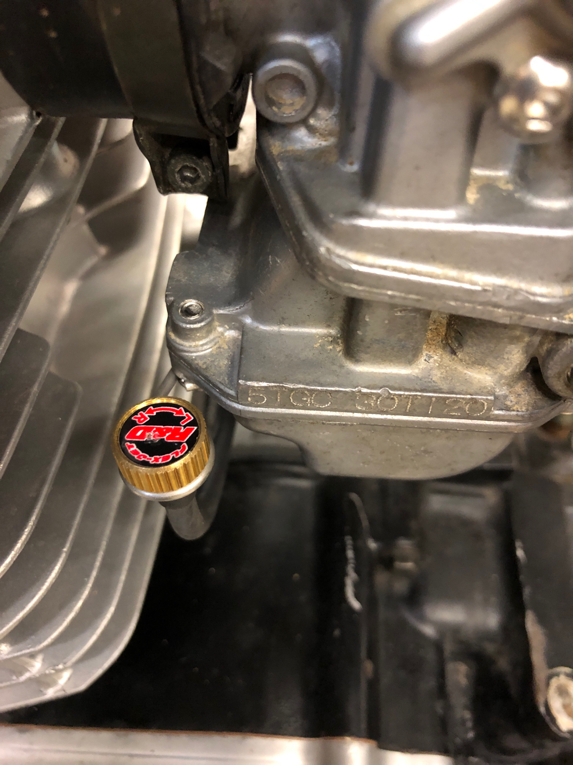

Whoever invented these adjustable fuel screws for the FCR is a genius. The factory location is ridiculous .
I put one of those on my dr650 for the same reason, though it was a royal pita to remove the old flexible one that had seized into the carb. Like trying to break a bolt loose using a wet noodle as a ratchet extension lol
Hahaha! That makes me want to put a dab of anti seize on there.
Do it. Do it now lol I did (on my second one) and have had no issue since.
