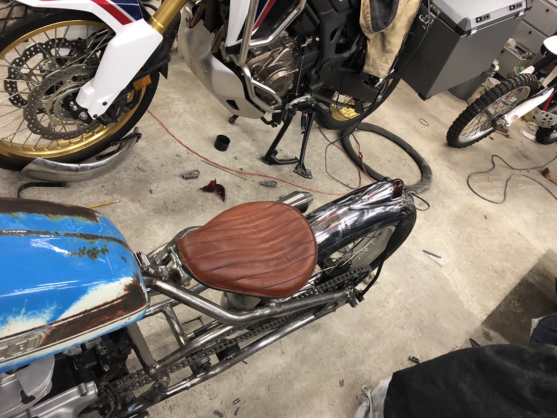

Got some more business done today. Powdercoated a batch of parts including the rear caliper bracket, the fender struts, and some superfluous other little bits. Next I had this piece of forward control shift linkage in the parts bin from an HD or something that I decided to turn into the rear brake stay. Had some nice grim joint ends and overall looks the part. Nice and rigid too. Turned down a frame lug out of steel and fishmouthed it to weld to the frame for the frame end. Then drilled and tapped it for M8. Works great.

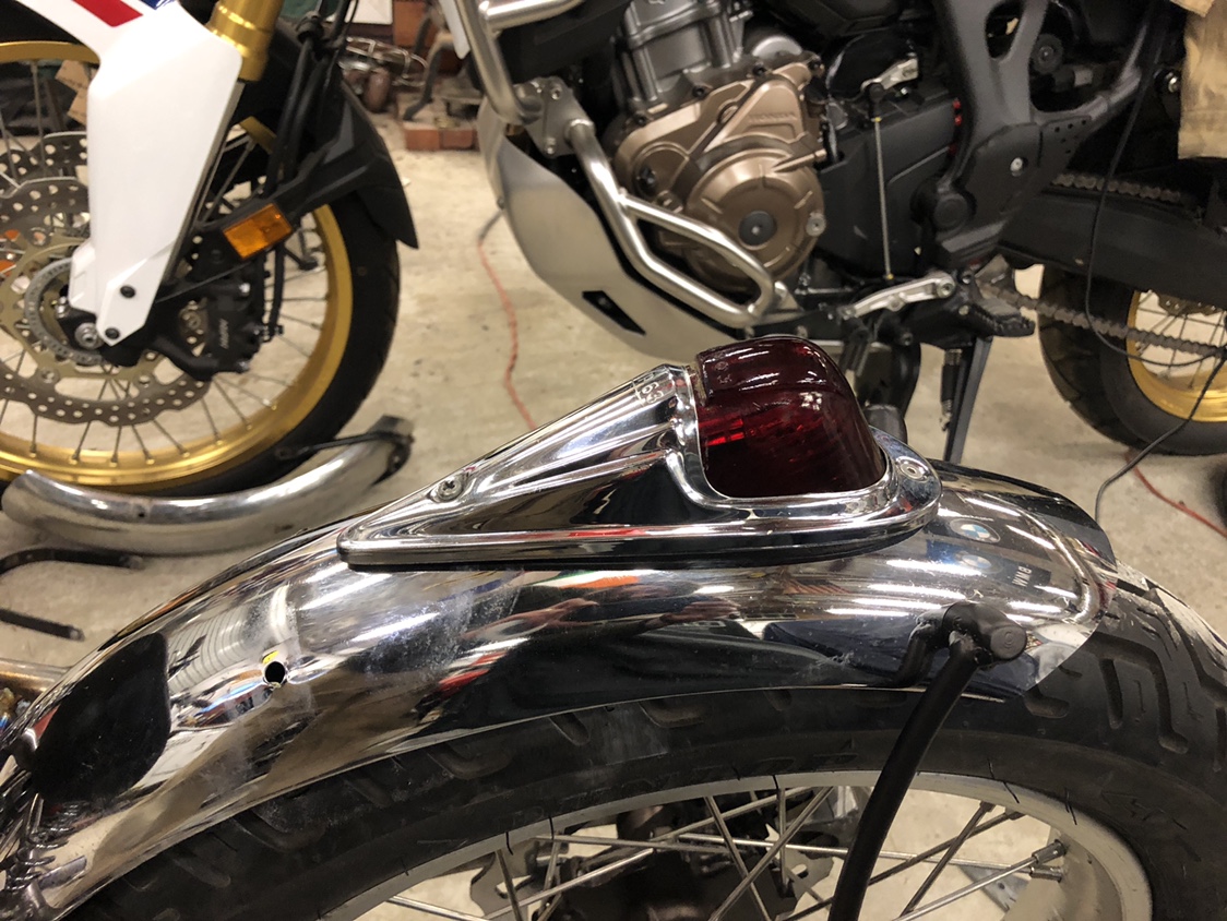

Next up I mounted up my tail light. Found a rad marker light from a truck cab probably from the 40s or 50s has a nice glass red lens and fits the fender contour nicely. Put a modern 1157 socket inside and got it all mounted up. Suits it quite nice!

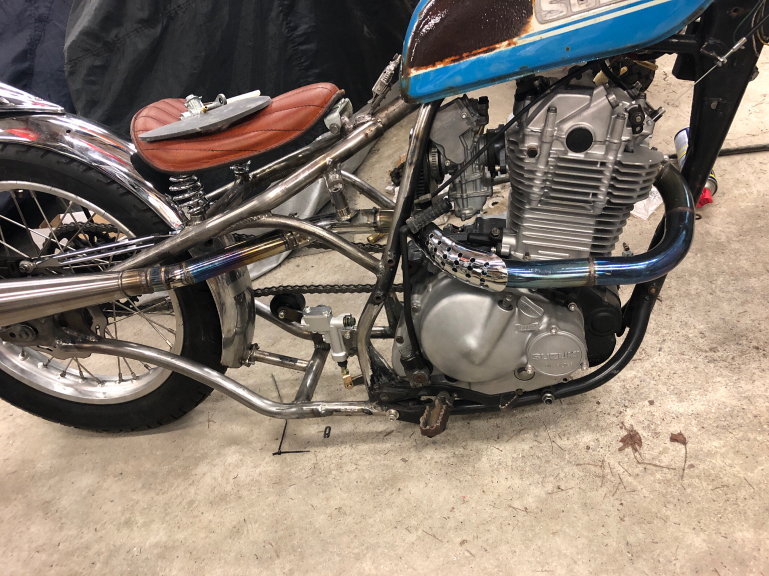

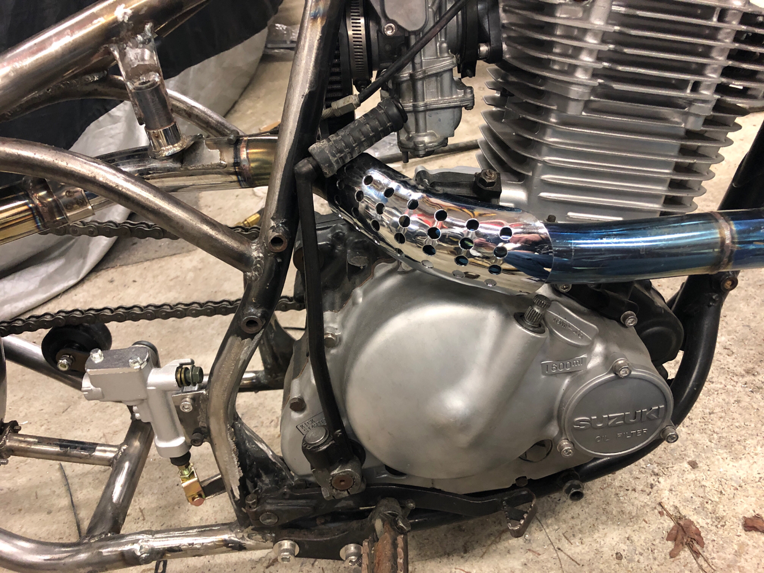

Didn’t get much done today but I did hack up a $5 auto zone turndown exhaust tip into a heat shield. Wanted something in that bend to keep me from sticking my shin into it. The curve looked right so I gambled on it and it fits perfect after a little grinder whittling and a drill press.

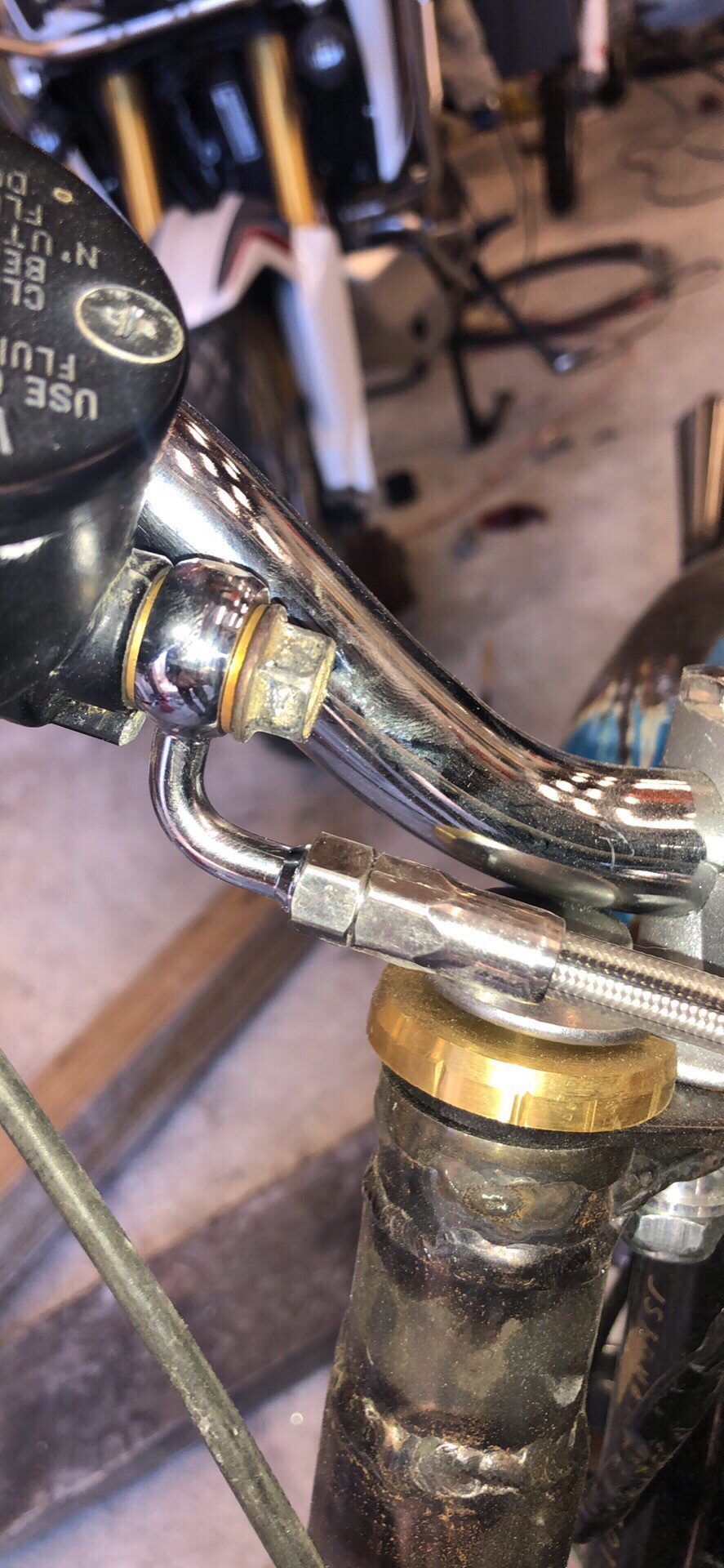

Spent this morning building custom brake lines. I used stainless hose and stainless fittings and went to work.

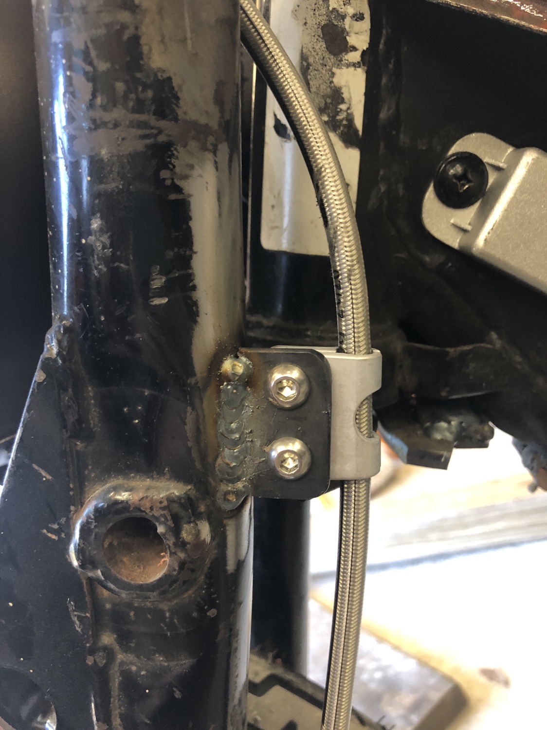

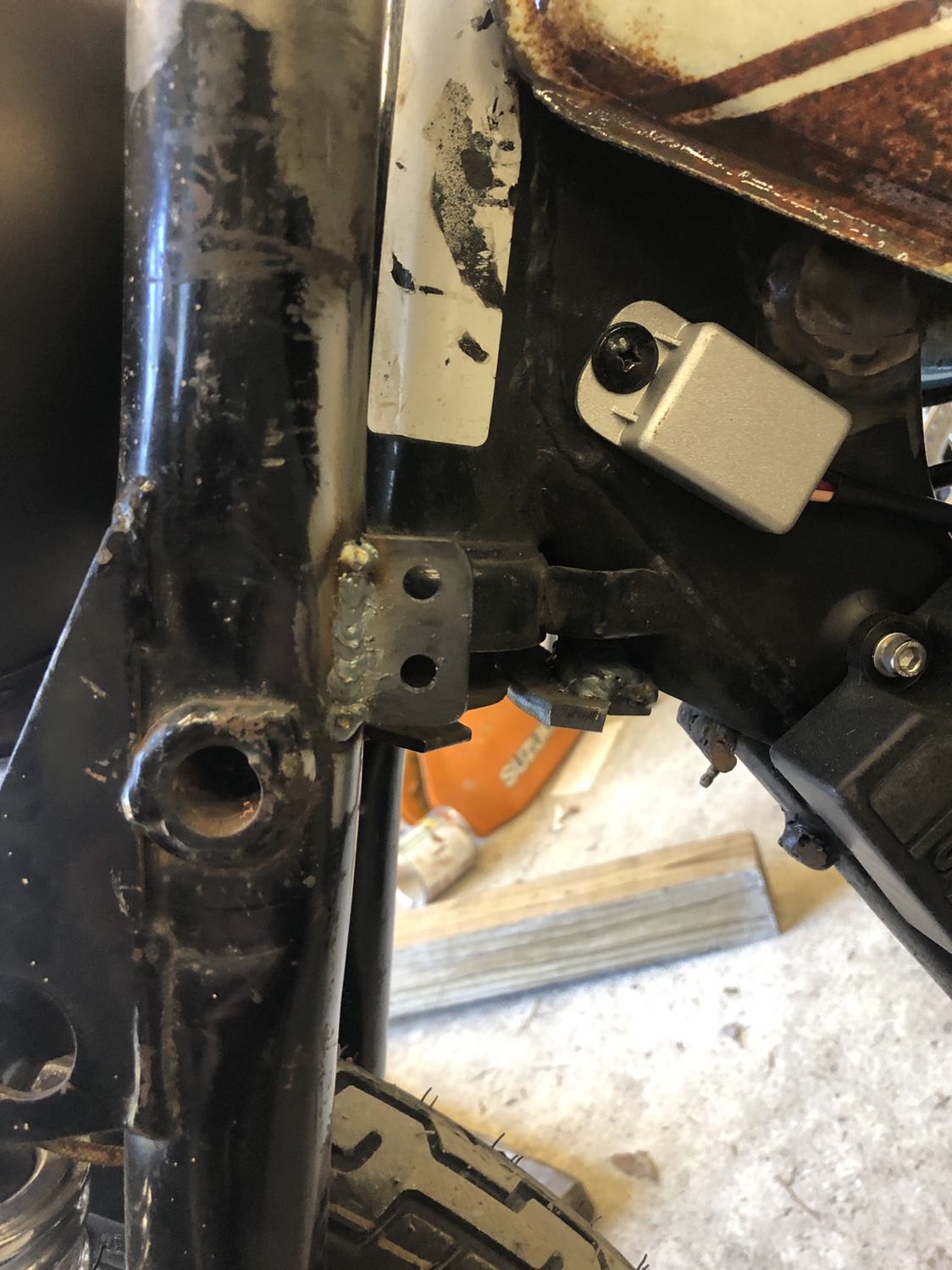

Next I welded tabs in the proper locations on the forks and frames to use aluminum hose clamps made for a pit bike to keep everything nice and tidy.
Ended up with three tabs on the forks and left a relief bend that I covered in asphalt wire loom and heat shrink to keep things from rubbing and causing abrasions where the suspension works:

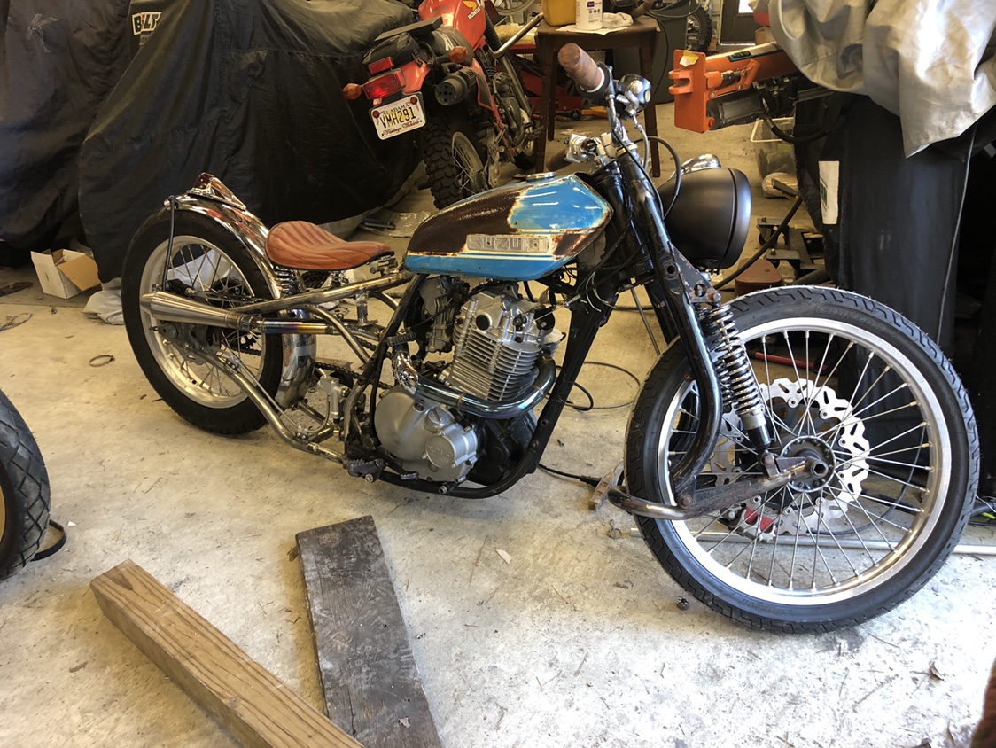

As she sits now. Really loving the stance of this thing:
Dude, really nice work on running those lines. Looks tremendous.
Totally makes sense doing your own hoses in that setup. Did it require any special tools?
Thanks man! No special tools. Look up the Magnum BYO (Build Your Own) brake parts. Really simple and really tidy looking installation. Just basic tools is all you need.
