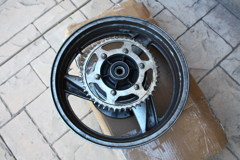

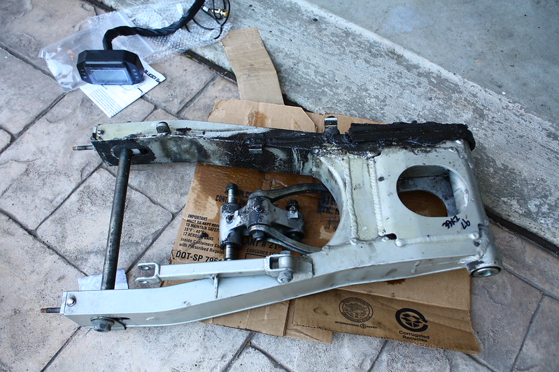

Okay brethren, finally somewhat of an update.
Got some goodies in the mail yesterday:
zx6e rear wheel with hub and sprocket. I'll be able to slap on a 160 tire woowee!
Dirty ass zx6e swinger. This'll give me a stretch of about an inch.

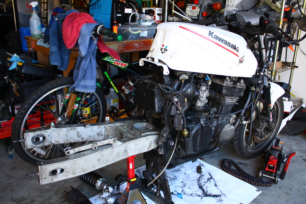

A new week, a new opportunity to DW 8)

I shaved this thing down the same amount on both sides to fit the new beefy swinger in. The stock swingarm and accessories look like toys compared to the new one. Pics of that will be posted another time.
This is how it fits, mind you, I don't have the swinger pivot bolt for the zx600e swinger and I'll have to make a spacer out of a poly bushing. The plan is to keep the hole centered to where the shock will mount. ::)
