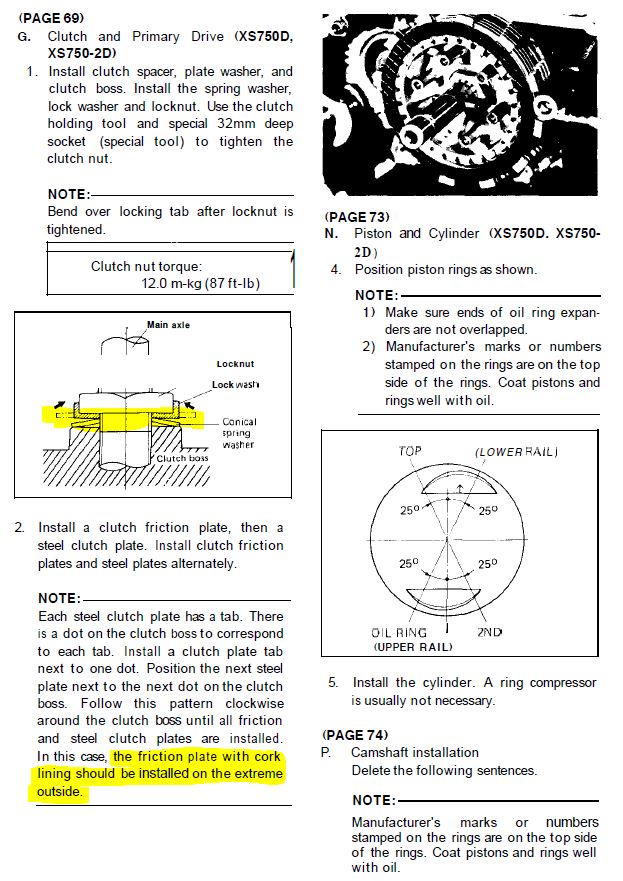

Hi Ryan
Found the document I was after, it was a service supplement for the 2D model. Not sure if it applies to your bike, but it might!
Cheers
Tim

Hey tim!
Could you please eloborate I don't really get it.
Aren't all friction plates cork lined?
Tried if the clutch releases now...no success even with the flipped actuation,i still cannot roll the bike forward with no resistance....
Tried to screw the mechanism screw as far as possible in (clutch was then impossible to pull) and even then it was the same...
Thanks!
Ryan check a parts fiche as some clutches have one different friction plate from all the rest and it needs to go in the right place or the clutch won't work. It should look slightly different and should have a different part number from the other plates.
Edit:
Looks like you don't have a special plate, if your 750 is a 79 at least. so the last highlighted comment may just mean make sure the last plate in the stack is a friction plate, not the other. the Fiche XS750AU posted is a little different from the one I looked up on BB. it looks to have a special plate but I think that is the XS850 fiche. Not sure but the stack starts and ends with friction plates.
Take the clutch side cover off so you can see the operation of the clutch. Put the throw out mechanism back together and put the cover and cable back on the bike. You need to understand how the adjuster works. The center screw is the actual adjuster and its purpose is to adjust the distance between the throw out mechanism and the rod that actually pushes the pressure plate which disengages the clutch by relieving the spring pressure. The adjuster is needed to make up differences in manufacturing tolerances which stack up from one side of the engine to the other. There needs to be a slight bit of space between the adjuster screw and the push rod so that zero pressure is applied when the lever is not pulled. So the screw should spin freely until the mechanism touches the push rod at which time you can still screw it in, but then you would be partially engaging the clutch. So screw it in until it touches and then back it out a bit to create clearance and lock it down with the nut. If all is well with the throw out mechanism, you should see the pressure plate compress the clutch springs just like your video when you pull in the lever. If you do not see this motion, you can check the throw out mechanism by taking off the pressure plate and placing a small screwdriver or punch against the end of the now exposed ball (which should be at the pressure plate end of the clutch push rod) and pulling in the clutch lever. You should see a few mm of motion like in your video. If you see that the throw out mechanism works but does not expand the clutch pack, the ball and push rod length is too short or the clutch pack is too far away for some reason. Unless the push rod got swapped for a too short one somehow, that length is fixed so look to see the clutch basket has not somehow been spaced too far away from the case for some reason - incorrect assembly maybe. If you see little or no motion of the pressure plate and/or the lever is super hard or can not be pulled in correctly, check that there is not an extra clutch plate in the stack or that it is not too thick. When this happens, there is not enough travel available to the pressure plate before the springs bind. This is not that uncommon when people replace their clutches and interchange plates of mixed manufacture, forget how many plates go where, or the aftermarket plates are too thick. There is no adjustment for the clutch itself except by replacing/exchanging parts. If you do see this obvious motion when you pull the lever (engage the clutch), and the driven shaft does not spin fairly freely, likely there is trouble with the plates, basket or pressure plate. Most clutches have all the friction (cork) plates identical and all the drive (steel) plates identical. Not much can go wrong with the friction plates unless they get fried, but the steel plates can get warped or bent. Take the clutch pack apart and take each plate out and rub both sides around on a piece of #600 sandpaper wet on a pane of glass. You should get scratches on most all the surfaces with very little sanding. If you have obviously bent or deformed plates replace them with flat ones. Bent plates can act like a spring retaining some clamping pressure even when the pressure plate is released and cause the clutch to drag.
