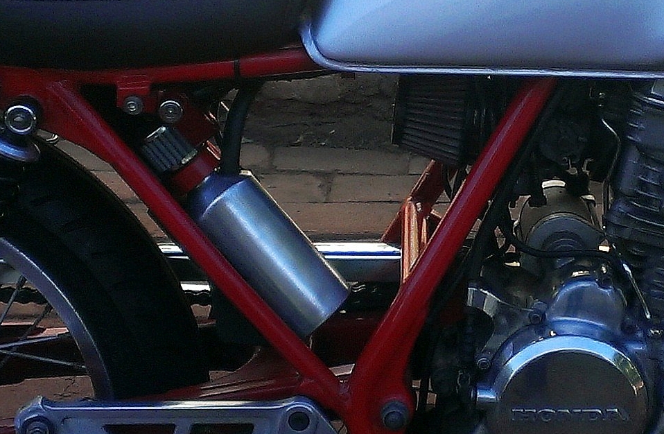

One thing that annoys me Is that I need a proper catch can or some kind for the crankcase.
When I stand on the traffic lights the fumes of the burning oil are intoxicating.
What are you guys using?

Hi Rian
Sorry to say but the exhaust gas is pushing past the piston rings, indicating that at the least the engine need new piston rings. :-[
Unlikely a catch can will stop all the fumes as it still needs to vent, and it must be burning oil out the exhaust.
Use a longer hose and filter and route it underneath the battery box up towards the seat. If it's just fumes: deal with it. If it's spewing oil (like mine), you're getting closer towards rebuild o' clock and a longer hose will help to have the oil run back into the engine.
Find a alloy drink bottle,clean off the paint/anodising(for something smaller have a look in the energy drink isle) .. drill a hole somewhere towards the top for the crank vent hose,cut the end at about 45 deg so it wont get blocked off if it hits the bottom of the bottle..then put in some loose coiled steal wool to trap any oil and it may help with fumes...put a filter on the top in case it gets a once over by the 05.....
