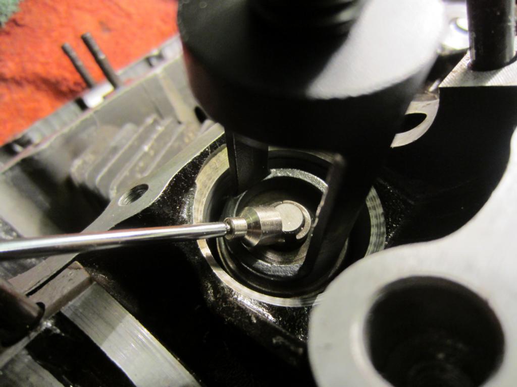

Yesterday I sat down and started pulling the cyl head apart...didnt find anything yet that would need renewal *besides the stone hard valve seals* :-).
There is no palpable play of the valves in the valves seats.

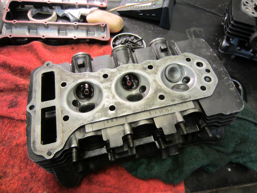

The XS heads are very robust, I would be surprised if you needed to do any more than lap the valves in and replace the guide seals.

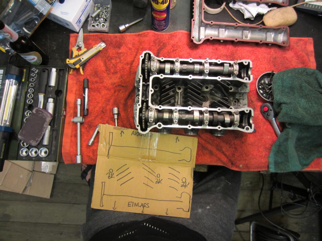

Here are some pics from the head dissassembly!
Cheers!

So there´s one BIG question: ::) ::) ::)
My aim is to blast the whole engine...
So I would now-->reassemeble the "hollow" engine with no crank and pistons, reseal it
There is a trusty blasting technician in Vienna that does really good work with glass beads, but I don´t think that I can get the engine leak free and I don´t want ANY glass beads going into my engine...
Der Nanno already advised my to remove all the gears and crank parts and then sealing the engine then blasting.
Already thought about soda-blasting the engine or dry ice blasting but as far as I know these methods won´t remove the factory paint from the motor...
How hard is it to remove all the transmission parts from the engine?
I´m afraid that I will never be able to put them back in the right way...

I would disassemble the whole engine. If you leave it closed, I am a strong believer that sand will get into your engine somehow (even by a small amount), and I don't like having sand in my engine.
If you take a lot of pictures during disassembly, especially of the details, it normally won't be a problem. It's just scary to do it for the first time.
And download a workshop manual or a haynes manual or something else of that type. Helps alot.
Tip: If you have parts that look identical on first sight, or parts which orientation are not that obvious, mark them somewhere visible with a color that stands out before you take the pictures.
Extra tip: Store your pictures as fast as possible on your computer/ hard drive, before your cellphone falls down in a bucket of fresh warm dirty motor oil. The bucket sends the pictures to the deepest, darkest pit never to be found again. (Ask me how I know :-[ )
