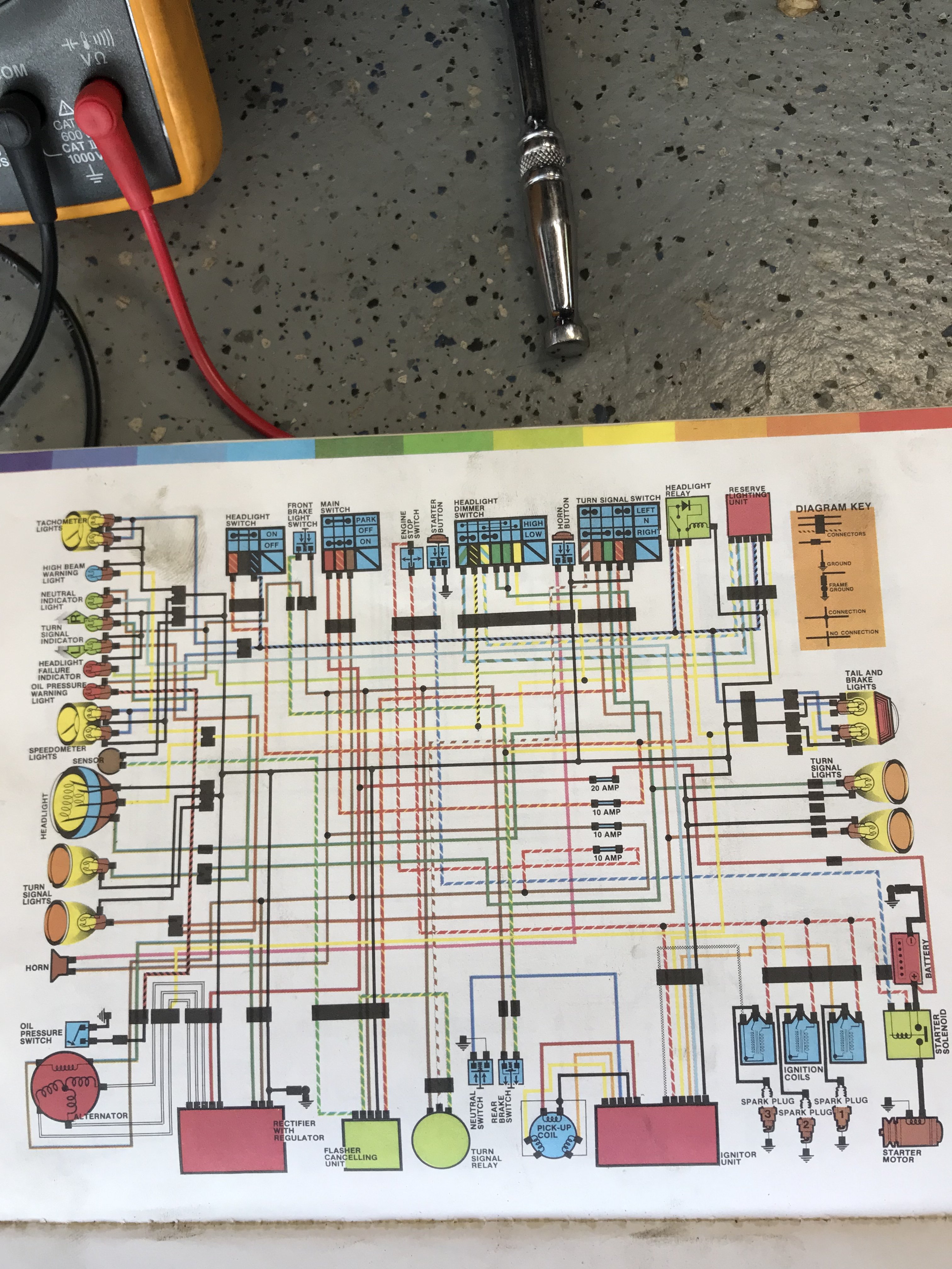

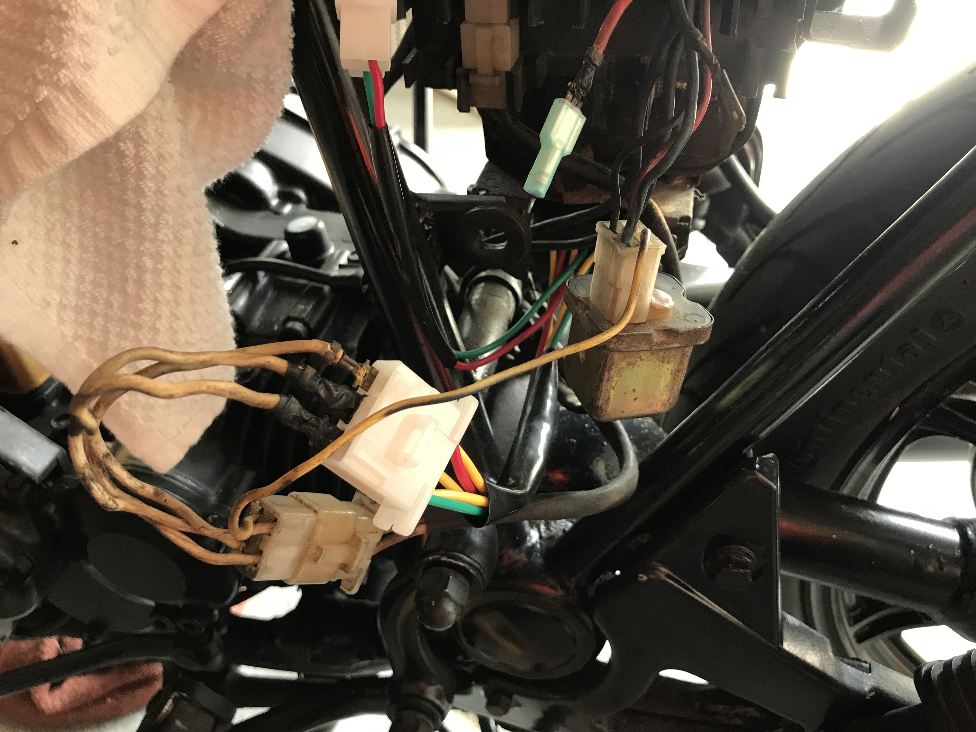

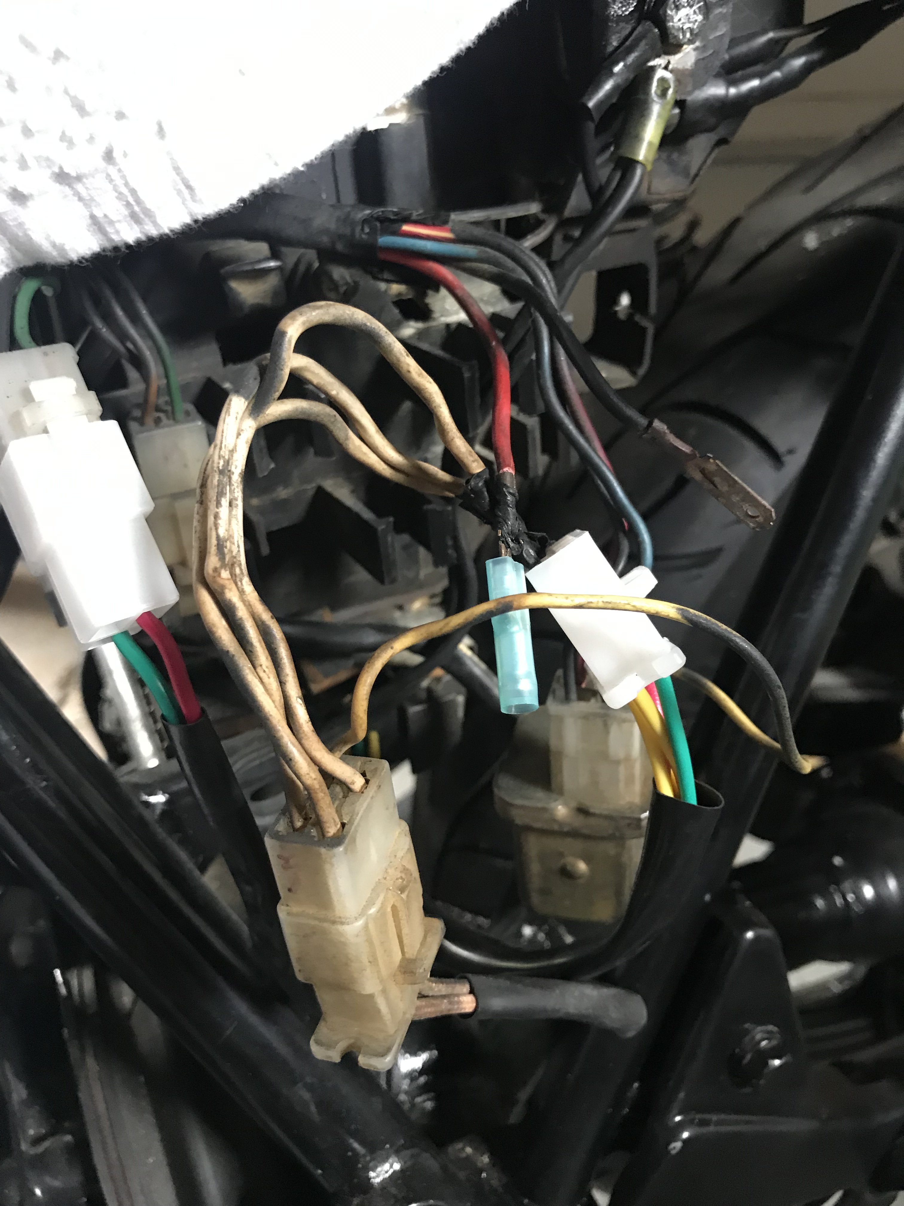

My 79 lost charging, traced it back to a coil with no continuity from the plug. Is this common? I assumed it was the R/R too, the previous owner did a little hack job on the left side with auxiliary lighting so hopefully I can clean it up soon. Can you test the stator itself, pulled the cover off and appears clean?
Sat all last summer from my wife deciding to get knocked up twice, fired up second kick but no charge to the new battery. ‍♂️
Edit, buttoned it all back together and now I have continuity between all 1-2-3-4 white wires. Might just light a spark and get insurance, don’t have time to think about a phantom short or redoing the harness.
Where do I go with the new rectifier and regulator? With nothing plugged in on that side, everything works(lights, ignition, starter) except the charging system. This has an igniter unit so I guess I own an SE special.
Sorry about the mess, any assistance appreciated as I am limited with time to troubleshoot. Trying to get this bike ready to sell, motor has a little port work singing through triple MAC long-tubes to single megaphone. I’m an engineer so logic is my thing, not electrical schematics. The last owner cut out a plug going to the white coil wires so I’m constantly blowing fuses trying to test and check where this eBay xs750 R/R connects, I confirmed the OEM unit was blown. Edit- I previously tested the new R/R while running, there was minimal A/C voltage between the white wires which is typically a stator failure.

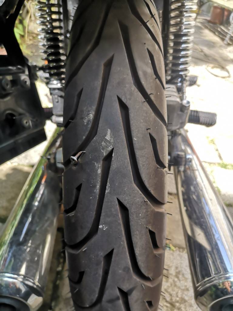

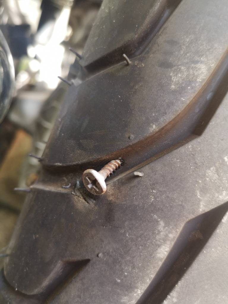

The bike is off the road again....
A #### screw is stuck on my tire. Looks like a drywall screw....
Happy that the tire deflated slowly and I wasn't driving fast... Stay safe guys!
I guess I need to remove the rear tire drain the kardan again...
Is the little hole made by the screw repairable and just replace the pneu on the inside or would you guys shell out for a new tire? The tire is brand new....
Thanks guys...
Gesendet von meinem EML-L29 mit Tapatalk
I have plugged tires. I know a lot of guys will say just replace the tire, that you will die, the world will explode, a volcano will suddenly appear in Vienna and burn the city down, but I have had no issues plugging a tire from a simple puncture like that. A tear is another story, but a puncture, no problem. If it's sidewall, I would also also say no go, but I have the impression we are not talking sidewall. In fact, when I brought my BMW home, the PO ran both tires with Slime, because it has Lester mags which are notorious for losing their seal around the beads from oxidation. Who knows how long he ran them that way, but I know it was for quite a while.

Thank you irk.
Safety is of course a concern but my budget too... Shelling out another 140 euros for my back tire. No.
I will post a pic later of the screw... It's not sidewall it's not straight in the middle but in one of the 'deep' parts of the thread...
Hope that there's nobody around that messes with my walrus and puts screws in my tire.#paranoiaoff#
New tyre, especially if you're running a tube anyway? B*llsh*t.
(Unless you have shares in Metzeler/Pirelli, then of course you have to buy all new tyres for all your vehicles, including your aunt's car.)
Seriously, just fix the tube with a puncture kit and refit it.
