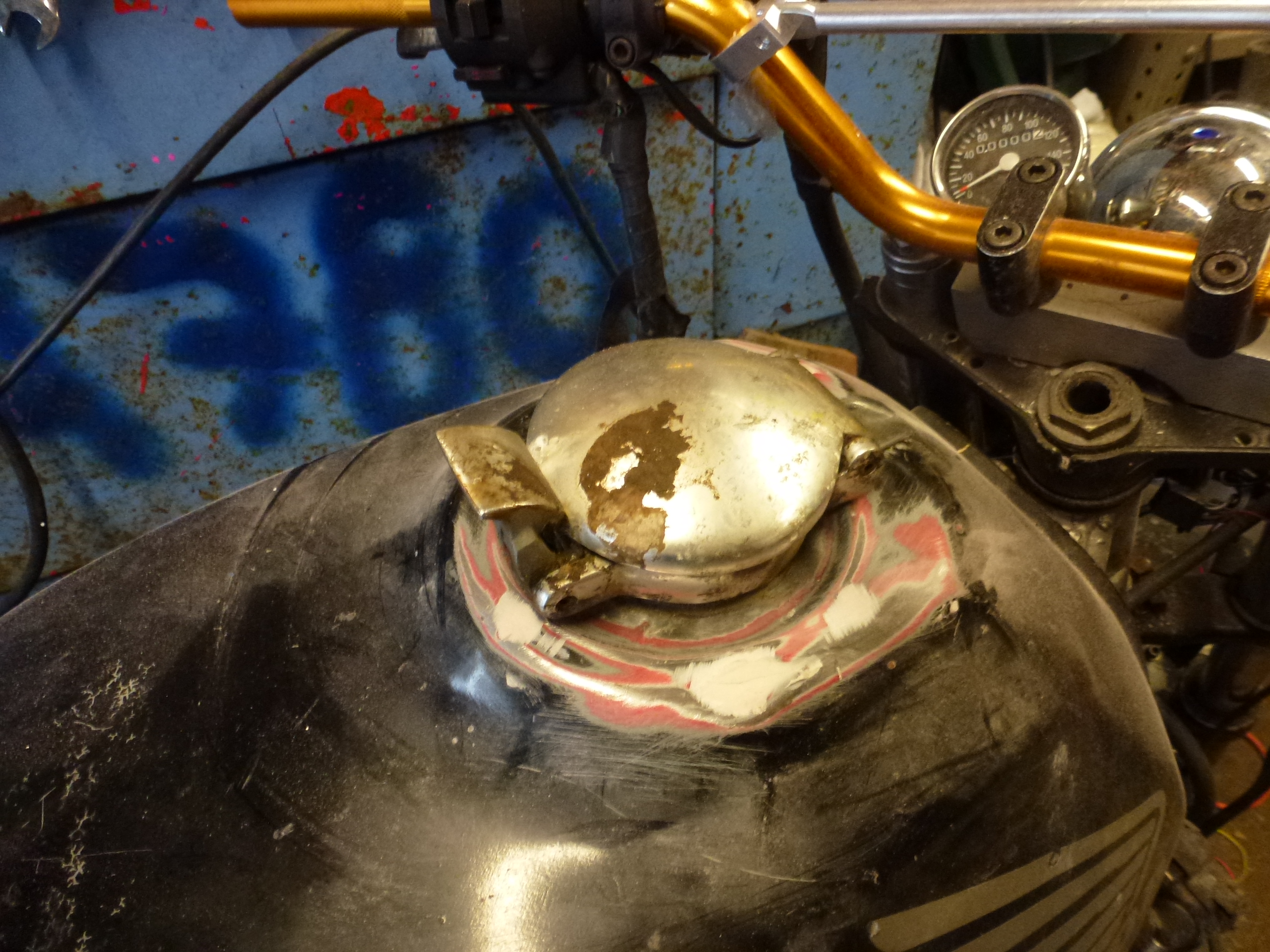

Decided to bite the bullet and ditch the OEM petrol cap - which no longer fits due to someone being a bit barbaric getting the old locked one off !! Still had a large Monza flip cap from my days of replica Porsche 550's and Speedsters. I also still had a filler neck which I was able to cut down and bond with "Wondermetal" [ ? ] to the original tank opening. Different ?
