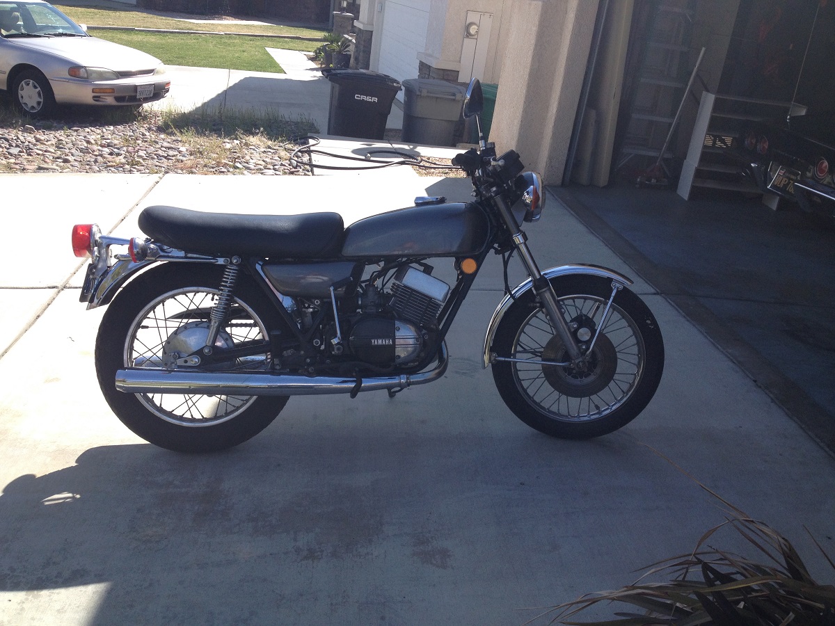

After a bit of looking found one locally, owner claimed to have owned it for years and recently had a case split rebuild done(over size pistons and all new lower end bearings/seals). Bike was poorly painted metallic gray, sported a Brit bike sized 4.00x18 tire on the rear and had what looked like a entire couch worth of filling stuffed into a stock style seat cover but otherwise was all there and in pretty good shape.
Ran pretty good but was tough to start cold and would intermittently drop cylinders on anything but brand new plugs. After a carb rebuild tune-up and new coils(a must do on these bikes still running original coils) ran great, started second kick in the cold and never missed a beat.
Here is the only pic I have as it was all it came home to me.

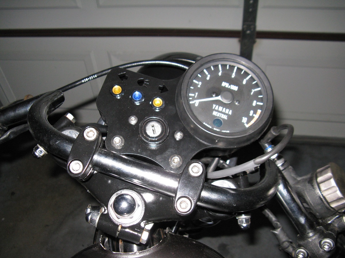

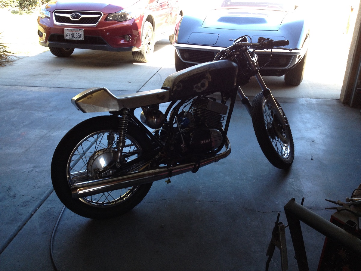

Then started to formulate a plan. Started by doing the typical removal of non-essentials like fenders and passenger pegs then made a new gauge cluster to lower the gauges and get rid of the speedo altogether. Didnt like the factory tank(looked too peanut like) so got a hold of a Ebay RD400 coffin tank. Tank was locked, had a peeling previous coat of sealant and seeped fuel when full. After welding up a couple of the larger holes, I cleaned and resealed the tank and got a new cap(still available from Yamaha). Also replaced the rear tire with the correct size, started playing around with bars(its nice to have a few those cheap Bikemaster bars in differnet bends) and shapes for a tail.

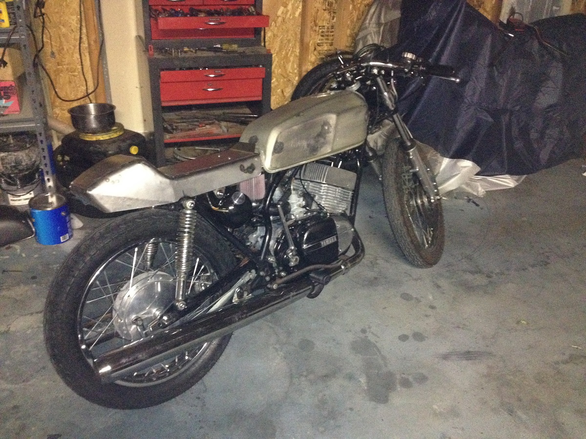

After finding a shape I liked I started working on the tail. Ended up making a structure out of 1/4 steel bar to support the rider relocate the voltage regulator and battery(ended up using a anti gravity since the battery ended up being mounted so high).
Then started working on the tail. Made it out of steel sheet using my 110v welder, a piece of tube to use as a rounding die, a nice straight edge to bend on and a pair of tin snips. It sandwiches between the framework and seat and is located fore/aft by grommets mounted on tabs and bolted to frame.
Top welded on and ready for final shaping. The two holes are to access the front mounting bolts(rear bolts are removed from the underside of the tail.

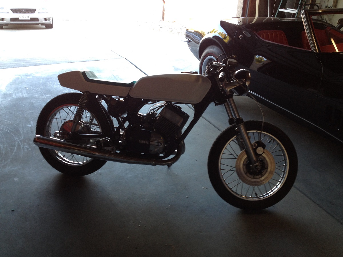

Final shaping done and ready for paint prep. After relocating the battery and voltage regulator to clean up the looks I decided to change out the reservior for the oil injection system. Had a local chopper place make me a custom sized tank then using some tabs from Lowbrow rubber mounted it under the seat. Holds about 1.5 qts and is enough for around 3-4 tanks of fuel.
Body work on tank and a seat pan. Pan uses 3 nylon mounting pegs that fit into corresponding holes on tail. 2 holes are in the seat area and one is where the rear of the pan kicks up so the seat has to be slightly bent to fit in and locks into place when the pan relaxes.
Primered up and seat padding. Used a walmart yoga mat for padding, nice and soft, a bit stretchy and solid enough to form easily with a electric turkey carver and a grinder disc.

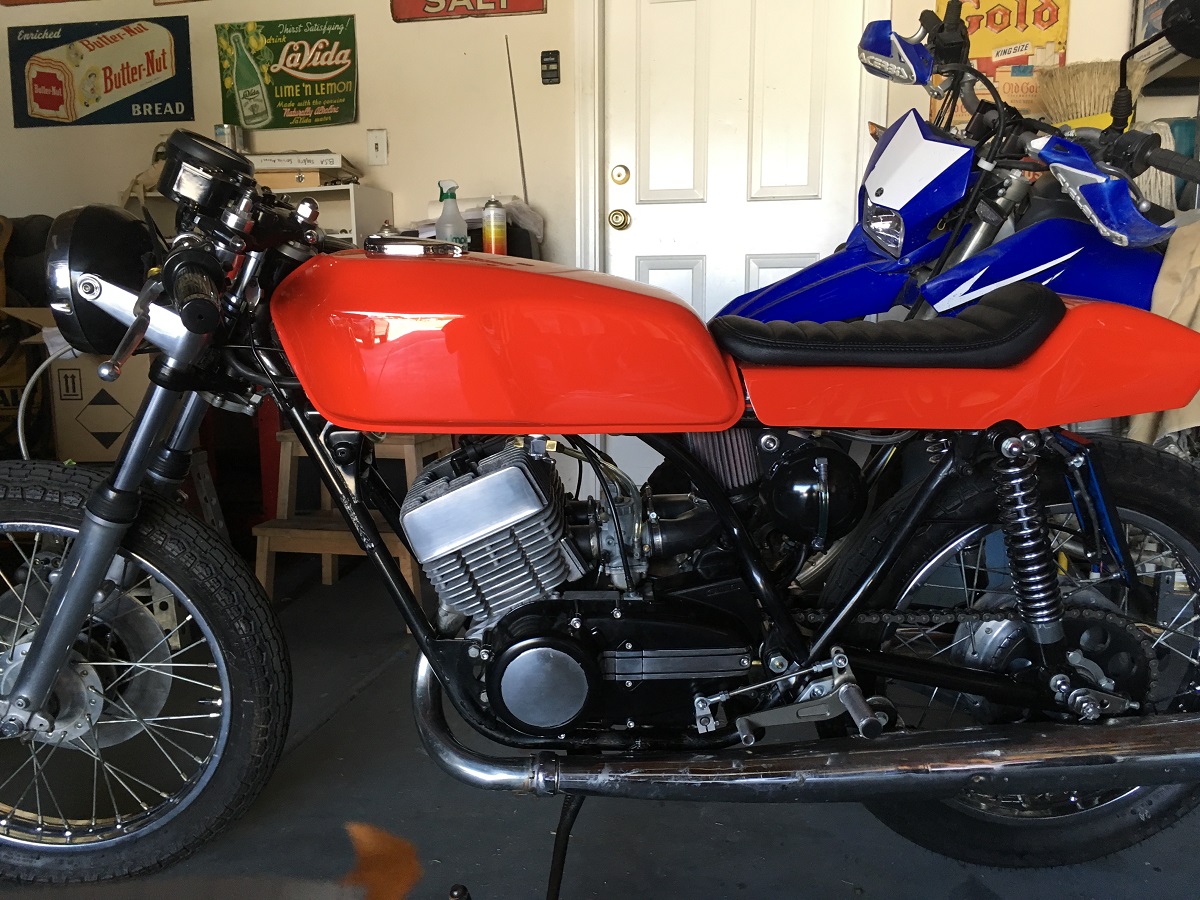

Here it is painted and reassembled. Liked the color but with all the additional tin from the new tail looked a bit too plain, I'd have to fix that somehow. Had to use a Pingel petcock as the factory 400 petcock interfered with the cylinder head.
During the paint process alot of other parts showed up. Removed the factory headlamp ears and replaced with some generic aluminum ones. Got a set of rear sets from Fast from the Past(very nice piece of hardware), replaced the rear shocks with Hagon ones and rebuilt the front forks with Race Tech springs, cartridge emulators(probably the best thing I've done to this bike so far as far as riding enjoyment)and a new set of fork caps with built in preload adjusters. Also did a 520 conversion while adding a few teeth on the rear sprocket. Made a rubber mounted, fast removal license plate holder using a LED frame and some scrap metal. Had the seat upholstered and replaced the levers with a set from a 2015 XT250(nice and short). Painted the case covers and replaced hardware with socket head stainless bolts and installed some Tarozzi clip-ons with Beston style grips.

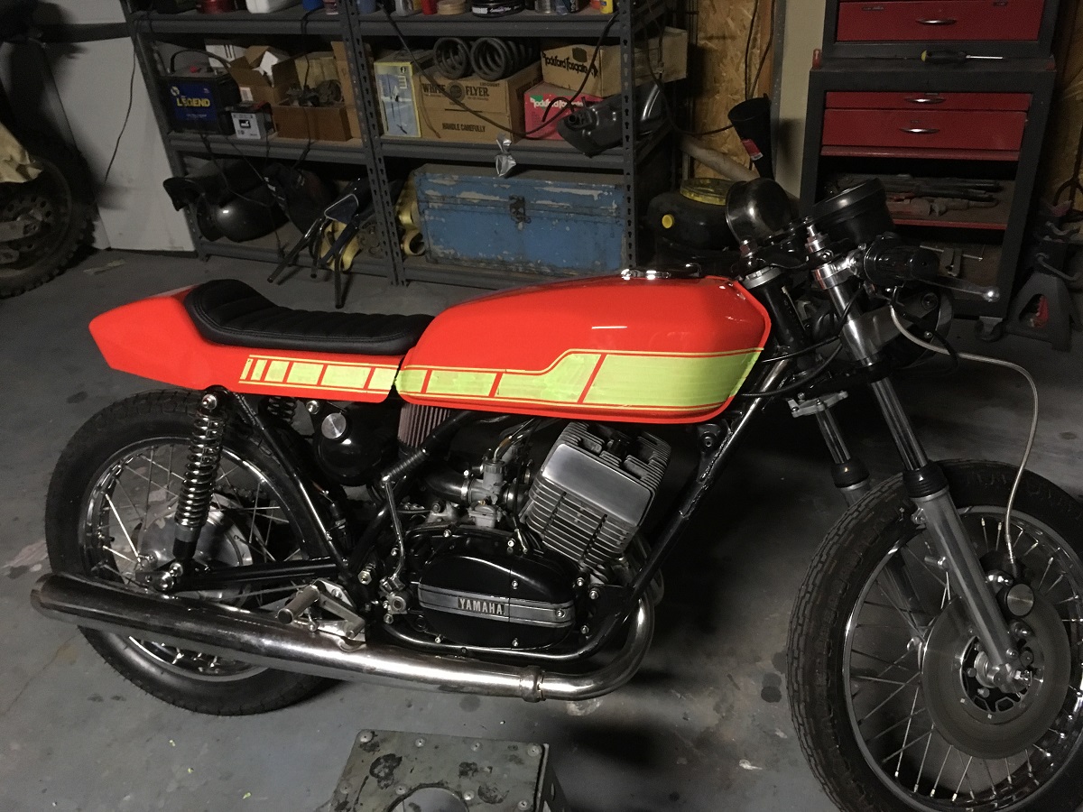

As I said before, the bike looked too plain, had to do something to break up all the orange. Decided to do something that looked at least somewhat OEM(the idea behind the overall build was to make something that Yamaha could have offered to the public similar to Daytona special). Played around a bit with a few designs but ended up with a Yamaha style racing stripe and had it printed up by a local shop that does wraps on vehicles. Hers a few pics of the evolution and the final product.
last mockup in tape and finished product.
