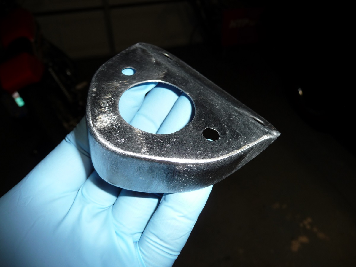

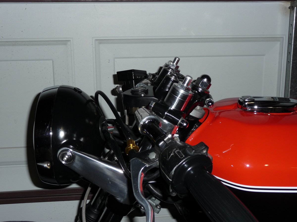

Sometimes we have to compromise our principals. From day one I told myself that I'd keep the tach on this bike. While not a neccisity, I alwyas felt it was a nice and practical thing to have on a street bike and so despite what it does to the looks I decided I would leave it on. Well, as time has gone the looks of the tach has gotten to be a bit too much to live with and I decided it had to go. I could justify it by saying that it wasn't very accurate, bounced alot, was heavy and kept rattling it self apart but the real truth is that it was ugly and Id have to make to make the painful admission tha sometimes form wins out in the form vs. function arguement.
Thought about it for a bit and decided the only indicator that I really needed was a nuetral light. I had initially thought I would someday install turn signals but recently resigned myself to the fact that I'd never find a set I like. While I was at it I also decided that I really didnt need a high beam indicator either.
Keeping all that in mind, I made a new dash for the RD. Quickly fabbed up a mount for the ignition switch and installed a LED indicator in the headlamp shell. Used a black rimmed LED so that when unlit would nearly disappear into the background.

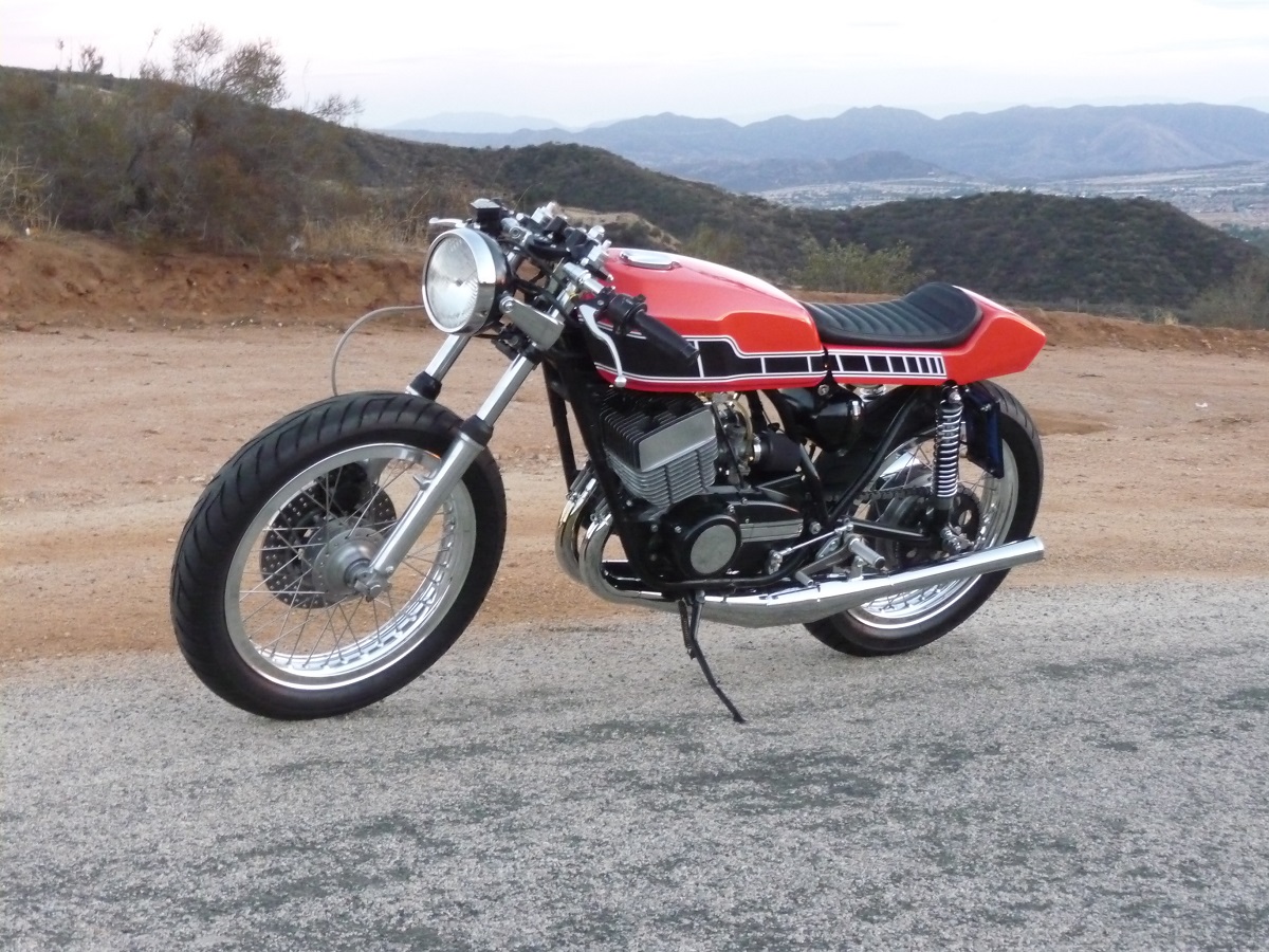

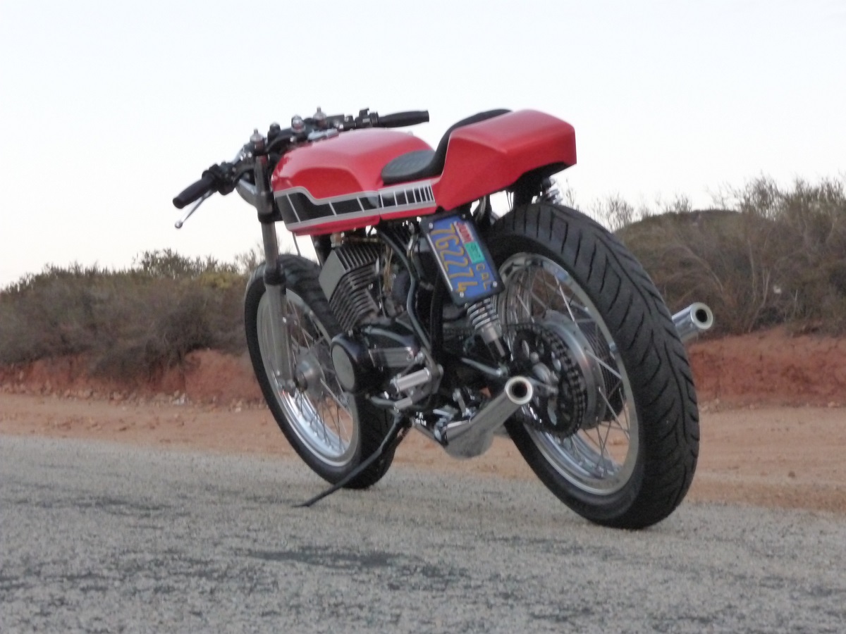

Was mowing the lawn today and noticed the sky was looking somewhat interesting this evening so in order to take advantage of the nice backdrop I took the bike up into the hills to take some pics. Still struggling with making the new to me camera do what I want to do but here are a couple that came out decent.
Looks good but how do you know how fast you are going?
Does the old bill not care where you ride?!

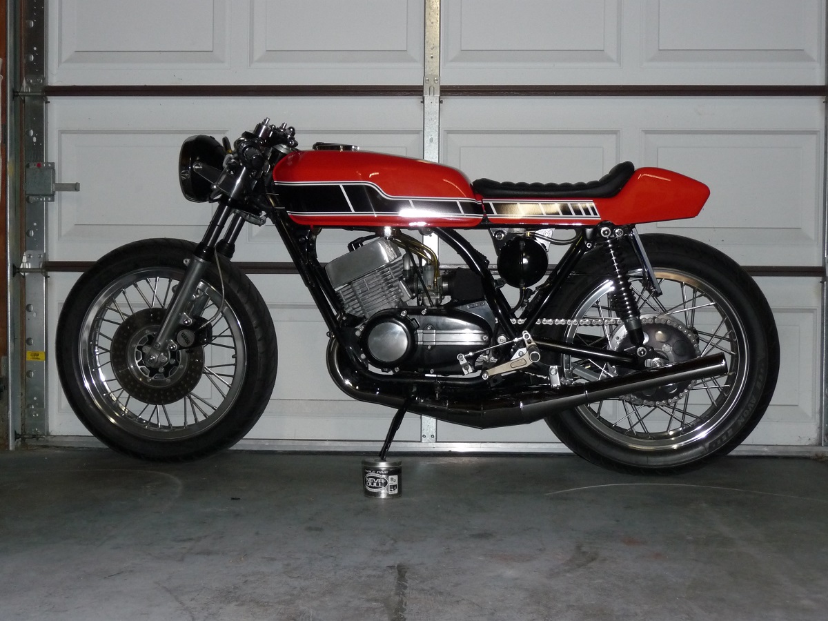

Finally got around to putting a real effort into getting the frame geometry right. The bike handled pretty good for bike of its era(makes my BSA lightning feel like its frame is made of wet spaghetti) but after all the changes was just a bit heavy and hesitant to countersteer correctly. Set sag when I installed the fork springs/cartridge emulators and new shocks and with the help of the adjuster fork caps and was able to get both front and rear sag set correctly(a little closer to race specs than I normally shoot for for but acceptable for a bike primarily being used for playing around in the curvy stuff) but never really got a chance to measure trail.
A preliminary measurement showed nearly 5" of trail and seeing as the spec is 4.17" its easy to see why it didn't want to turn that well. I knew that the increase in tire diameter would increase trail but not .75" so there had to be something more than tire diameter going on. I don't know for sure but I suspect the Hagon shocks I bought are quite a bit shorter than stock greatly increasing trail. Thought about cranking up the preload on the shocks to decrease sag but since it was already pretty short I decided I needed to take another route. At that point, besides offset triple trees I really only had two choices, raise the rear or lower the front. I really didn't want to buy new shocks and since the bike already a somewhat chopper like stance I decided to go for the latter.
While I had the front end disassembled I decided now would be a good time to follow Mobius's advise and swap the fork legs over to move the caliper to behind the fork legs. I doubt it does much but does look alot better(cleans up the front end and bring the visual mass toward center) and should should help with potential headshake at speed. Ended up raising the legs another 15mm and was able to get the trail down to around 4.25".
I was pretty happy with that result and was even happier with the new look. The change brought the front wheel in, eliminated the chopper look and in a happy coincidence, made the bottom to the tank/tail nearly parallel to the ground. But the proof is in the pudding, how would it ride?
Well, I'm happy to report that the changes really helped to eliminate the problems I mentioned before. The bike still takes a bit of effort turn in(likely becuase of the larger front tire) but now coutersteers beautifully and "falls into the groove" quite nicely without alot of work throughout the corner. Still has a bit too much spring rate for a street bike but is really more of a comfort issue than anything else.
I'm still looking into a fork brace. I like the Tarozzi ones but since it appears there's no direct application for RD350 im seeing if a xs650 one will work. Am not in too big of a hurry since I figure the cartridge emulators did more for corner stability that the fork brace could ever hope to.
Here's a before/after of fork height and one of the final stance and new caliper location.
it looks great
if it was mine i would mount some feelers so that you get a warning before those beautiful chambers get flat-rashed at lean angle
remember dropping the front and shorter rear shocks have decreased available lean angle and lowering slows handling
raising the rear is the only viable solution ,really 'cause if you aren't concerned every time you ride it about lean angle and grinding parts on an rd350 you are doing it wrong ;)
