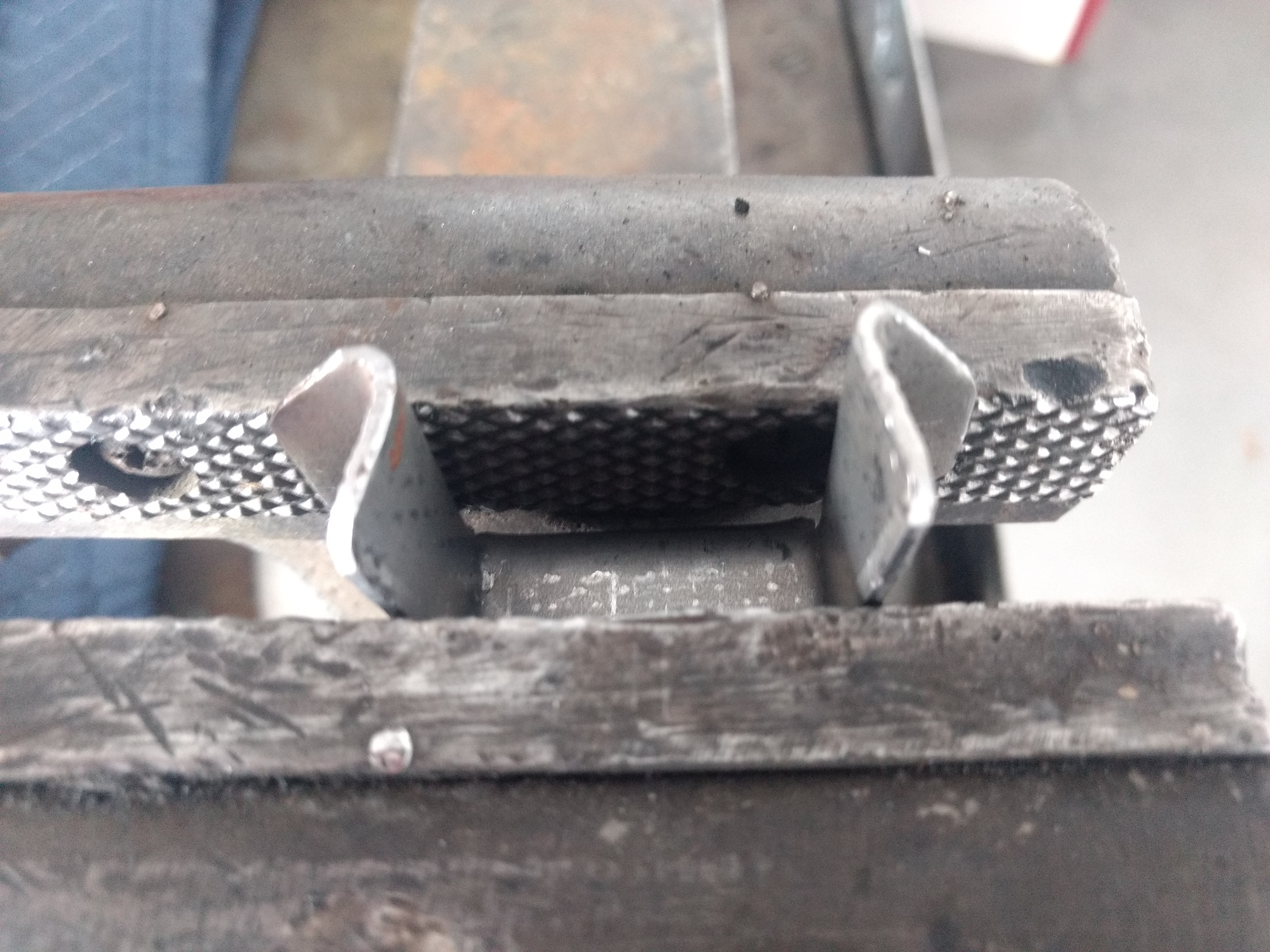

Made this little seat hoop at lunch on the Model 3 and shop press, came out great!
