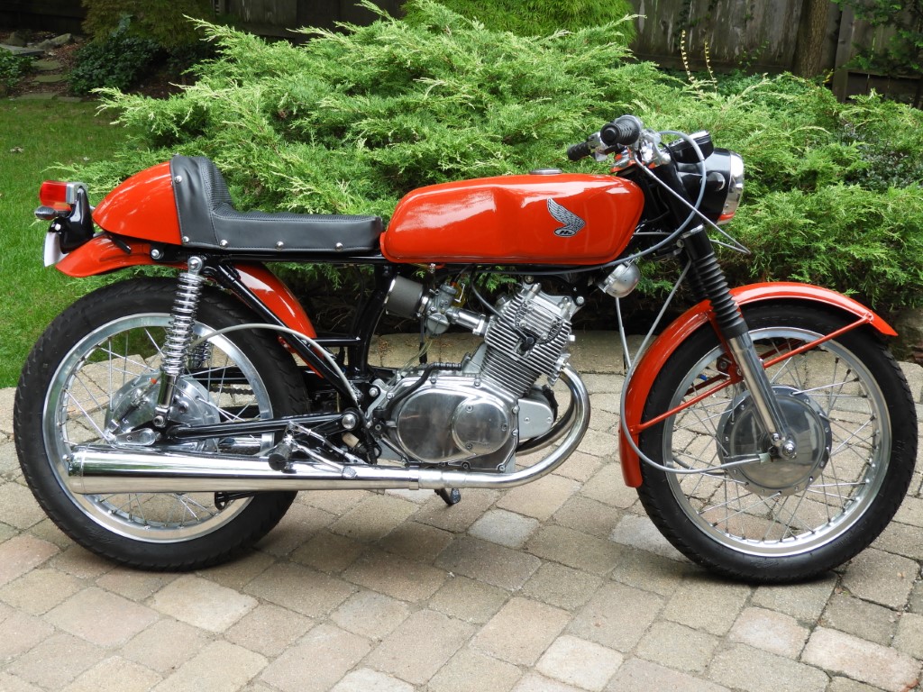

Another option would be to add a bend and upsweep them. It may look great. I have those pipes on my GL and upswept them and I think they look great that way.
Thanks for the muffler input everyone, and great looking GL Maritime.
I ordered a 2nd swingarm yesterday so I can stretch mine 2" with the help of a professional welder buddy . I think the whole bike will look better a longer wheelbase and a byproduct will be making the exhaust look a little shorter.

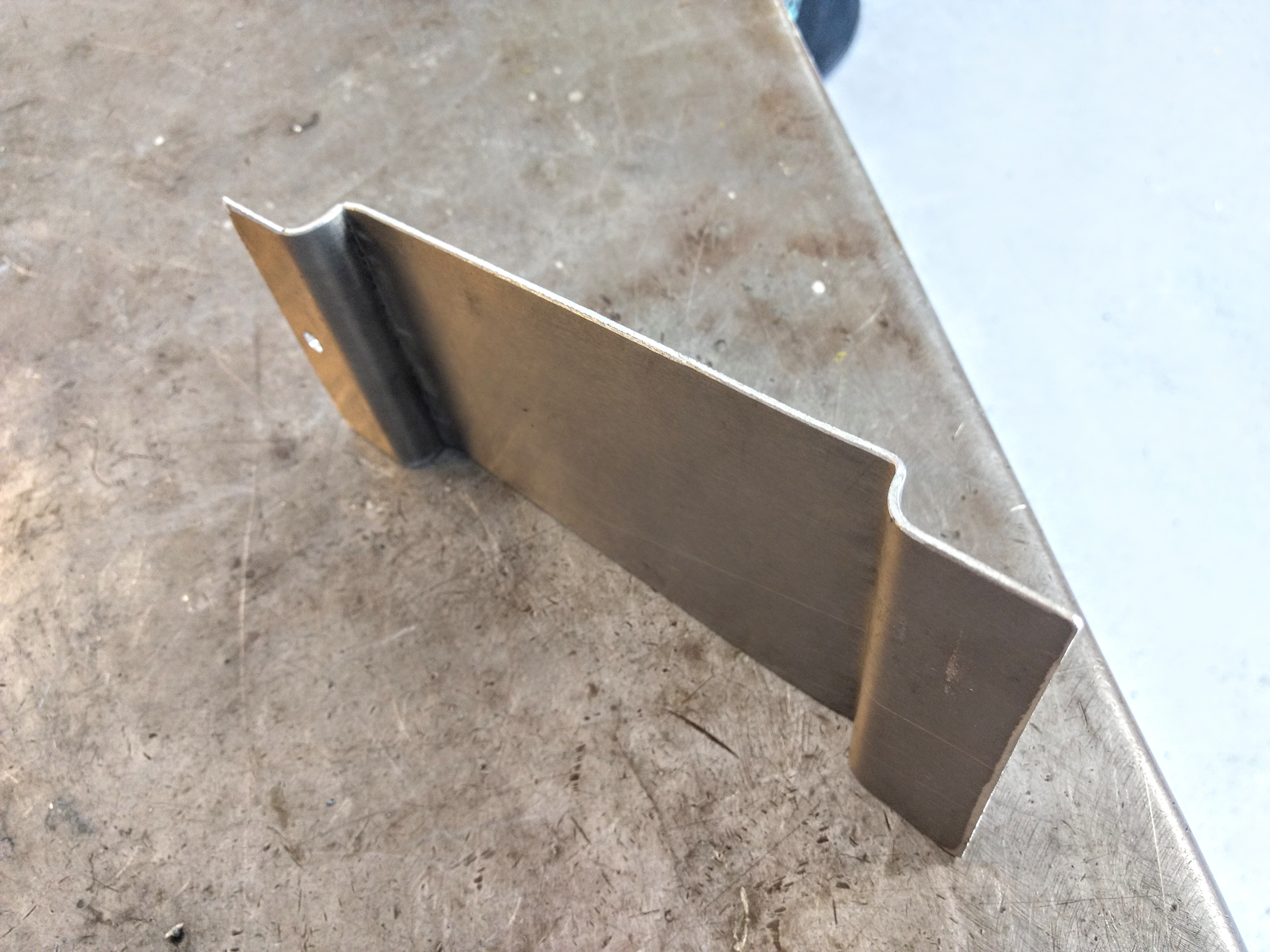

Worked up a plate to mount electronics to and it will mount under the seat between the frame rails.
Also working on brackets to relocate the coil to the Twinstar's downtube today.
