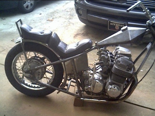

This is a great project. You have a nice selection of "back in the day" quality products. I've built several Hondas on AMEN frames and never had a problem. In 1971 a wrecked 550 was dropped off at our shop. The owner wanted it built into a chopper while he was recovering from the wreck. We used an AMEN frame with the HD 1" neck and a 6" over Ness narrow springer. It was nice and light, and handled very well. I think you will enjoy it when you are finished.

So here is the bike in it's current state.
Engine is still blown up, out and apart.
The big question at this point is what to actually do with the bike.
Personally I am starting to think that the "patina" has crossed the line into "ugly".
Exploring options of re-doing the chrome and having the tins painted.
Would love some input.
Sometimes clearing things out makes room for new expansion. On the frame, I dunno. Seems maybe ugly is the new popular color.
are those rockers on the front end original or assembled correctly they look like they would not pivot correctly
as the bike moved forward and hit a bump it would not cause the springs to compress much
i am asking about the first picture of your cb500 i just saw this its on page 1
The front end has caused a few people to question.
I admit I am no expert.
Seems that the front end lower rockers are correct.
I have an issue with the way the brake stay mount is connected.
It should be parallel to the rockers, and it is not.
In many of the pictures the front end is completely unloaded, so that makes it look funny too.
