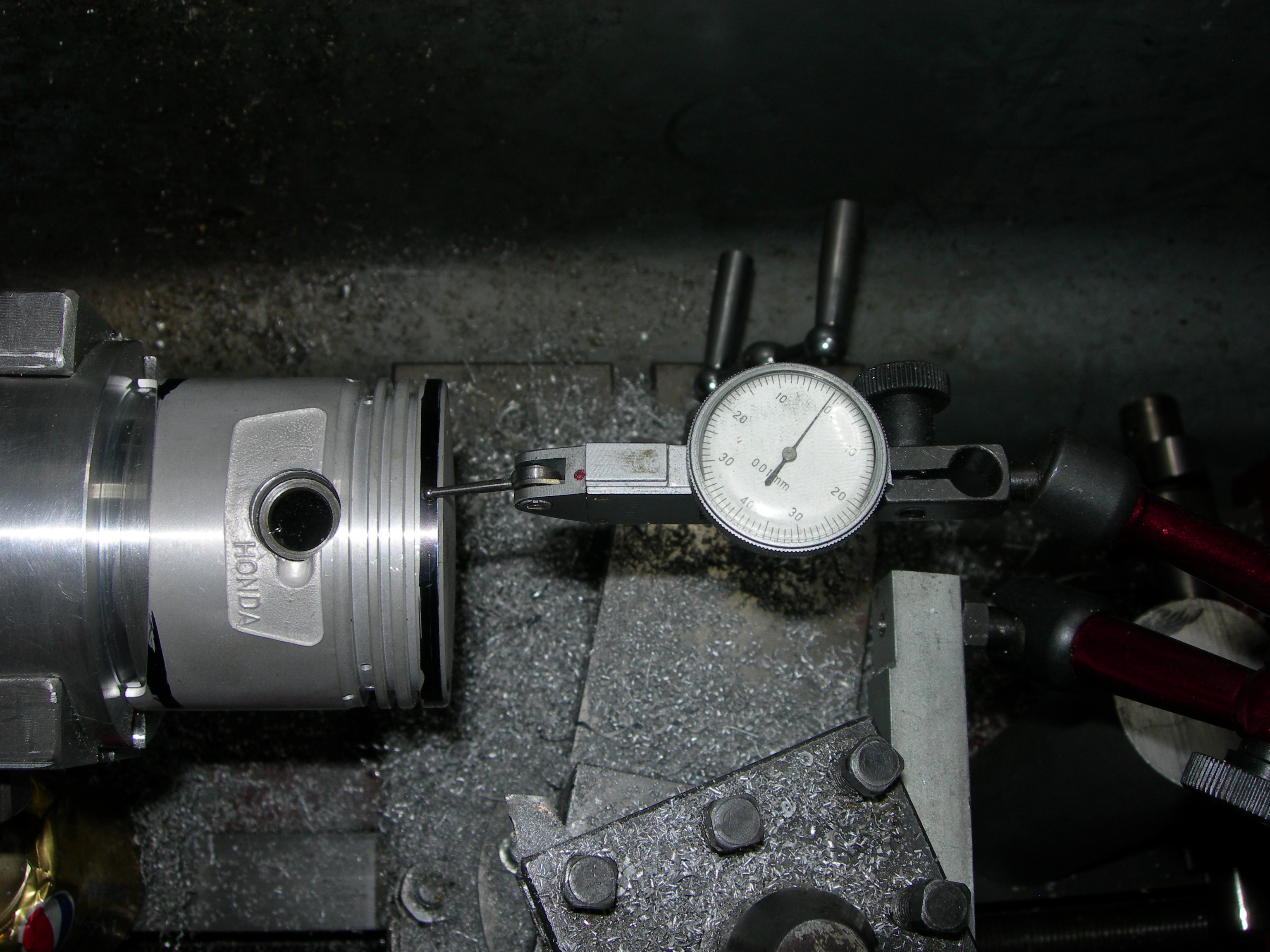

If those are the pistons I did they are not to 'Gentleman's Express' spec.
I changed various angles and diameters to get higher compression plus modified skirts and weights to change oiling characteristics. They should allow short bursts to 13.5k with stock rods. You'll need a different ignition to stock for that though, points only allow about 11.5k. I have no idea what rpm magneto will allow ?Oh, those springer forks are designed for heavily raked front ends, the lower rocker should be almost parallel with ground when fitted (maybe 10 degrees off?)
